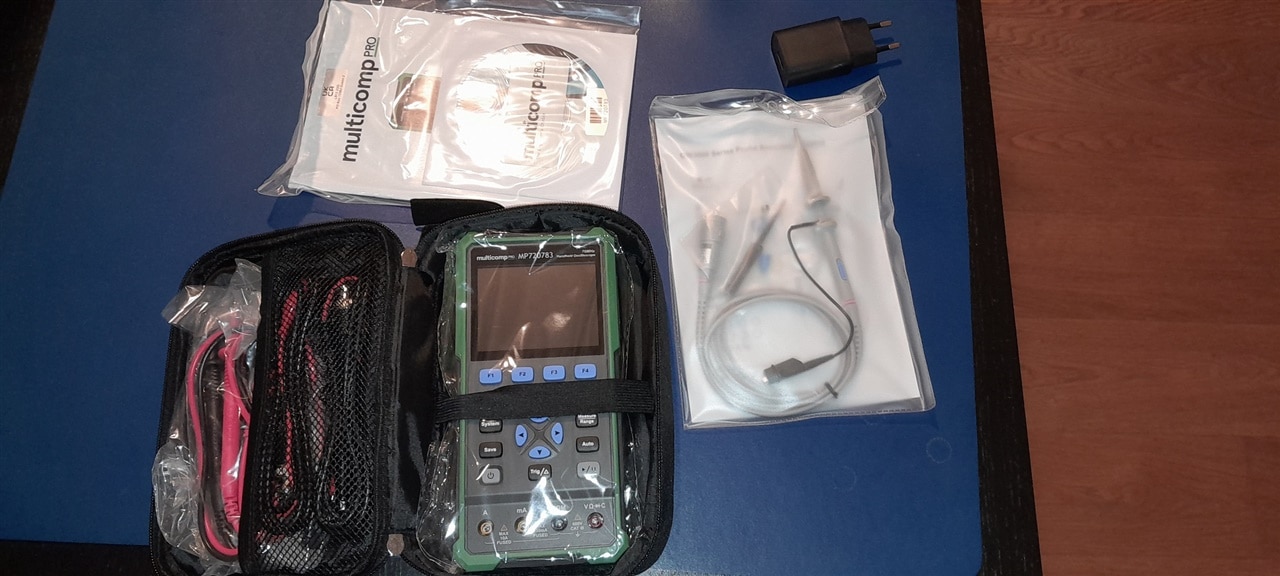

    Jan Cumps over 3 years ago in reply to scottiebabe
    My scope arrived!
