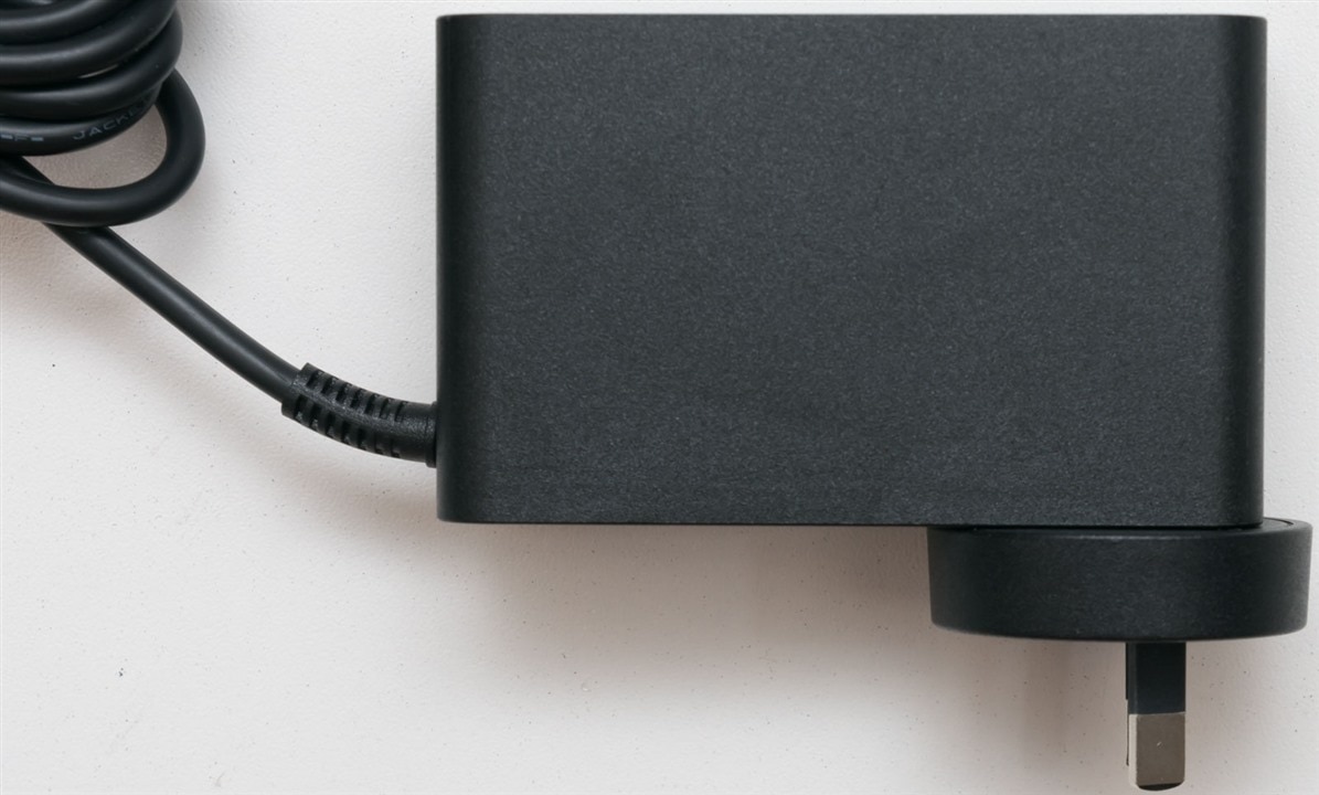

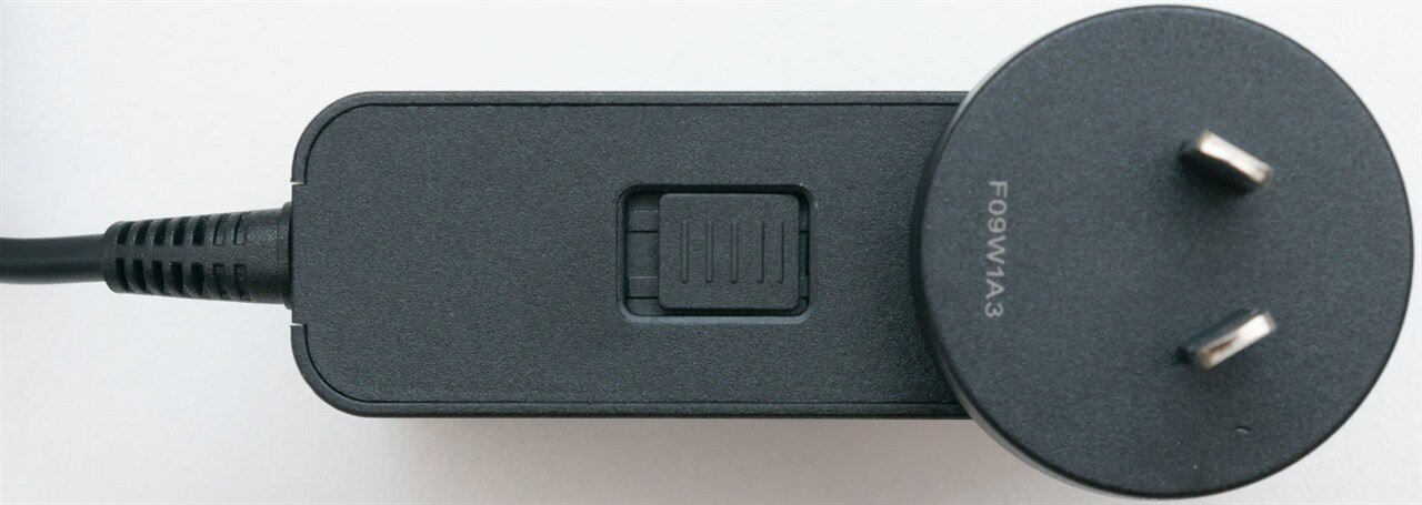

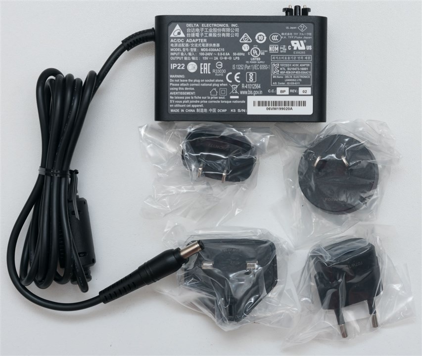

Inside the cardboard box is a 15V 2A (30W) power supply from Delta with adapters for worldwide usage. I definitely appreciate this, as being in Australia, this means I don’t have to use dubious plug adapters.
image image
The supply is a bit on the chunky side, seemingly suitable for a netbook perhaps and is terminated in a 2.1mm inner-diameter barrel plug. Nothing too out-of-the-ordinary.

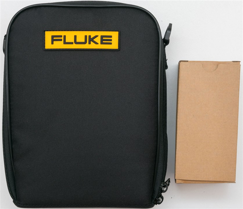

Inside the Case

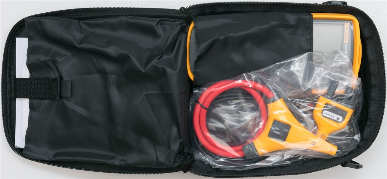

The inside of the carrying case is packed full of goodies, protected with plastic film or plastic bags.
There is a copious amount of paperwork and a CD-R containing “software licensing support materials”, which include open-source licenses as well as the sources for the packages they used. I don’t think it’s the full bundle required to roll-your-own firmware, but even if it were, I probably am not skilled enough to set up an appropriate build environment.
Aside from this, there is the iFlex current probe, the shoulder strap for the carry bag, a hanging clip and strap, a pair of TL175 TwistGuard test leads and AC175 alligator clips, and the DMM itself.
The case overall has relatively thin padding, with only nylon fabric pockets for the DMM and side compartment I feel that this is not quite up-to-scratch, especially as the dividers aren’t exactly a good fit for the included accessories.

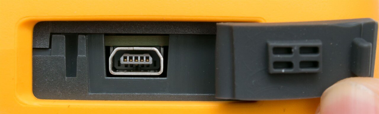

The side of the unit has a USB socket for connection to a computer, protected behind a rubber flap.

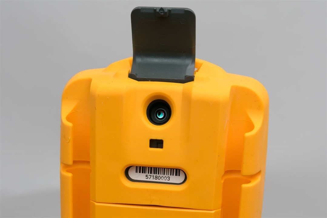

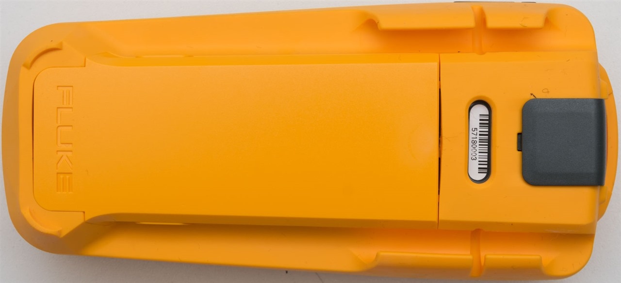

The kickstand is integrated into the body on the rear and the thermal imager resides behind a protective grey plastic flap.
The imager itself is angled upwards slightly, to make for a more ergonomic experience when holding the meter and scanning a switchboard, for example. There is only a single lens, as there is no image fusion, auxiliary spot thermometer or laser pointer guidance.

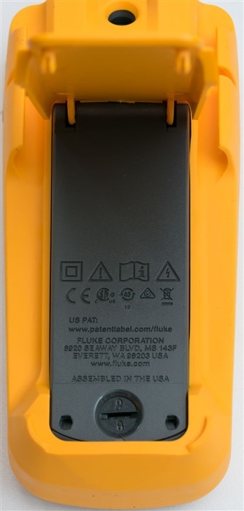

Battery access is underneath the kick-stand.

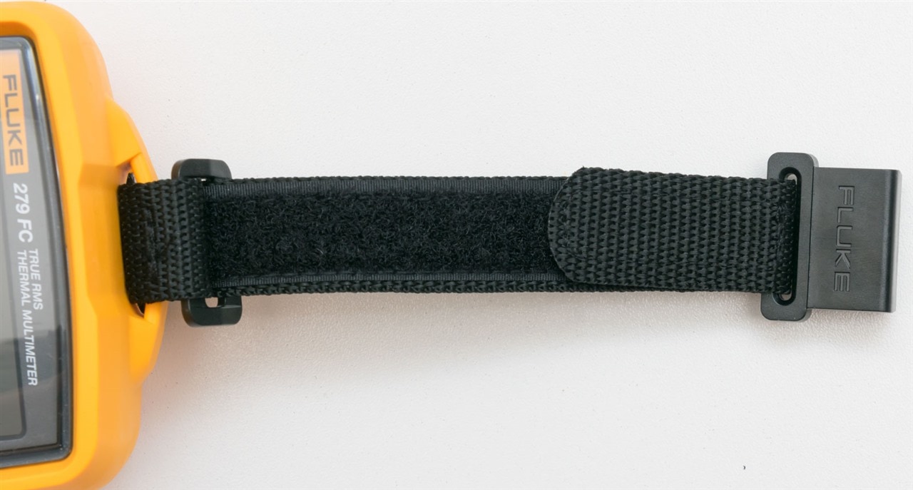

There is a supplied strap and hook which can be attached to the eyelet at the top of the meter, allowing the meter to hang off a door or panel. It is a shame that this is only the plastic hook and not the strong magnet type which Fluke also sells as that might be even more useful.

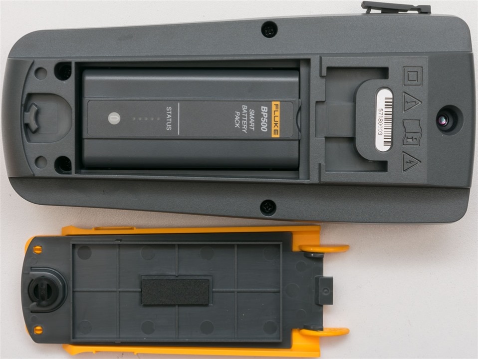

The Battery

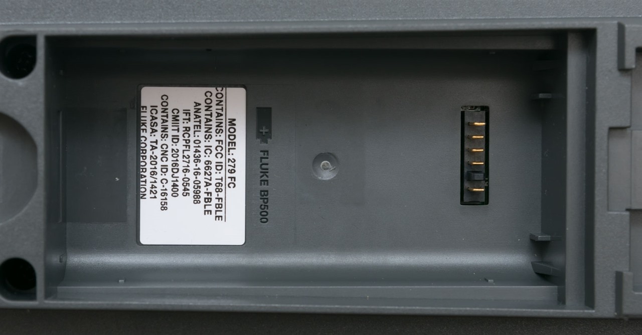

Once the latch underneath the kick-stand is unlocked with a flat-bladed screwdriver or coin, the whole assembly comes out to reveal the battery underneath. There is no need to remove the protective yellow rubber holster – although I did so to see if there were any surprises to be uncovered.

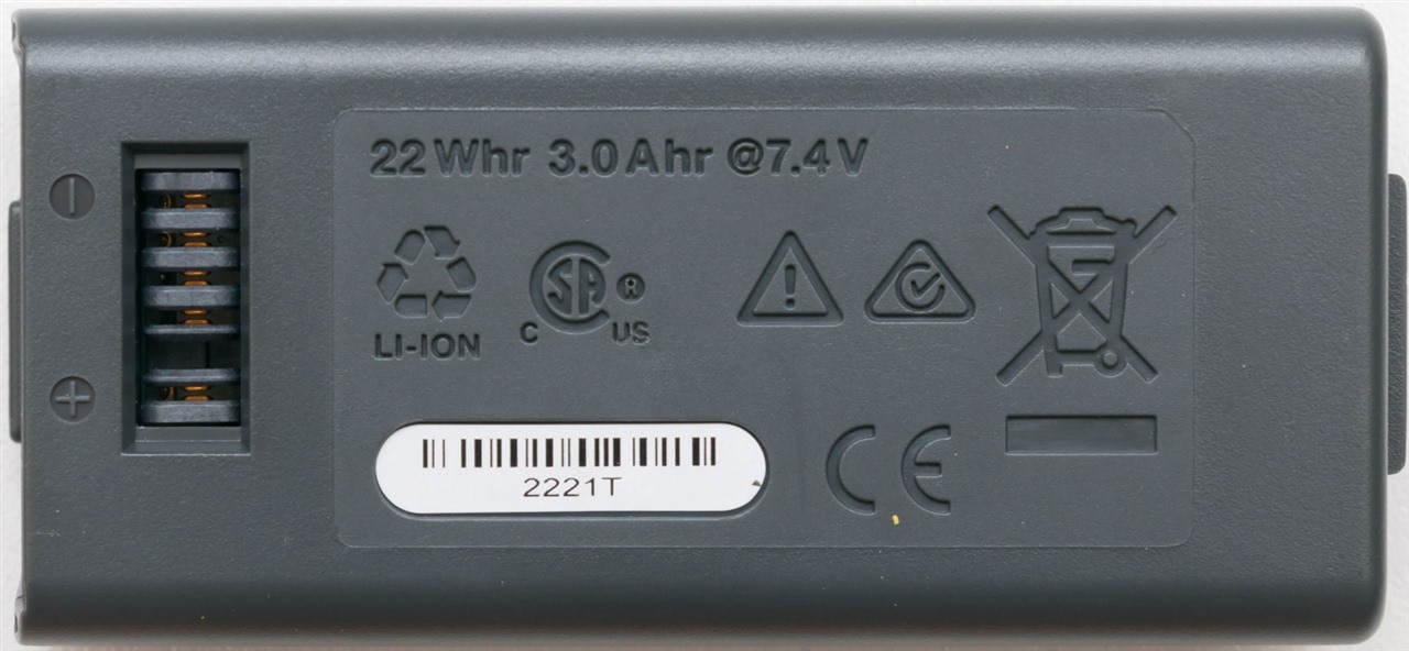

The battery is a Fluke BP500 Smart Battery Pack which has an LED battery status indicator which can be activated by pressing the button. This reminds me of older laptop battery packs that had a similar feature.
The battery lifts out of the bay, where vertical blade contacts are visible. There is also the approval numbers for the wireless communication module within the unit.
The battery is rated 22Wh with a 3Ah capacity at 7.4V. The chemistry is Li-Ion. Given the number of contacts, this is indeed a smart battery with internal fuel gauge communicating with the DMM for more accurate battery life estimations. It’s nice to see the approvals moulded into the casing include the Australian Regulatory Compliance Mark (RCM).

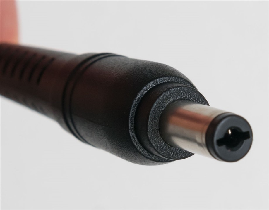

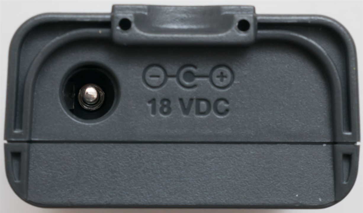

Not only that, the battery itself has a barrel socket at the top for charging the battery directly. On the upside, this means not needing a dedicated charging dock or station as some other tools need and they can be easily charged aside from the unit. The downside is the mild inconvenience it is to open up the back to extract the battery every time it needs to be charged.
A key inconsistency is the fact that the battery claims to want 18V DC but the power supply provided is a 15V DC power supply. I suspect this may just be a supply issue, but being a 7.4V battery (two-series 18650 cells at a guess), it seems that possibly even 8.4V to 9V would be enough ordinarily, however, with the buck converter inside, perhaps it would be happier with around 12V.

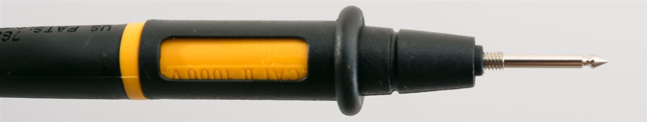

The TL175 TwistGuard Test Leads and AC175 Alligator Clips

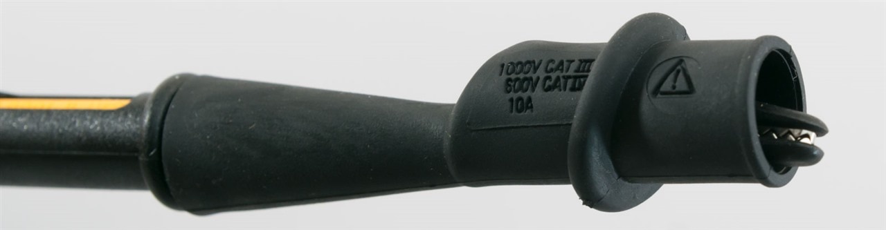

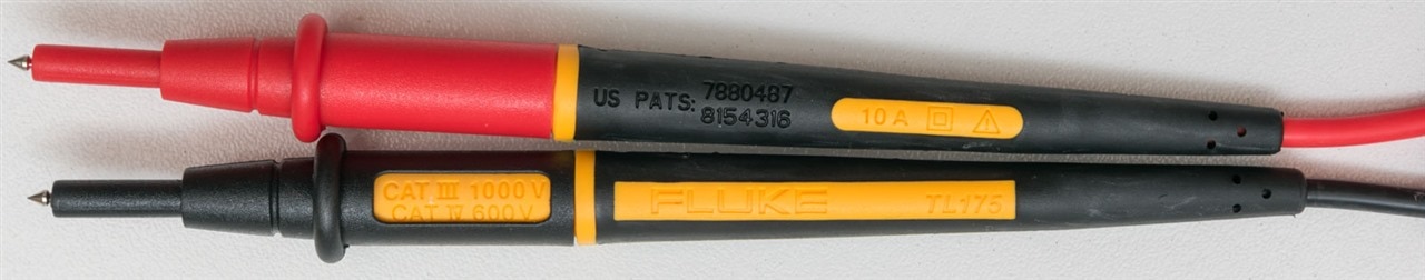

The unit was supplied with the TL175 probes which were a nice treat to hold –
I really liked the flexibility of the leads and the rubber texture was nice for grip without being sticky (at least, initially). I wonder how well they will age, given some people have complained of the leads internally breaking, but they definitely flex better than any test lead I already have in the house.

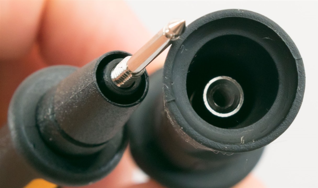

Their main claim-to-fame is the TwistGuard which allows for just a twist to retract the shield around the test probe. This makes it easy to swap between the less-guarded, more convenient exposed probe situation for working at CAT I/II situations, and the protected probes for CAT III/IV. The downside is that it is possible for a user to deliberately circumvent the protection, which maybe why the Keysight U1461A Insulation Resistance Testing DMM kit contained two sets of probes instead.
image image
The alligator clips are also much nicer than any other I have – these screw onto the tips of the probe so they cannot fall off, and have their jaws insulated from the outside too. I guess that’s just as well as they claim to be CAT III 1000V and CAT IV 600V 10A rated.

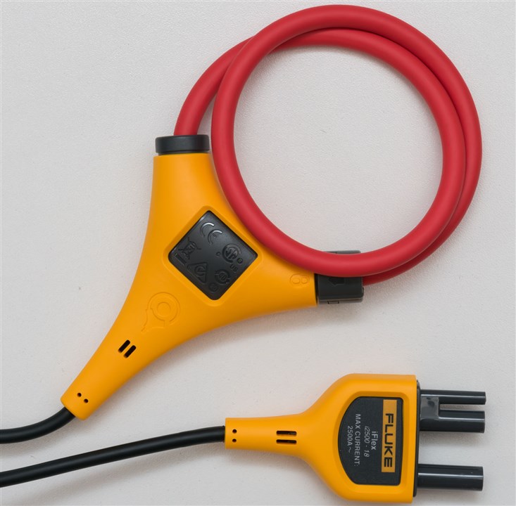

The iFlex Current Probe

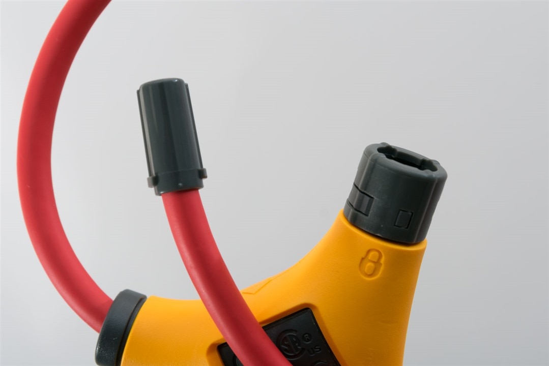

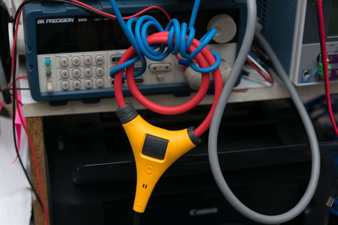

The final item of note is the iFlex current probe which is a flexible current transformer.
The unit plugs right into the front and offers a loop that can be wrapped around wires coming in/out of a board to measure currents up to 2500A.
The loop itself can be opened up with a simple twist of the locking collar. The whole thing is well insulated, to ensure safety when working with high voltages.

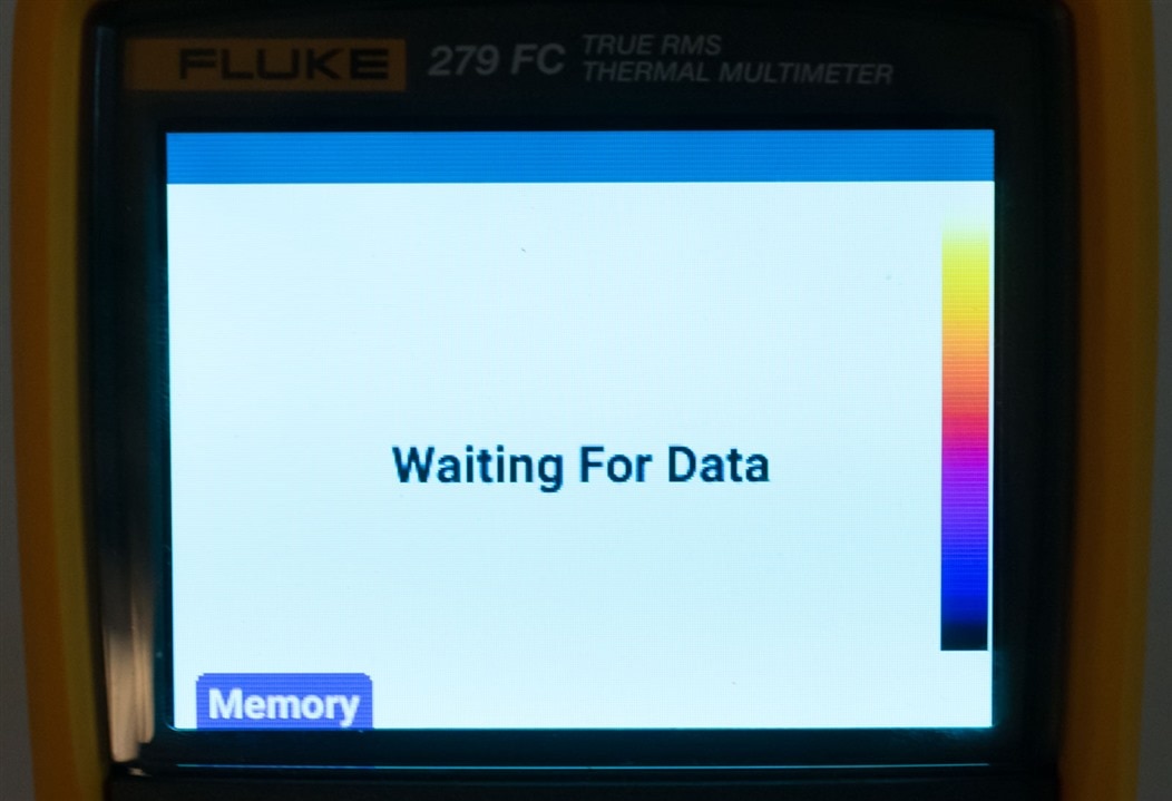

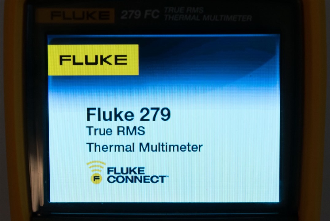

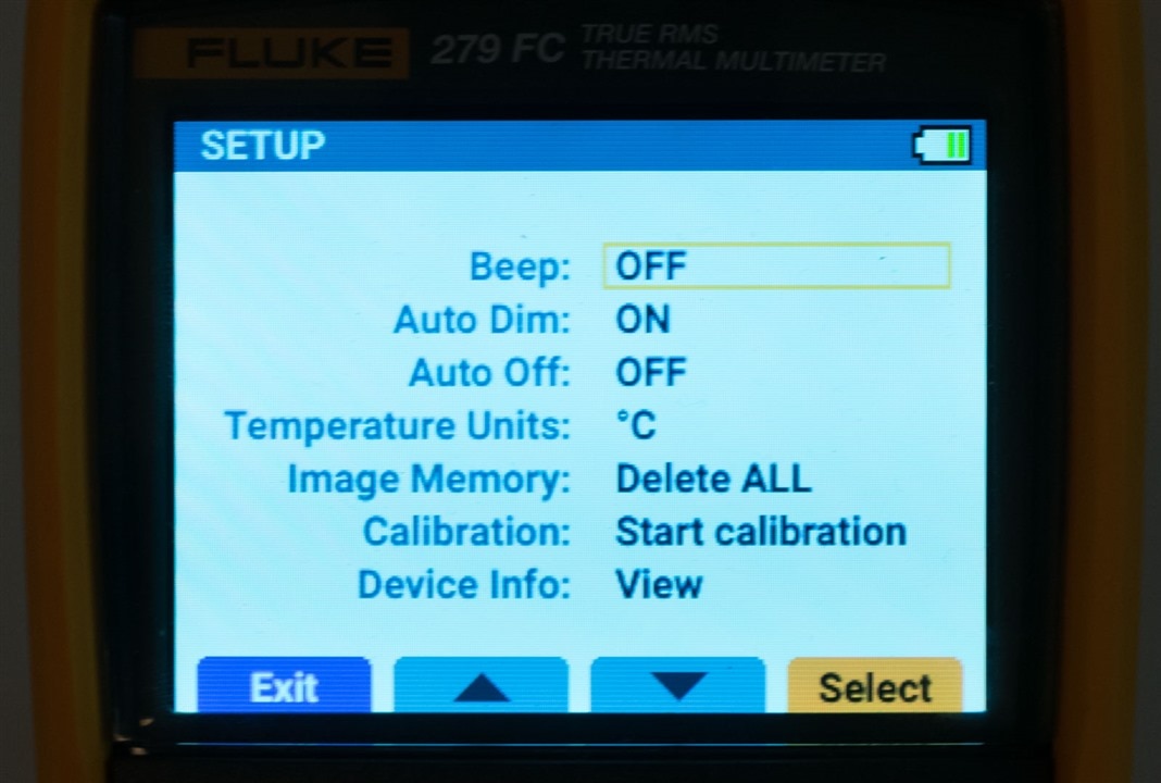

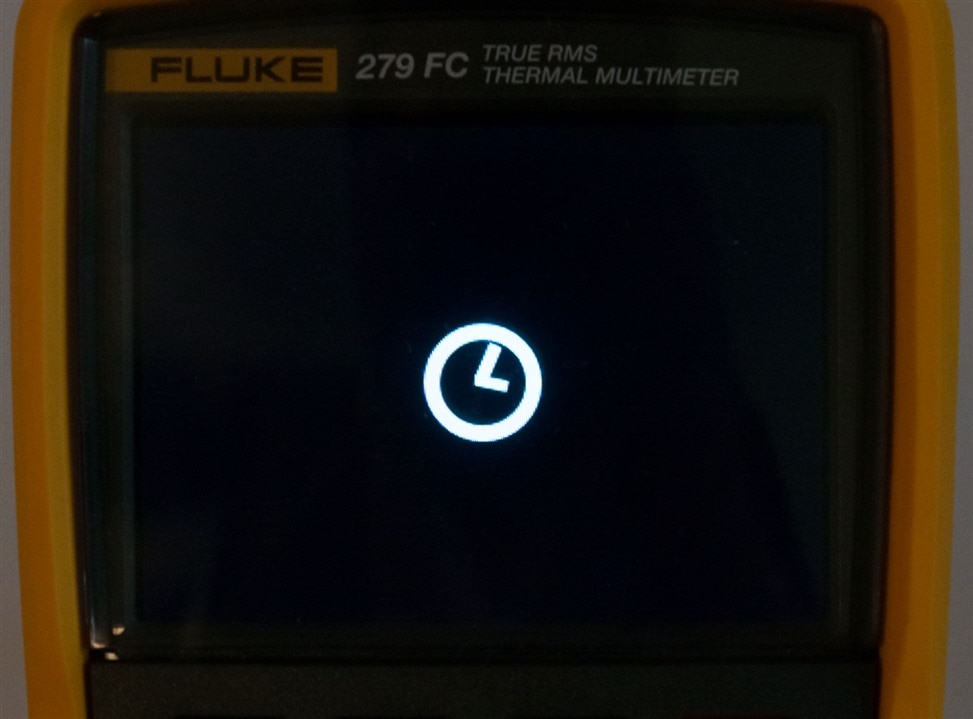

This DMM is unlike any other I’ve used, in more ways than one. For one, you have to wait for it to boot up.
image image
These screens show regardless of the selected function. If you’re looking for thermal imaging, then you’re going to have to wait another second or two as the module wakes up and takes its shutter dark frame subtraction.
I guess this is the downside to complexity – it’s running a whole OS of sorts in there.
image image

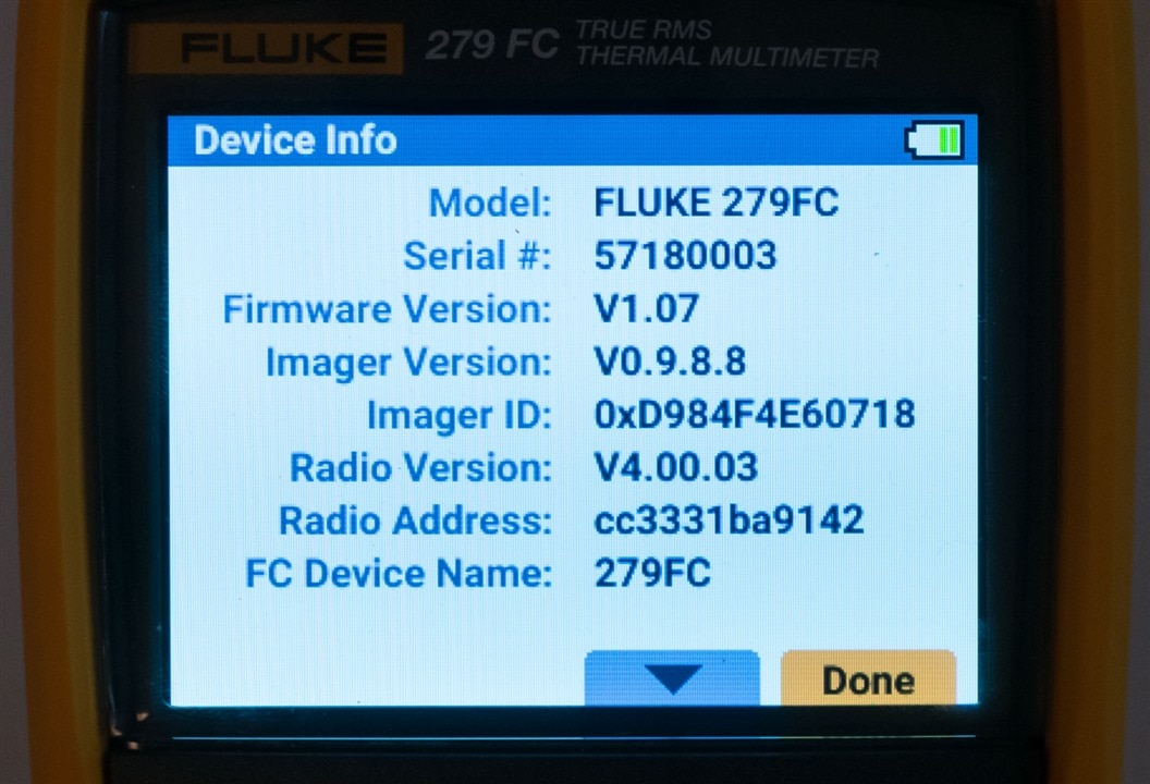

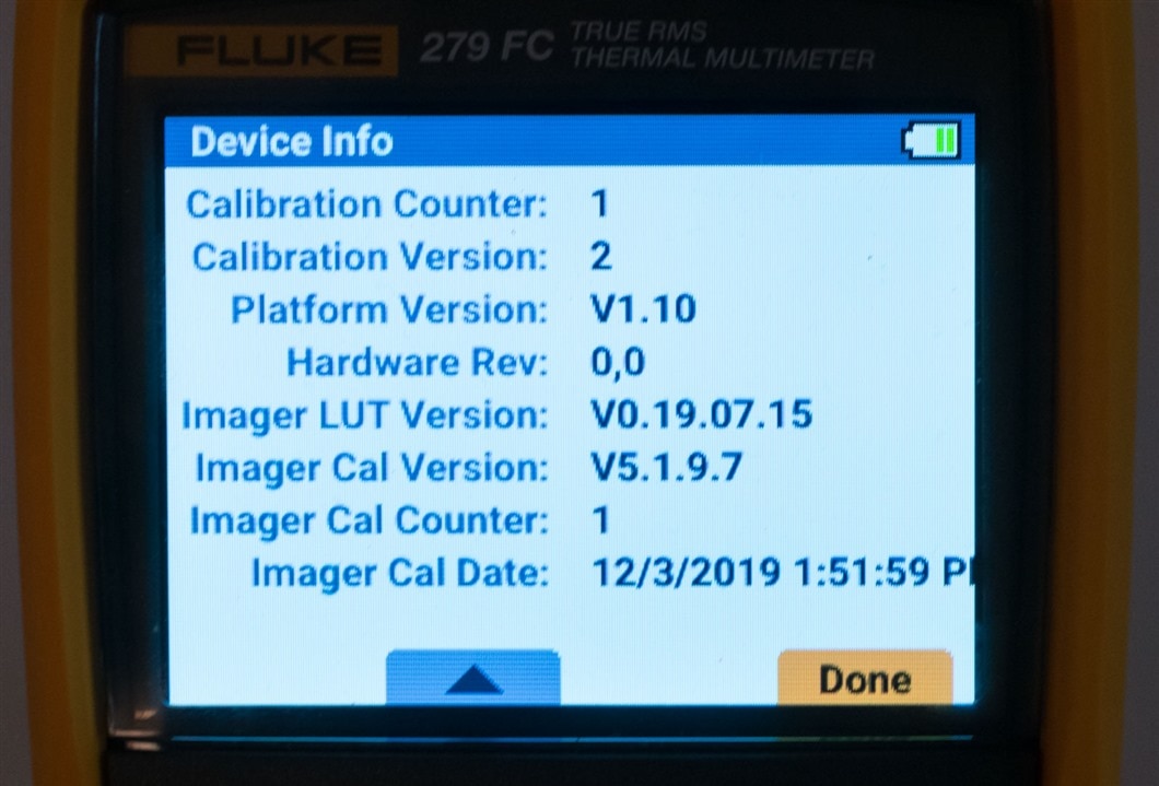

The unit had Firmware 1.07 installed, which appears to be later than any download available online. The thermal imager seems to have been calibrated on 3rd December 2019 (assuming American date) which seems to be quite a while back compared to the manufacturing date.
A quirk of the unit that I dislike is its propensity to turn on automatically when the battery is inserted after charging. The fact the power on button is a button and not a selection on the rotary dial also means there is a potential for the meter to be accidentally powered-up in transit which could mean a dead meter by the time you realise it. At least you can recharge the battery, I suppose.
It is a “beepy” meter by default, but one can change the settings to turn that off. I also turned off the automatic power off which could help with the above situation as it can get annoying when in thermal imaging. The auto-dim function was left on – it basically allows you to select high LCD brightness (out of normal or high) and then it will automatically step back to normal after a while.

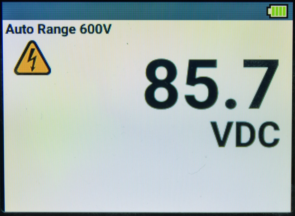

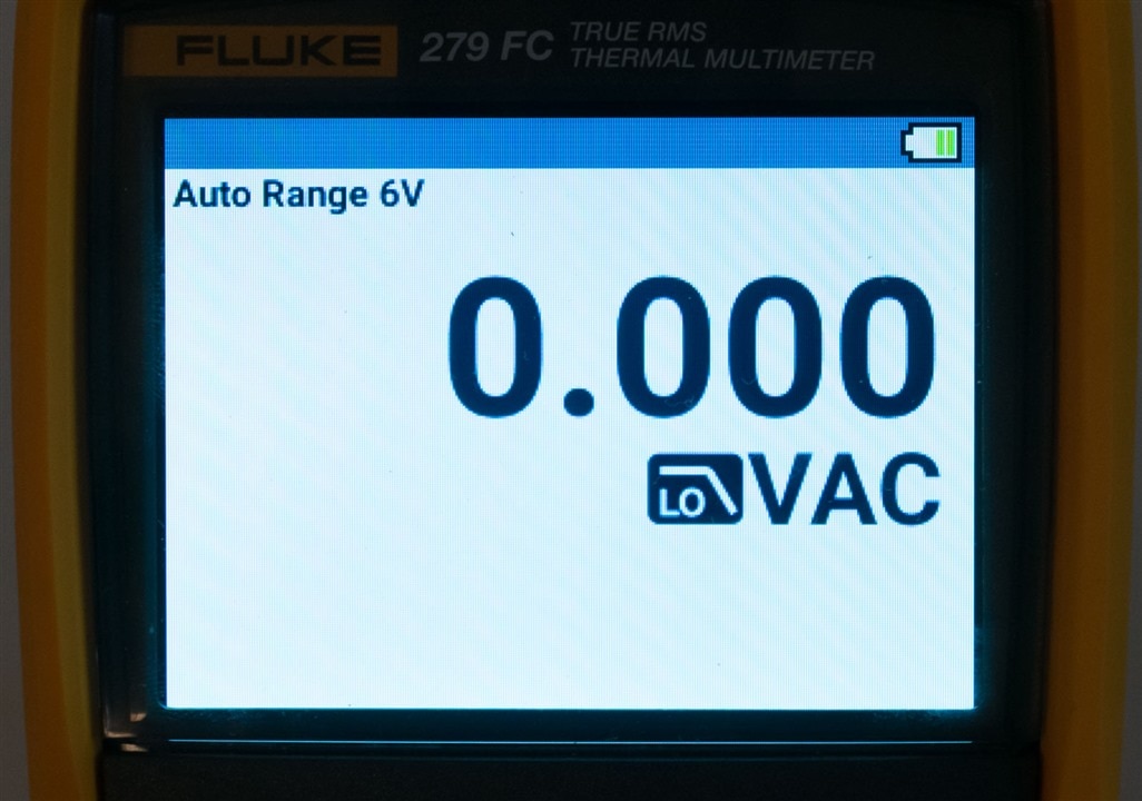

The DMM functions all display moderately large black text on a white background for maximum contrast. Unfortunately, aside from this and iconography that indicates high voltage, there is nothing in the way of graphics or colour which take advantage of the LCD’s capabilities. Some people will be really unhappy with the lack of a bar graph display, for example.
One thing that seems good is that the auto-ranging speed is quite quick. Testing on DC, it was hopping around four ranges per second, matching the sustained reading update rate of 4Hz.

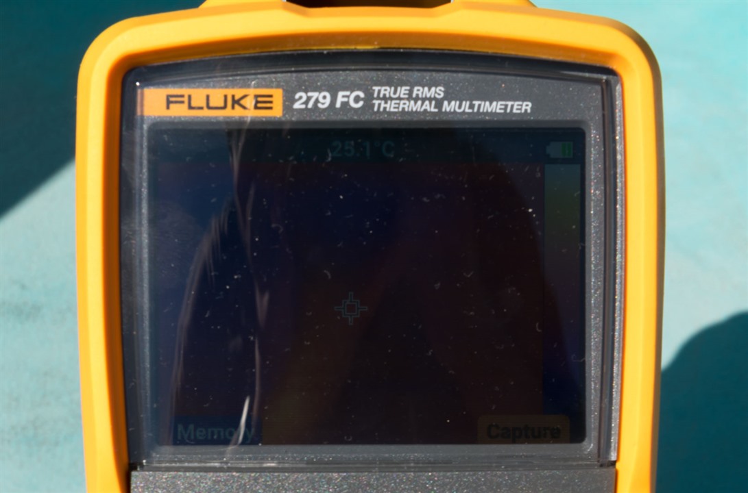

Testing the display in full sun, the DMM mode text is readable although with diminished contrast, while thermal images were very difficult to see.

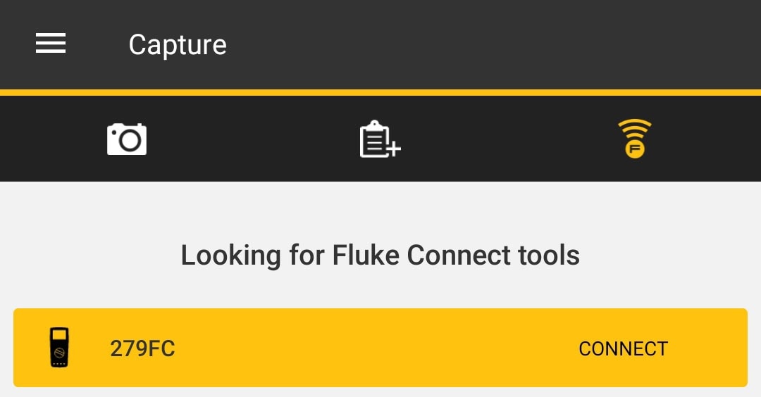

Fluke Connect (Mobile, Bluetooth-Connected)

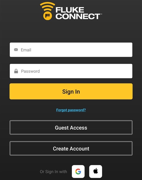

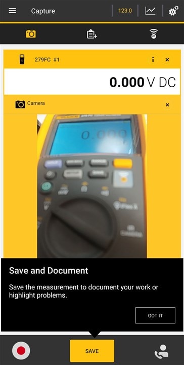

There is a Fluke Connect app for mobile that allows you to work with the 279 FC/iFlex over a Bluetooth connection. This app is available free on your app store of choice – I tested the Android app downloaded from Google Play.
Opening the app, you are given a quick three-screen introduction to the app and permissions are requested for the purposes of storing files and connecting to devices. Then you are implored to login or create an account, or use Guest Access. I initially tried the app using the latter, but it seems they’ve forcibly made it such that you need to go with an account to get some important basic features.
image image

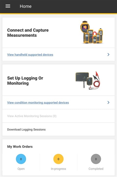

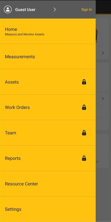

The home screen is a bit like an ad for their products and it takes navigating to the side bar to see the other pages. The locked pages are not available to guest users.
image image

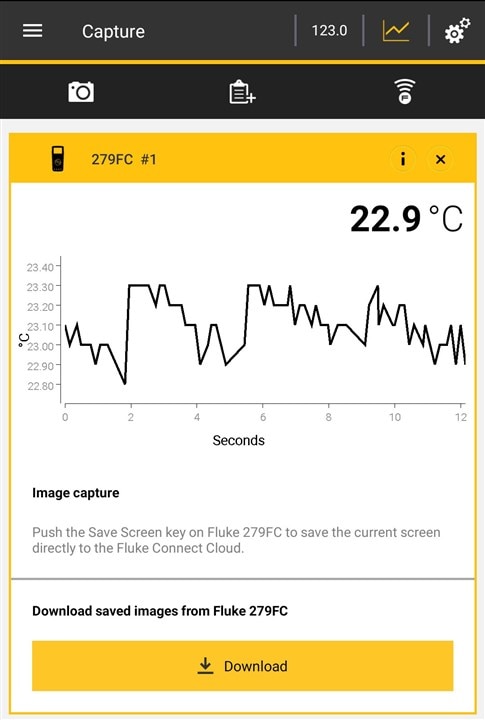

The Measurements page is where the important things happen, allowing you to connect to devices and capture readings along with photos. The interface is very-much job oriented, helping you compile a report for a given job. This is not so ideal for other users, but the account allows such information to be automatically synchronised to their cloud storage.
image image
When in the thermal image mode, one can either have the temperature of the central spot being measured and graphed or they can choose to download images from the camera’s memory. No live view is available, unfortunately.
image image
Thermal images can be recoloured in the app and the resulting images can be shared from the app, with a choice of formats. However …
image image

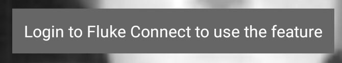

… if you’re in Guest Access, then you’ll find your downloaded files can only be viewed, not shared. If you then choose to sign-up for an account, you are told that the data will be merged but it didn’t seem to work properly in my case, causing data to be lost. What did work was their example jobs being pulled down, creating clutter in my Fluke Connect app.
image image
Above are examples of the .JPG and .PDF export types. Overall, while the app does work, I find it a little clunky and the push to sign-up for a Fluke Connect account just seems unnecessary if it were not for an artificial restriction on sharing files from the app without an account.

So, I thought, given the Fluke Connect branding and the fact that SmartView seems to be deprecated, I would try the latest software.
Signing into the account I was practically forced to make as part of using the mobile app …
… I am greeted to the software not detecting the 279 FC/iFlex at all, regardless of driver. This is a very poor outcome – it seems the SmartView Classic V4.4 will have to be the software of choice until someone reverse-engineers the communication protocol. It’s just not the experience I expect from a leading name in the in-field test and measurement industry.

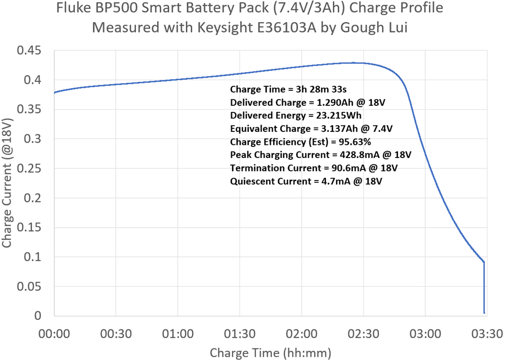

Given that this meter uses an LCD and has a thermal imaging sensor, the runtime is of key interest. The manufacturer claims the battery to last for 10 hours minimum, with a charge taking 4.5 hours. Using the meter in thermal imaging mode, at the normal brightness, I achieved 13 hours and 35 minutes from a fully charged battery. That exceeds the claimed lifetime and isn’t entirely bad, especially if using it for spot-checks rather than constantly.
Recharging was tested with the original charger and the Tektronix PA1000 Power Analyzer recording power input to the power supply unit.
Charging was achieved in just under 3.5 hours, delivering 27.368Wh for an estimated charge efficiency of 81.1% end-to-end, or about 84.8% from AC to DC for the power supply. The peak AC power was just 9.029W with a quiescent power of 0.341W. This suggests that the power supply is very oversized and doesn’t need to be that big – this seems to be because of their design decision to reuse parts from their 500-series Battery Analyzer which uses the same battery and charger, but allows the charger to charge the analyser while the battery is within the unit. I suppose that arrangement wasn’t carried forward to this unit for safety reasons, but it seems the power requirements could even be fulfilled by a 5V/2A USB power supply.
I decided to repeat the test in DC by using the Keysight E36103A Power Supply as a stand-in for the supplied power adapter. This time, charging was achieved within nearly an identical amount of time, with the delivered energy being 23.215Wh suggesting an estimated charging efficiency of 95.63% (based on nominal cell capacity). Peak charging current was 428.8mA at 18V with a termination current of 90.6mA at 18V and a quiescent current of 4.7mA at 18V.
Based on these results, I may opt to build a USB to 15V cable with one of the standard boost converter modules for more convenient and compact charging of the battery, although that may not need to happen as often as one thinks when the meter is not being operated continuously. A USB-C PD trigger could be set to get 15V from most USB-C PD ports which would mean no conversions at all.

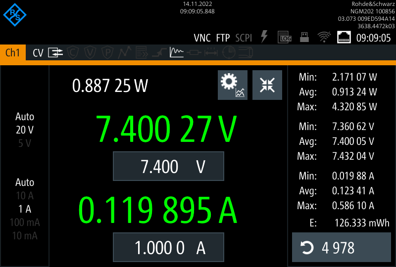

Without a Battery? (and Current Consumption)

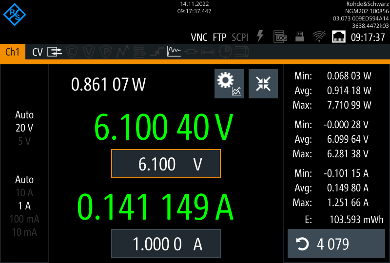

One thing I’m really worried about is the BP500 Smart Battery Pack. A quick glance at the unboxing showed it basically has an onboard charger and battery management, similar in complexity to a laptop battery. Replacements are only available from Fluke, with no aftermarket replacements, and the reviews seem to indicate the battery may also fail unexpectedly after just a few cycles. I certainly don’t fancy having to pony up AU$302.50 for a new battery – some DMMs cost less than that.
I decided to clip some alligator clips to the terminals in the battery bay and find out what happens if I just supply power without any of the “smarts” using a Rohde & Schwarz NGM202.
As it turns out – it seems to work just fine, but with the battery indicator always showing red (empty). At the nominal 7.4V, in thermal imaging mode, the current consumption averages 187.14mA and peaks at 655.98mA.
In the DMM mode, the current consumption averages 123.41mA and peaks at 586.10mA.
Low-battery shutdown occurs when the input voltage hits 6.0V regardless. At 6.1V, current consumption has increased in DMM mode to 149.80mA with a peak of 1251.66mA, suggesting that there is an internal switch-mode converter that generates the operating voltages.
As a result, it seems that the meter doesn’t stop you from hacking in your own power supply, if you wish.

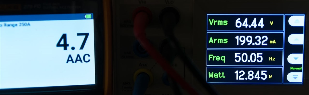

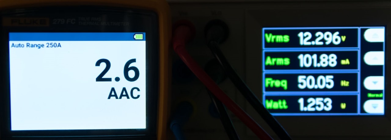

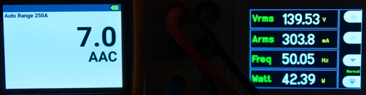

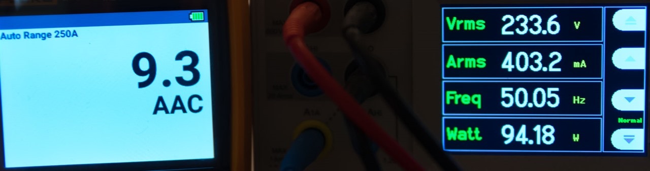

iFlex Probe
The iFlex probe is a pretty fancy flexible current transformer which can be used to safely measure AC current without interrupting the conductors.
Note: the below image depicts usage of the iFlex probe in a manner contrary to manufacturer recommendations. Danger - do not attempt to replicate. Scene conducted by professional test equipment reviewer in controlled test environment.
If I said the probe had a large aperture, that might mean something different to each reader. But if I show you visually, then you might get a better idea – yes, I can fit my entire neck inside the aperture with room to spare. It almost looks like a leash or a noose … hmm, am I’m a slave to Fluke now?
It’s big both in size, but also in current range, measuring up to 2500A (or about as much current as a pad-mount substation may see) at a resolution of 0.1A. The accuracy is 3% ± 5 digits, with additional error up to 2% due to non-optimal positioning. While this doesn’t sound impressive, inductive measurements usually are not highly accurate and the flexible nature of this current transformer does result in some trade-offs.
As I don’t work in such power distribution industries, the best I could do was to use an incandescent light bulb as a load and a Variac to create a controllable AC current. To mimic higher current levels, I wrapped the current wire from my Tektronix PA1000 Power Analyzer breakout around the iFlex 10 times, and threaded the iFlex itself through this twice, leading to a 20x multiplication factor.
With no load, I did see the Fluke report up to about 0.5A which is within the claimed specification.
At 100mA, the expected reading would be 2A. The Fluke reported 2.6A which is within specification.
At 200mA, the expected reading would be 4A. The Fluke reported 4.7A, which is again, within specification.
At 300mA, the expected reading would be 6A. The Fluke reported 7A, which is a little high, but consider the sub-optimal geometry of this arrangement and adding the additional penalty, it seems reasonable.
At 400mA, the expected reading would be 8A. The Fluke reported 9.3A, so it seems the error gets bigger with magnitude (gain error) in addition to a bit of offset. This is not unexpected, considering we are still measuring very small values compared to its 2500A current rating (0.4% of full scale).
