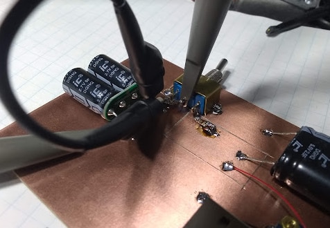

Here is the test apparatus:
The 2 DUT capacitors share a common ground and a toggle switch allows for the positive terminals be isolated or shorted together.

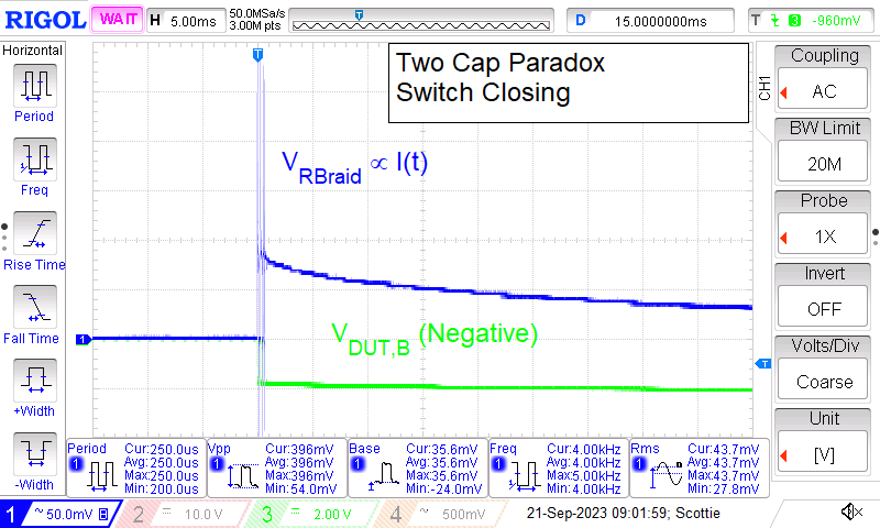

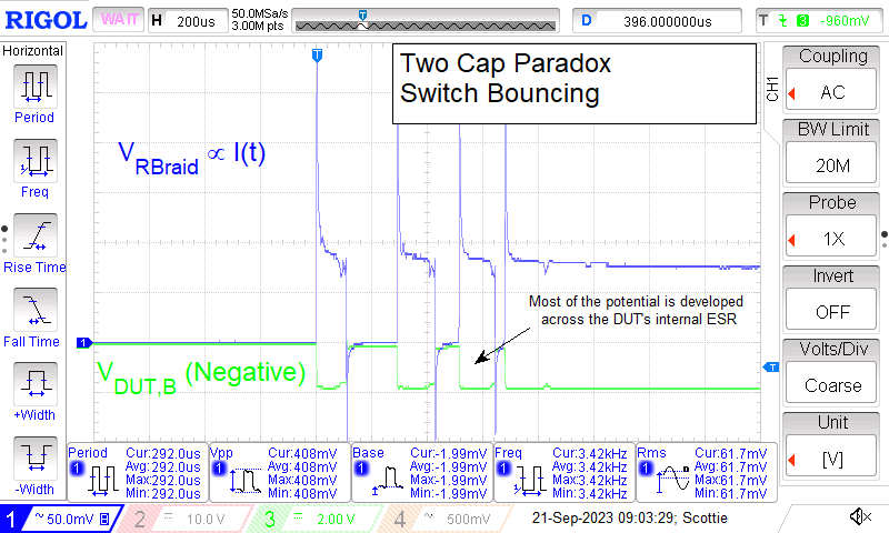

Finally the big moment! I charged DUT-A to 5 V and discharged DUT-B to 0 V. Then looking the other direction flipped the toggle switch which placed the 2 DUT capacitors in parallel with a low ohm connection.
No noise, no smoke, no excitement, no welded switch contacts… Somewhat anti-climatic.
I measured the voltage across the now parallel capacitors at 2.881 V. Assuming both capacitors were equal and ideal, the voltage should have declined to 2.5 V (half of the 5 V test stimulus). Capacitor DUT-B likely has a lower effective capacitance compared to that of DUT-A. Testing a second time resulted in final voltage of 2.848 V.
Was the charge of DUT-A conserved? Yes, the measured charge was within the margin of uncertainty of the test setup.
Where’s the energy? The recorded energy of the parallel DUT capacitors is 56% that of the energy that was originally stored in DUT-A prior to being connected to discharged DUT-B.
Where did the energy go!?
Repeating the experiment in the opposite direction, charging DUT-B and connected discharged DUT-A resulted in a final voltage of 2.658 V.

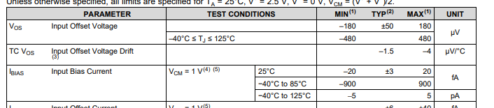

    hmm that would be a challenge. Unrelated when suppliers test the input bias current down to femto-amps they are practically counting electrons on a factory floor. As a result they have to shield their test setup to avoid background radiation (alpha and beta particles)  from goofing their measurements. Like you would see in a cloud chamber...
    https://www.ti.com/lit/ds/symlink/lmp7721.pdf
