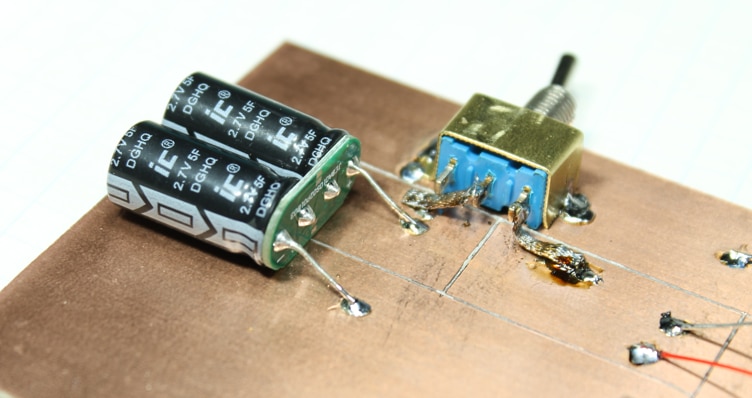

Here is the test apparatus:
The 2 DUT capacitors share a common ground and a toggle switch allows for the positive terminals be isolated or shorted together.

Finally the big moment! I charged DUT-A to 5 V and discharged DUT-B to 0 V. Then looking the other direction flipped the toggle switch which placed the 2 DUT capacitors in parallel with a low ohm connection.
No noise, no smoke, no excitement, no welded switch contacts… Somewhat anti-climatic.
I measured the voltage across the now parallel capacitors at 2.881 V. Assuming both capacitors were equal and ideal, the voltage should have declined to 2.5 V (half of the 5 V test stimulus). Capacitor DUT-B likely has a lower effective capacitance compared to that of DUT-A. Testing a second time resulted in final voltage of 2.848 V.
Was the charge of DUT-A conserved? Yes, the measured charge was within the margin of uncertainty of the test setup.
Where’s the energy? The recorded energy of the parallel DUT capacitors is 56% that of the energy that was originally stored in DUT-A prior to being connected to discharged DUT-B.
Where did the energy go!?
Repeating the experiment in the opposite direction, charging DUT-B and connected discharged DUT-A resulted in a final voltage of 2.658 V.
There is lots that could be improved and the voltage coefficient of capacitance of my EDLCs also played role in leaving a little extra energy in the system.
But, I would say its an easy DIY experiment if you want to have some SuperFun.

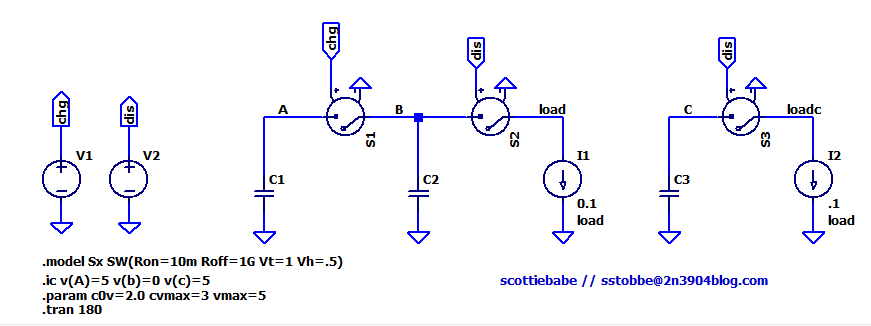

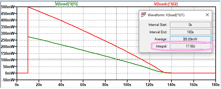

    If you want to try the experiment in spice here is one approach:
    Then compare the energy dissipated in active loads I1 and I2
    E_I1 = 17.98J
    E_I2 = 33.315J
    E_I1/E_I2 = 53.97% ( Note I used capacitors with a voltage coefficient in this example)
    If you use ideal capacitors you will get the 50% figure. Don't plot the energy dissipated in the resistive elements, that's cheating!
