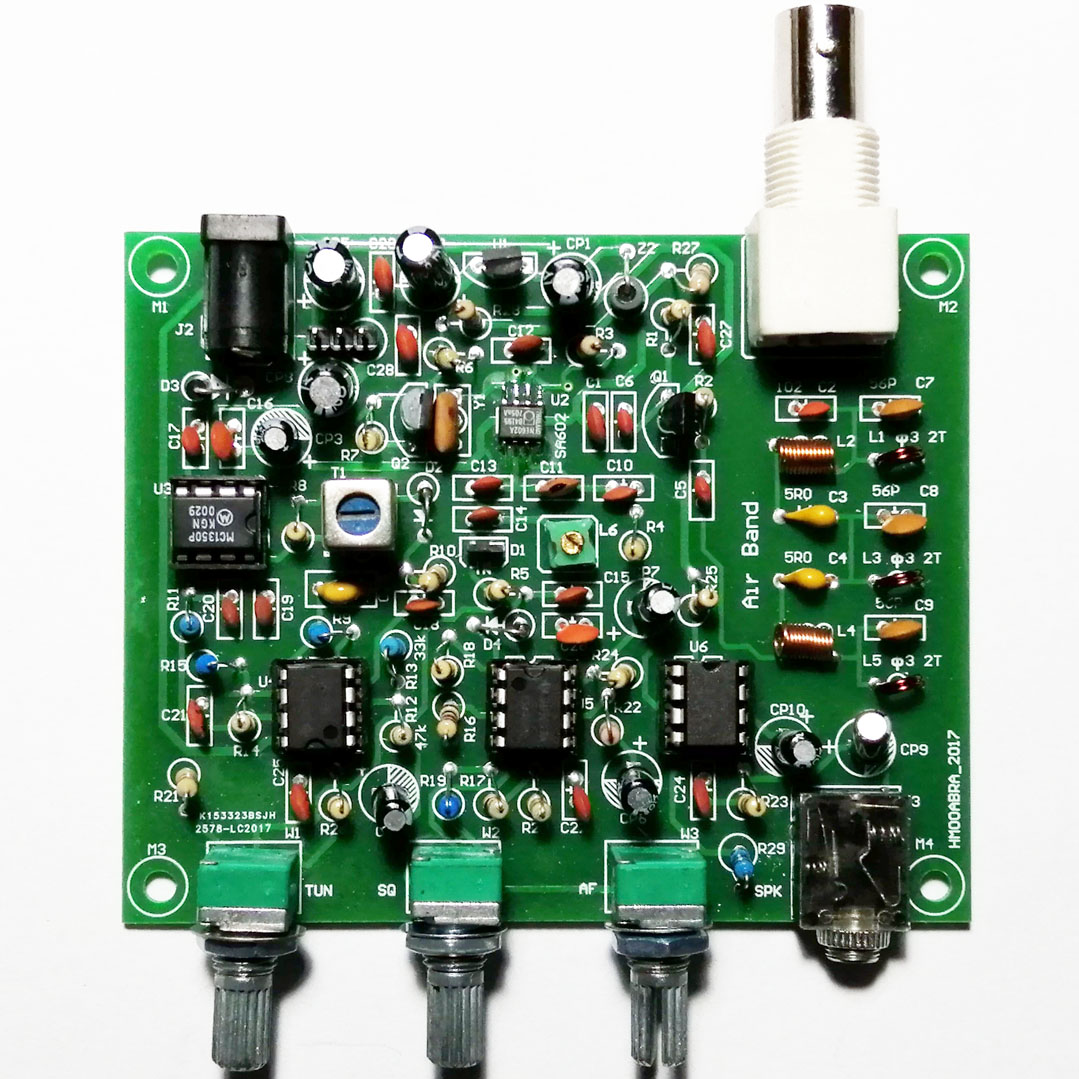

A 30 year-old electronics hobby kit still lives on to this day.
I came across a superhet airband receiver kit that peaked my interests. It’s based on a few venerable but not extinct radio ICs, namely the NE602 and the MC1350. I don’t know where the kit producer is sourcing these ICs, but for $20 it was worth taking a chance on it being more than a pack a of bubblegum. Fingers crossed I receive at least functional equivalent ICs, if not new/salvaged old stock.
You can find the kit at the usual places searching “Air Band Receiver High Sensitivity Aviation Radio 118-136MHz AM DIY Kit”
The schematic is to clean and logical to be a typical noname solder kit. After some digging around on the internet, I found the origin of the kit. This project was originally designed by Fred Blechman and published in the spring 1994 issue of "Electronics Hobbyist Handbook" by Gernsback Publications.

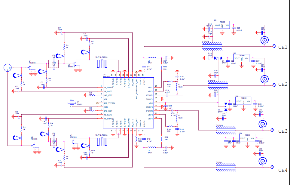

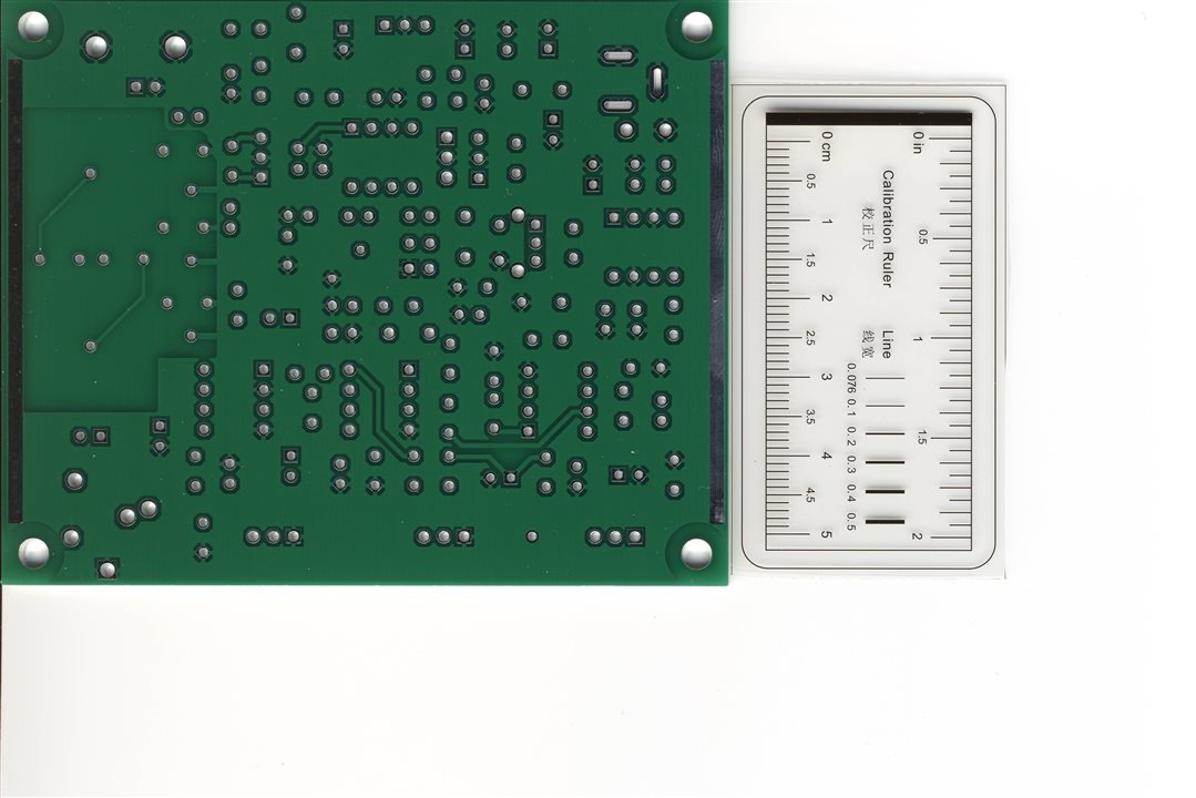

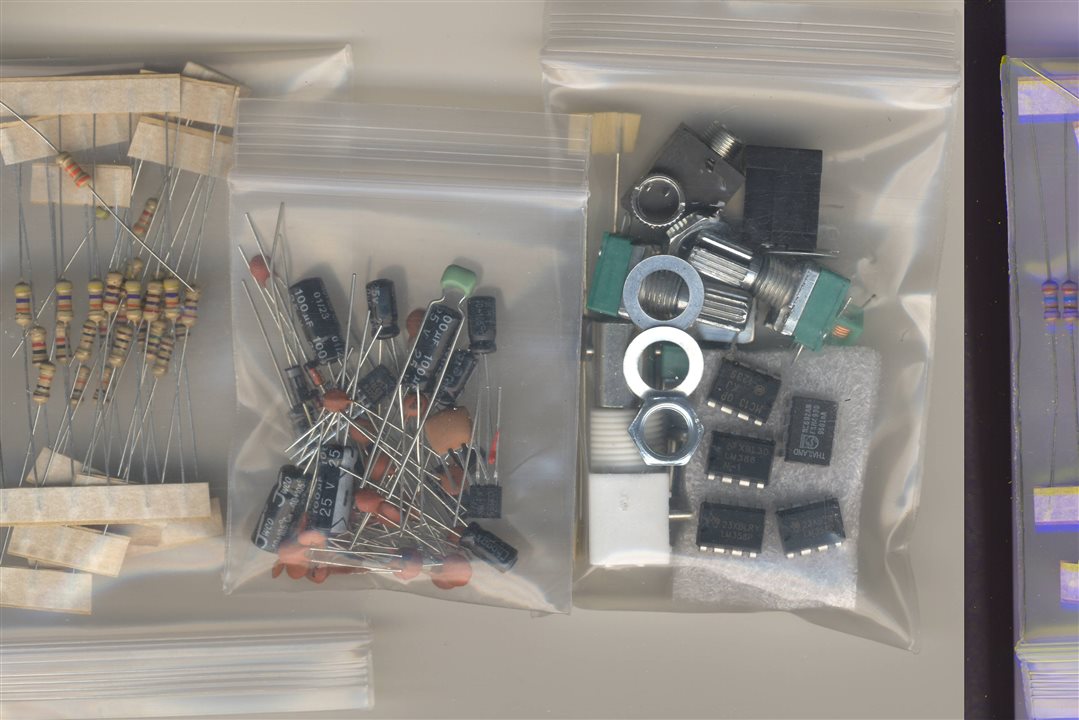

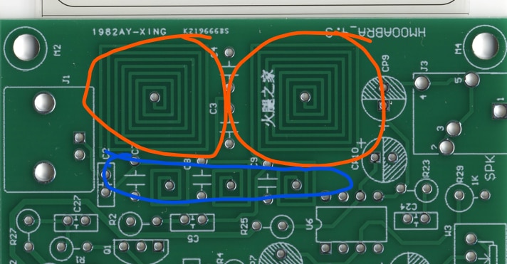

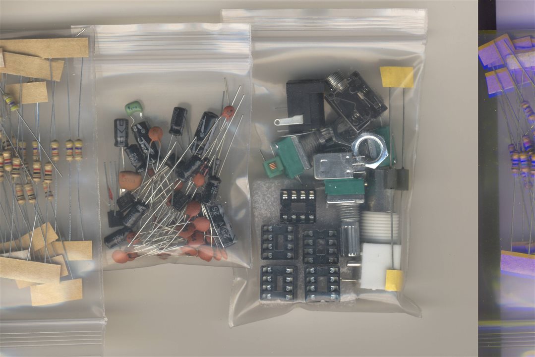

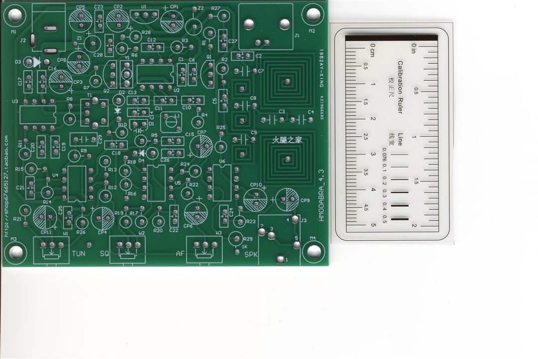

    I Have received the kit. It is subtly different from the original version, in that my kit has PCB planar inductors (not sure if that will be a positive or negative, but will will test it and find out!)
    Here is the contents of the kit:
    PCB Front
    Alternate Image: image
    PCB Back
    Components
    Components Alt
    Schematic
    Instructions

    colporteur over 1 year ago in reply to scottiebabe
    Is the symbol they used in the schematic for a planar inductor a standard? I can't seem to find a reference. I see on the schematic page they have the symbol off to the right side with some Chinese script. I assume it is indicating this is how we draw a planar inductor
