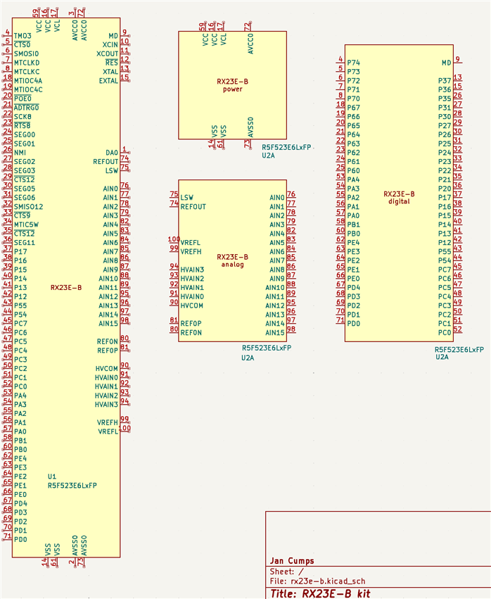

    Jan Cumps over 2 years ago
    This is the scope that I've set for the PCB I'm designing. Based on Renesas' starter kit:
    green: part of my board
    blue: I offload to separate plug-in PCBs
    red: I don't use, and make the relevant microcontroller pins available "non-committed".

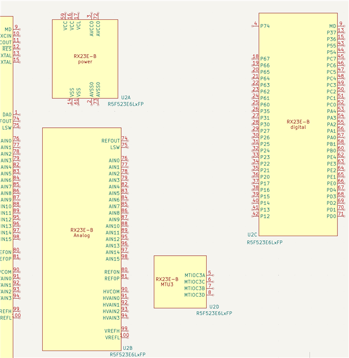

    I'm making progress. The schematic is ready for anything that is not related to the analogue front end. I had to get that out of the way, before focusing on that part;
