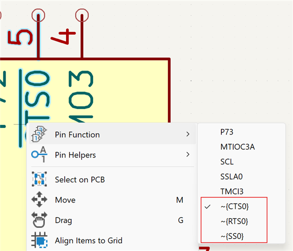

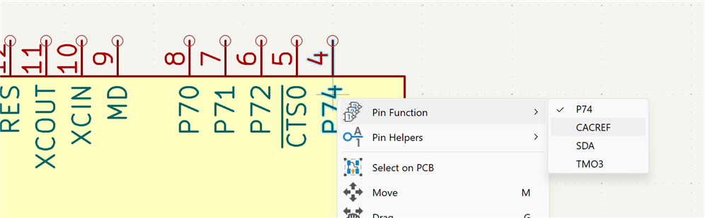

    Jan Cumps over 2 years ago
    Finished. All pins defined, with the alternative functions.
    I updated the Renesas symbol lybrary on GitHub.
