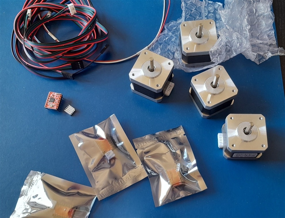

Can you have enough stepper motors? Maybe.

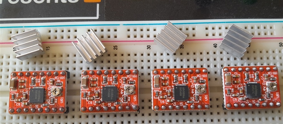

I did an investment. I had one driver IC and a good motor. I added 4 somewhat heavier motors, and 4 Allegro A4988 drivers.
(for my own documentation)
  • Motor Type: Bipolar Stepper
  • Step Angle: 1.8 deg.
  • Holding Torque: 40N.cm (56oz.in)
  • Rated Current/phase: 1.7A
  • Phase Resistance: 1.5Ohm±10%
  • Insulation Resistance: 100MΩ¸ Min, 500VDC
  • Insulation Strength: 500VAC for one minute
  • Physical Specification:
  • Frame Size: 42 x 42mm (1.7 inch x 1.7 inch)
  • Body Length: 40mm
  • Shaft Diameter: 5mm
  • Number of Wire Leads: 4
  • Wire Length: 400mm
  • Weight: 280g
  • Temperature rise: 80deg Max(rated current, 2 phase on)
Rood B+
Groen A-
Zwart A+
Blauw B-

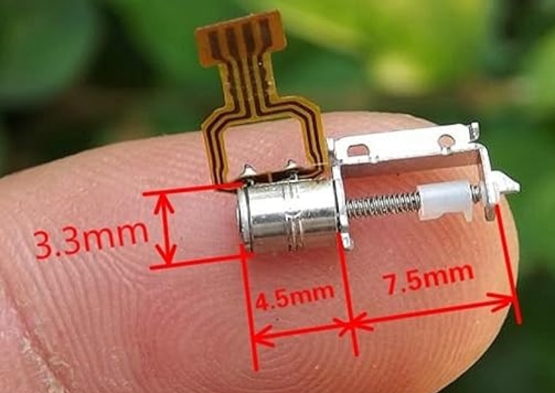

One more strange stepper is on its way from China:
image,

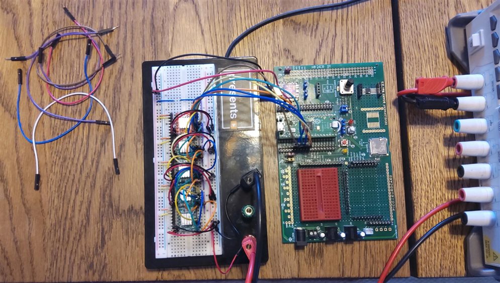

Goal is to control them with a single Pico.

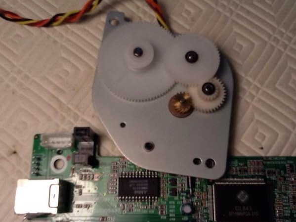

    A scanner that I took apart, had a single stepper (with reduction) for the scan wagon. And a toothed belt that interacted with cogwheels at both sides of the scanner. So the force was equal on both sides, but the rubber gave a bit of mechanical leeway.
