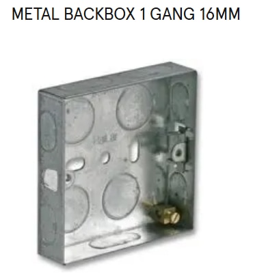

  • beacon_dave
    beacon_dave over 1 year ago in reply to colporteur
    Round ones are usually used with 'ceiling rose' fittings for lights.
    The knockouts usually have a rubber grommet inserted to protect the cable from the sharp edges of the box knock-outs it passes through.
    The earth wire is often bare to start with - the green is a plastic sleeve that is fitted over the bare copper where it has been exposed.
    Red and Black for the AC with green/green-yellow for the Earth.

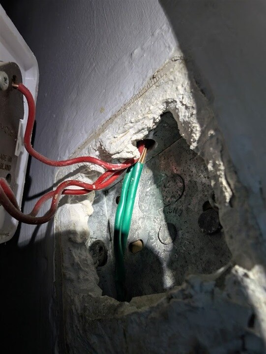

  • colporteur
    colporteur over 1 year ago in reply to beacon_dave
    I've not see the square skinny ones but the round I have.
    I would expect to see wires through a strain relief connector in one of the knockouts. The wires look like they go around the box. The green wire is missing insulation. Green and Red AC wires in the wall not typical on this side of the pnd.
  • beacon_dave
    colporteur said:
    Is that a junction box without wires in it?
    Metal backbox behind the switch
  • colporteur
    colporteur over 1 year ago in reply to cstanton
    I've seen skinny junction boxes (they use them here for bathroom fixtures) hate them. I've never seen a box installed but the wires running outsie it.d

  • cstanton
    cstanton over 1 year ago in reply to beacon_dave
    beacon_dave said:
    You mean one of those quick light switch replacement jobs that ends up involving re-wiring half of the house ?
    Were you looking over my shoulder?

  • cstanton
    cstanton over 1 year ago in reply to genebren
    I can confirm that nothing burned out, though I discovered that there's no earth wiring on the lighting circuit!
