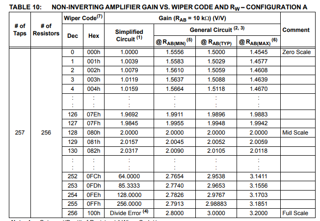

The closed loop gain of the amplifier is now a function of the digiPOT’s wiper position:
Table for an 8-bit digiPOT, table 12 for a 7-bit device is full of mistakes
Half of the wiper codes map to closed loop gains between 1 and 2. There isn’t a lot of choice for larger gains after a gain of 64 then next available choice is 128.

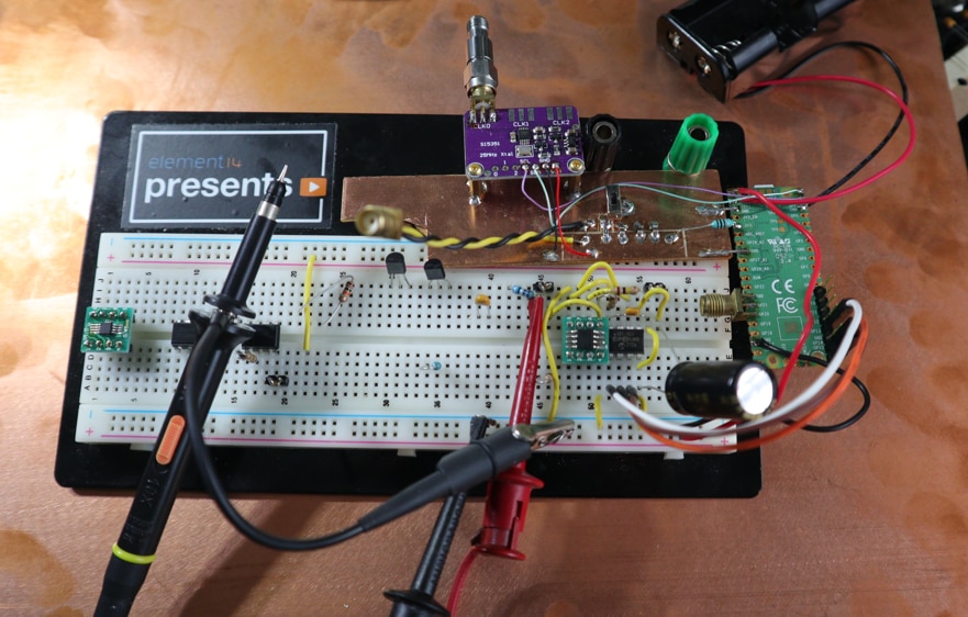

Breadboard
It just so happens I have some digital potentiometers laying around.
Specifically, the Microchip MCP4131 digital POT, which has 7-bit resolution and a total ladder resistance of 10k.
https://ww1.microchip.com/downloads/aemDocuments/documents/OTH/ProductDocuments/DataSheets/22060b.pdf
I also have some Renesas ISL28291 dual-opamps.
Both have been sent to me by element14 (and the cool breadbroad, thanks element14!)
I tossed them onto a breadboard and used a RPI pico to interface with the MCP4131 (github.com/.../main)

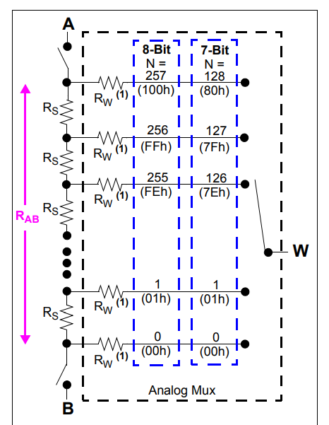

Just like a rotary potentiometer the digiPOT has 3 terminals: A, B, W
Instead of a having a continuous resistance track and a movable wiper contact, the digi pot has 128 small resistors in a series string and an analog mux that can select any of the 129 tap points.

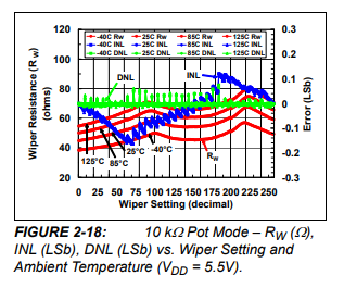

If you apply a fixed potential across the A and B terminals, then with the wiper to set to mid-scale code, the output voltage is half the input. At a wiper code of 0, ideally the wiper voltage should be 0 (unfortunately due to the resistance of the terminal disconnect switch it slightly greater than 0).
User beware, behavior at the extreme tap-points is worse than advertised.

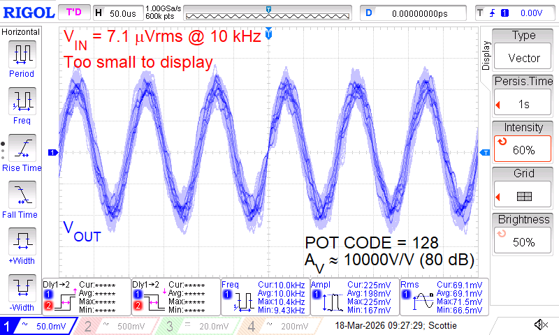

At a wiper code of 127, I measured a gain of 80x instead of the ideal value of 128x. Disappointing.
There also isn’t a lot of ‘gain resolution’, the previous wiper code of 126 provides an ideal gain of 64x.

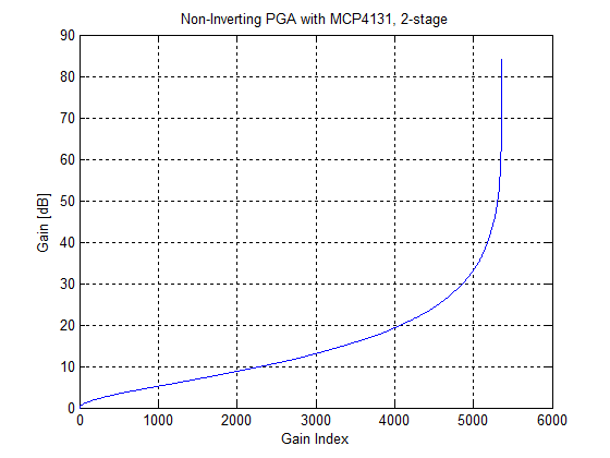

Compounding 2 for more gain and resolution
To achieve a higher total gain and have more gain steps to choose from, I put 2 in series.
Now with 2 stages, there are 5363 unique gain values.
The vast majority of the unique gains are below 50 dB. Above 50 dB there are 55 unique gain values.

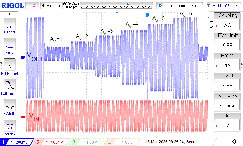

Here is a scopeshot of the PGA cycling between a gain of 1 and 6
The brief excursion on the scope plot is python being slow, micropython takes its sweet time between the spi write of the first and second digiPOT.
In summary, I am pretty happy with the dynamic range of the amplifier. The amplifier can be programed to provide gains of anywhere between unity and 10000x with 20 kHz of bandwidth and an input referred noise of approximately 3nV/rootHz.

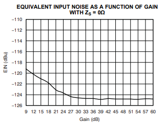

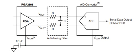

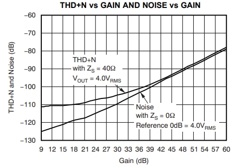

    One reference point to consider is the PGA2505
    It's a PGA with 60 dB of adjustable gain and has the following integrated input referred noise
    Which is about 500nVrms (over 20 kHz of bandwidth) at the maximum gain setting. As the input signal gets larger and requires less gain the noise figure and final SNR improves
    The bottom line is the noise limit (4vrms is cheating, 500 nVrms gained up by 60 dB is 500 uVrms on the output or an snr of -66 dB referenced to a 1Vrms output)

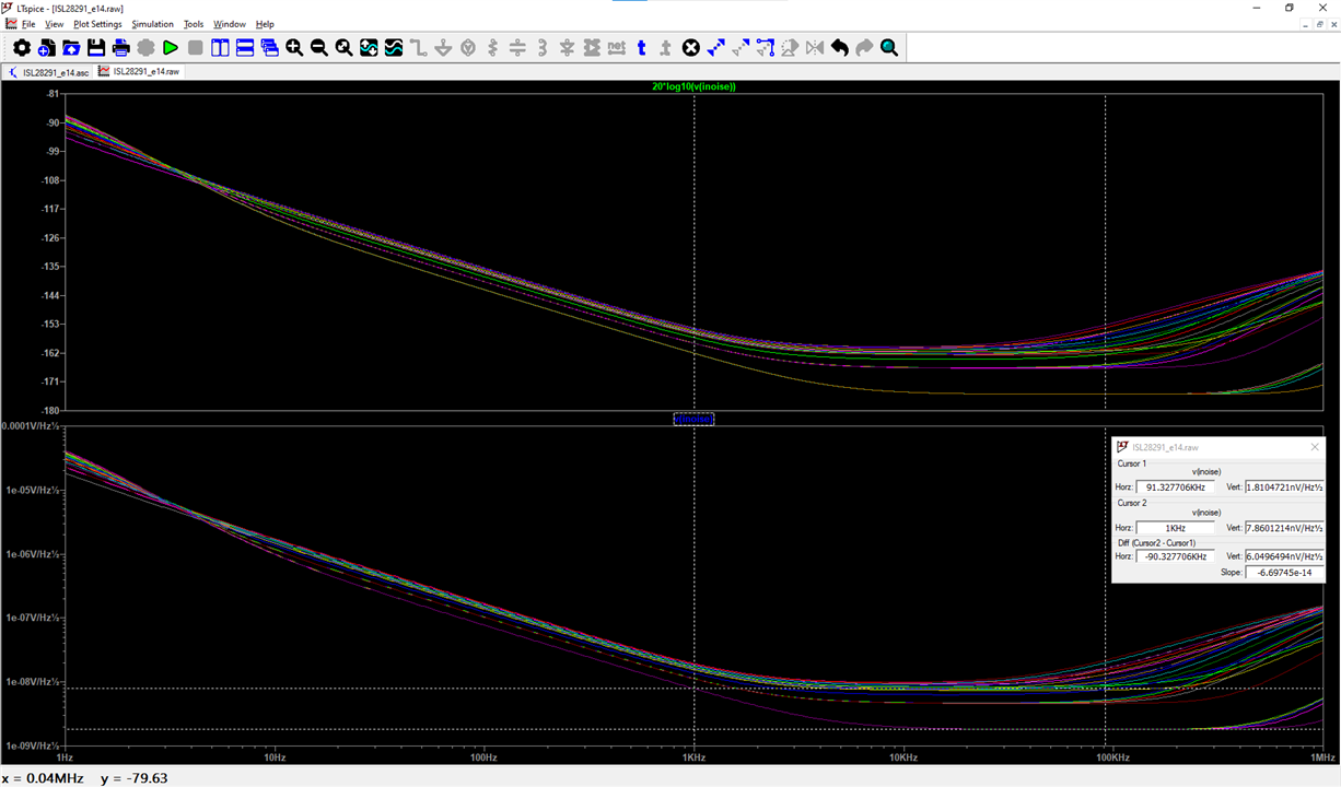

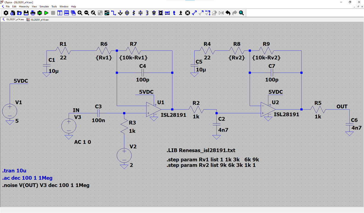

    I took the exact circuit into LTspice and did a input referred noise simulation. Just replace the digi-pot with a pair of coupled resistors and a step list of parameters.
    With resistors away from maximum gain, the minimum noise is around 4.6 nV/rtHz (-166 dBV/rtHz) at 70 kHz, which is pretty good. At the datasheet standard frequency of 1 kHz it is still 7.9 nV/rtHz (-159 dBV/rtHz).
    The very minimum of the noise happens when one opamp is at maximum gain and the noise contribution of the opamp becomes negligible. 1.8 nV/rtHz (-175 dBV/rtHz) at 90 kHz.
    At lower frequencies, the noise gets worse quickly. It is really difficult to get good noise performance at frequencies < 20 Hz. Audiophiles/fools might not care, but scientists do. It is usually a J-FET + low noise opamp combination with really big caps at the bias and reference voltages. Other components are noisy too, especially resistors. And the supply rail will contribute as well.
    This was fun.

    That's why I included it, so I can use wiper code 128 as a try and see, for the parts I had used it allows for a gain setting over 100x but not much more

    scottiebabe said:

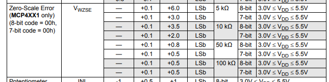

    I guesstimate the end terminal switch had about 1/2 RS of resistance. So instead of a gain of 1+ 127/1, it was closer to 1+127/1.5
    Buried in datasheet, the zero-code offset error could be up to 2 LSB
    The 22R resistor will make this worse (but it does give you some control of the gain if you select the 'zero' position of the wiper.

  • scottiebabe
    scottiebabe 8 months ago in reply to dang74
    Very clever observation!
    They post fancy INL/DNL graphs, which in general are accurate except for the very last couple tap points
    The first few and last few codes are worse.
  • scottiebabe
    scottiebabe 8 months ago in reply to michaelkellett
    Great advise, I could have expanded more on GBW product.
    At maximum gain the upper -3db point is still largely determined by the RC low pass filters(luckily the op-amps are plenty fast)
    Here is a frequency sweep (sorry my o-scope doesn't have social media upload to tik-tok buttons, so a cheesy video instead)
    *There is an inline 50 dB PAD before the DUT, so the input is 30 uVrms
    Blue: Input before PAD
    Yellow: DUT Output
