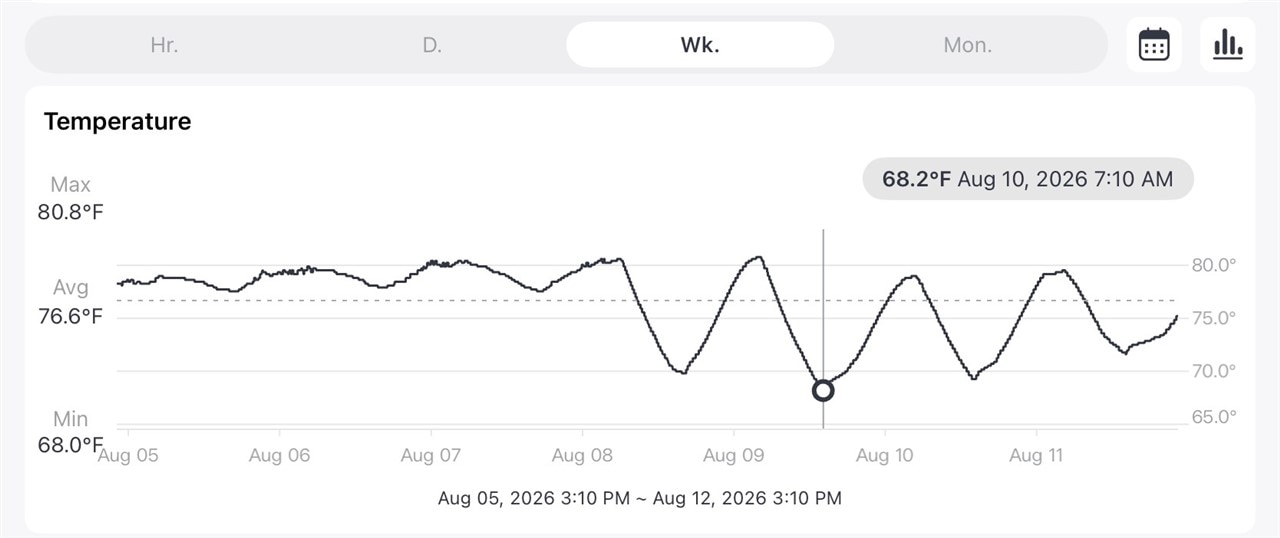

    Here is an interesting plot of the temp in my upstairs computer room over a week - this is the room that is hardest to cool in the summer.
    The first few days we had bad air quality, so the windows were always closed.  The high temp is maintained by the AC (the control sensor is downstairs set at 76 F).  The lows are due to the houses cooling overnight without ventilation.  The second half shows the effect of window ventilation at night.  During this period the low temperatures achieved were actually sufficient to prevent the AC from running all day.  The outdoor temp for this week had a high of 98 F and a low of 58 F.
