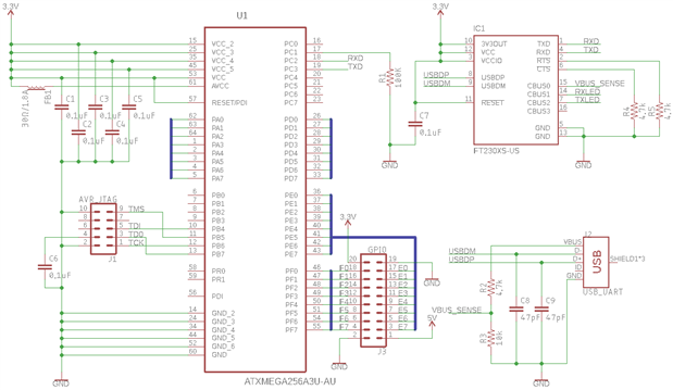

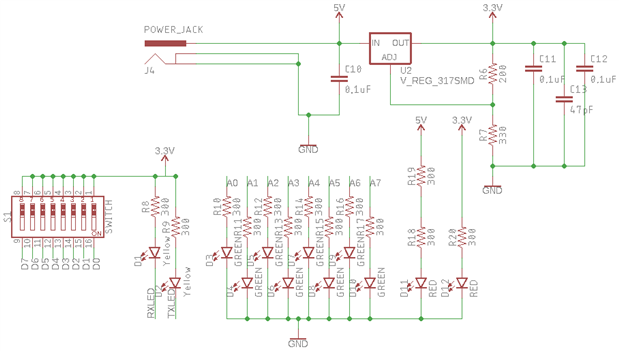

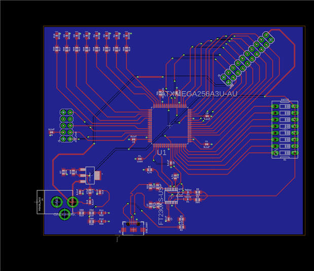

Sorry if this is incorrect forum/basic question. While I have a background in programming and some experience with FPGAs the I didn't know much about EE before. I run into a hobby project for which I'd like to create a PCB and soon I found myself in deep waters. So I decided to step back and create a simple PCB to learn basics. I tried to create a simple AVR board with an GPIO header, JTAG connector and USB-to-UART bridge. I've created something but I'm sure I've done many basic mistakes and strange decisions so I'd be grateful for pointing them out.
PS. I know there is no power switch but I couldn't find one on with eagle library.
    shabaz over 8 years ago in reply to mpiechotka
    (By the way, if you need mounting holes, don't forget to add them.).
    Hi Maciej,
    That looks great!
    Regarding 'run length', I only use it to check for unrouted airwaves, I've never checked to see if the resistances look accurate. I just use a PCB trace calculator if I really need to do that, but for a microcontroller project, I'll stick to things like 8-10mil for general traces, and then use a power plane, or something perhaps around 16-24mil to get power from the supply to the microcontroller (and have the 100nF capacitors close to the microcontroller, like you have).
    genebren over 8 years ago in reply to mpiechotka
    That is look great I like that you entered the  FT230XSFT230XS from the opposite side thus avoiding the crossover vias very nice(I may have to try that if I re-layout my board

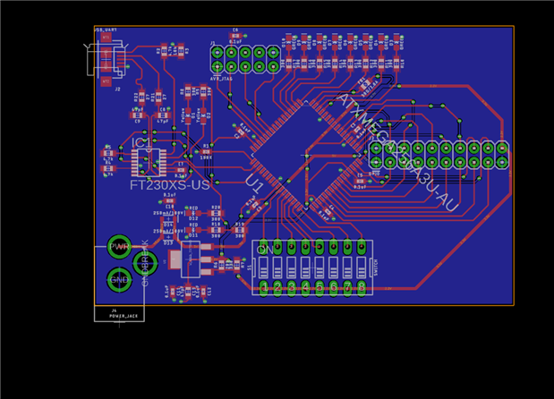

    Thanks. I think I'm starting getting the basic rules (I restructured the board so it fits in 2" x 3").

    While looking for the command I run into length_freq_ri and my 3.3 V signal (from current iteration of board) has R of 861.49 mOhm (I don't think the tool have 5 s.f. accuracy and at least 3 numbers are 'fake'?) and GND, despite being pour, 156.43 mOhm. Are those numbers reasonable or should I be worried (I don't know how much 'resistance' IC has[1])
    [1] I put in quotes as I know IC are not linear so word resistance doesn't really applies here.
    This is looking a lot better.  Funny, that the pin-out of the microUSB and FT230X require a crossover on the D+/D- signals.  I used the same combination recently and was annoyed that I had to use vias to cross the two signals.

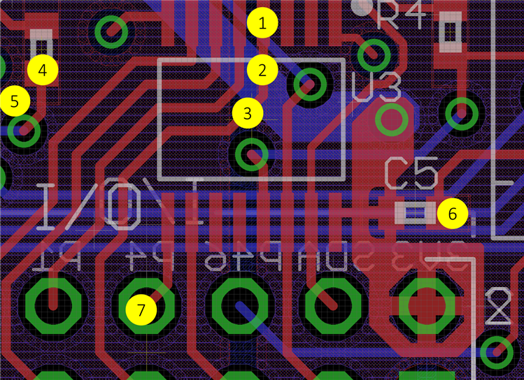

    Is there any script to 'fan out' (I know the term means something completely different)? I tried to rotate the header but I still get the bunching up:

    Just a quick FYI, but the USB is not supplying power to the board, but only providing a signal when the USB is plugged in, via the bus sense.  There should not be any excessive current draw.
    Gene
    By the way Maciej, since you're using EAGLE, be sure to run the design rules check (DRC) too, and also _never_ forget to type 'run length' in the EAGLE command line, before you feel you are ready to submit the PCB to the factory (you'll only make this mistake once : ) That command will tell you if you've forgotten to route an air-wave.
    I'm not very good at intuitively routing PCBs, so for me what works is approximately routing things, and then ripping up and re-routing traces to tidy them up. Basically I manually do two passes.
