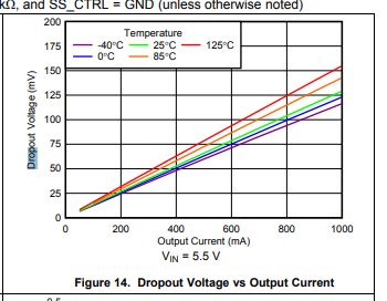

    Regulators require a minimum amount of voltage overhead to operate correctly.  An LDO typically (always check the documentation for the IC) have a voltage drop out of roughly 0.3-0.5 of volt where as a typical voltage regulator may have somewhere between 1.5-1.7 voltage drop out (again not necessarily, so always check the chips documentation).  Say you had a 5v source (like a wall wart) and you wanted to power a 3.3 volt device, this would be a great application for an LDO as after you subtract your 0.5v from the 5v, you still have 4.5v, plenty of head room to regulate down to 3.3v.  Where as if you used a regular dcdc converter that might have a voltage drop out much greater and may not get the regulated voltage that you want.  I guess what im trying to say is pay attention to the voltage drop out spec, this value is also relative to current draw as well; again you should look at the documentation and check for a graph that shows how the voltage drop out is effect by current draw.
    Like this one for TI TPS7A91, found on page 8 http://www.ti.com/lit/ds/symlink/tps7a91.pdf
    Hope this helps
