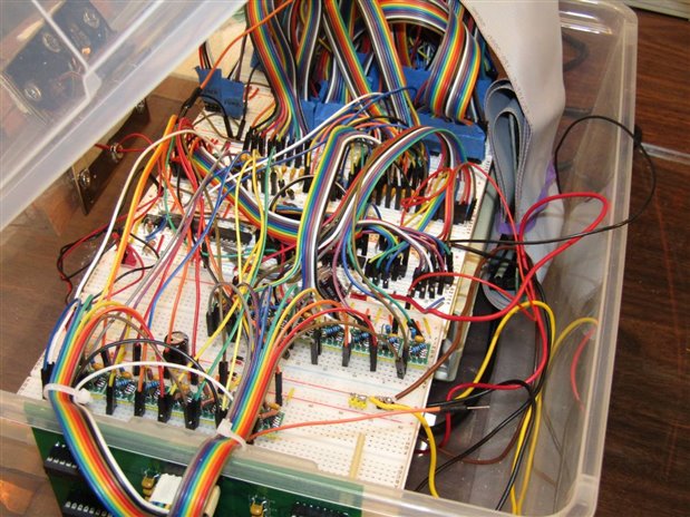

    Von has done an excellent job wiring the prototype up despite the connection difficulties imposed by the density and complexity of the wiring. Functionality has been greatly affected by some less than quality breadboards and patch wires.

    Very skillful breadboard work there, not sure I could have achieved that level without occasionally pulling out a wire with my clumsy hands image
    Rod
    genebren over 7 years ago in reply to jw0752
    Looks like you work is coming along nicely.  That is quite an impressive prototype.  Are you getting the results he was looking for?

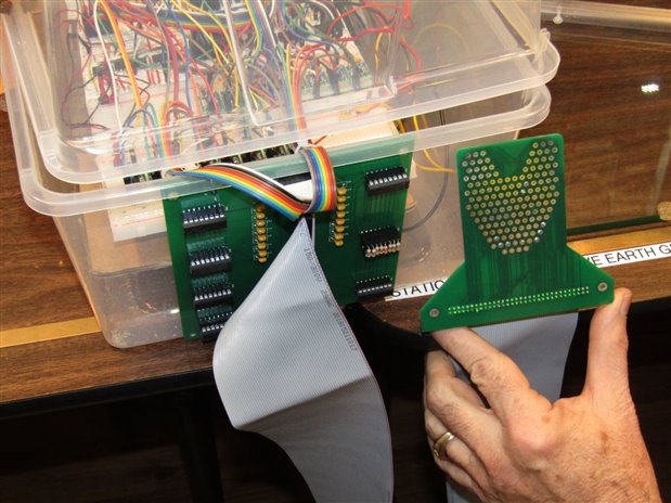

    That's an impressive prototype! Also congrats on the really nice design methods you're using - The PCBs look easy-to-build and maintain, and such a modular design could also allow people to experiment with changes too perhaps, e.g. different levels.
    Thanks for the update and interesting photo.

    Since I introduced vwolff  to the forum back in July he has been working tirelessly to design and construct a PONS neural modulator. I have been privileged to be his lab assistant in this endeavor. To date Von has built a breadboard prototype of the modulator and has been running field tests on it. The project has been complicated as there are 16 channels each of which have 4 different attenuation paths before contact with neurons. The complexity has made for problems keeping all the jumper wires on the breadboards in place and making proper contact. Here is a picture of the bread boarded prototype.
    In the last month or so Von has been working to put the unit on circuit boards. Today he brought over the interface board which takes in the 16 channel output and breaks out the 4 different attenuation lines for each channel and provides the 64 pin output to the body interface board. The new board replaces about a third of the above pictured breadboarding. Here is a picture of the new interface/ attenuation board and the body interface board.
    Along the way I made a small custom power supply for the unit, assembled some MOSFET driver modules that were inspired by genebren and shabaz and I have been having a blast assisting Von with this project. Von is off to design the next replacement board and we will be soon totally on circuit boards and hopefully will no longer be bothered by loose wires and intermittent problems.

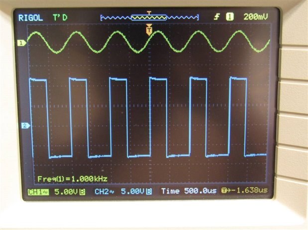

    genebren over 8 years ago in reply to jw0752
    John,
    The signals look good.  I really like the way you were able to modularize the driver onto a single adapter.  Very cool!
