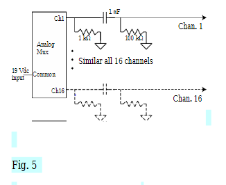

    The overall schematic:
    Zooming in a bit:
    and zooming in more:
    The "VDC" is 19 volts.   I think the 1K pullup resistor could be a larger value and still supply enough current?  What do you think?

    shabaz over 8 years ago in reply to vwolff
    Hi Von,
    I didn't understand how you were using the 74LS06 to select the voltage level. If you have a sketch that would be awesome.
    In any case, if the output is from a logic gate with totem-pole type output stage, then the 1k resistors are not needed. Otherwise, they would be needed I think.

    vwolff over 8 years ago in reply to shabaz
    I'm using logic gates:  A 74LS154 as a mux driving 74LS06 open collector inverters to Shift the voltage level. Thanks again
    Hi Von,
    Is your circuit using analogue multiplexers like in the diagram, or instead using logic gates? If the latter, then the 1k resistors are not needed, because the logic '0' state acts like the low impedance to ground anyway. I too was thinking (before I saw the diagrams) that the outputs could just have high and low driving MOSFETs or logic gates, to eliminate the need for the resistors and save a bit of power as you say.
    jw0752 over 8 years ago in reply to vwolff
    Hi Von,
    Just a clarification. The capacitor is 1 uF correct?
  • vwolff
    Shabaz,
    Thank you for reviewing the document.  The diagrams are at the end of the document.   I have implemented a version of the PoNS in discrete logic.  I have a question regarding Figure 5 and the description.  Is says:
         Fig. 5:  An analog multiplexer (Mux) routes a fixed voltage
         source to one of the 16 channels according to the timing diagram in Fig. 2. The capacitor
         provides dc blocking; the 1-kΩ resistor provides the return current path for unpulsed
         electrodes, and the 100-kΩ resistor establishes the dc operating point (see text). The
         internal ―on‖ resistance of the multiplexer is approximately 130 Ω
    It works without the 1K resistor.   With the resistor, it draws a lot of current and would kill a small battery quickly.  What is the draw back of not having the 1K resistor in the circuit?
