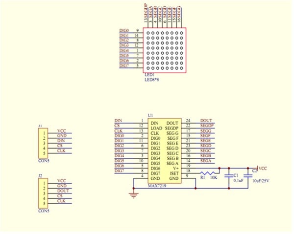

The 5x8 LED matrix panel
Below we have a typical circuit for MAX7219+8x8 LED matrix, this is the beginning, further I looked for a datasheet for 5x8 LED matrix.
{gallery}My Gallery Title |
Typical MAX7219+MAX7219 circuit |
5x8 LED matrix pinout |
Then I multiplied the circuit to make an 8x20 panel:

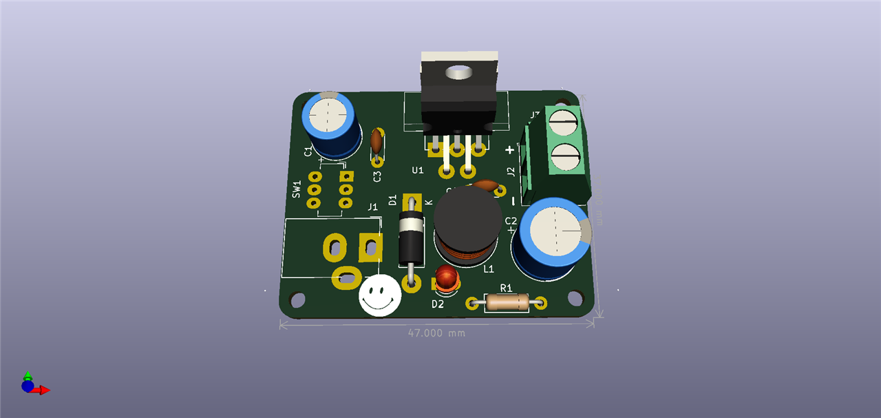

Power supply
I have previously made some PCBs for LM2575 which give me 5V DC, and I have a 9V adapter at the input. It is a switching power supply and I use it as a step-down from 9V or 12V to 5V.
I am also attaching a circuit for those who need it:
LM2575 buck converter |
LM2575 PCB |
BoM:
