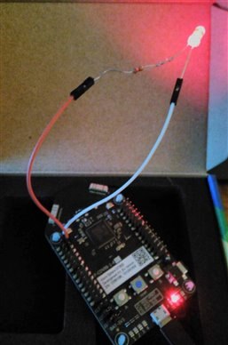

Once I'd got blink working I thought I'd try that again with an external LED.
I swapped out the red LED with one of the GPIO pins on header 1 and fired up the code. The debug console returned the following.
Opening MT3620_RDB_HEADER1_PIN4_GPIO.
ERROR: Could not open LED GPIO: Permission denied (13).
That's because I'd not updated my app_manifest.json to include GPIO0 aka Pin4. Once I'd done that the code worked fine.

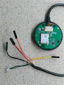

So we can determine the position and orientation, I purchased a Ublox NEO-M8N GPS & Compass. This was packaged for use with a drone flight controller so I needed to swap out the connector with some suitable for the 0.1in pins. I'd found some wiring examples online but my colours did not match so I unscrewed the case to re-assure myself and was glad to see the connectors were labelled.
Using the U-Centre tool and a USB to TTL adapter, I experimented with different Baud rates until I got some output. The module seems to continuously stream messages. There's a massive 300 page manual on the protocol but I've ascertained that there's commands that can be sent to turn on and off the different messages that are streamed. I'll also take the device outside (or perhaps under the skylight) so I can see if I can pick up some satellites.
