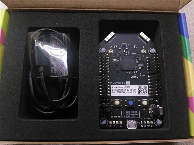

Microsoft has partnered with French and German distributors but I could not work out how to order from them for the UK. So I ordered from Seeed making sure to pick the EU model so it works properly with our Wifi.
There's not much in the box, just a card with the Wifi conformity details and URL for SDK along with the board and a USB cable.

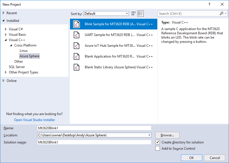

It is possible to cross-compile Azure Sphere code from the command line using just the SDK and GCC but if you use Visual Studio it's possible to build and debug from the IDE. I use VS at work so am fairly familiar with it so that seemed my preferred option. The Visual Studio suite of tools is pretty large so I installed the "Comunity Edition" onto my home machine using just the core editor to start with. That was still 650MB.
https://azure.microsoft.com/en-gb/blog/developing-an-azure-sphere-experience-with-visual-studio/
I then downloaded the SDK which at this time is still a preview. http://aka.ms/AzureSphereSDKDownload
There's a new version of the SDK out next week. https://azure.microsoft.com/en-gb/updates/upcoming-azure-sphere-18-11-release-announcement/
Installing the SDK took some time on this machine as it needed to install all of the other prerequisites and dependencies, the Azure Sphere components when it finally got to them did not take long at all.
I then fired up Visual Studio, created a new project using the blink sample and hit build.
That completed successfully.

One point of interest is that the code contains a manifest file, that contains the capabilities that the processors are allowed to use. This is part of the firewalls mentioned earlier. If you don't include a required GPIO or UART then the processors won't connect to them. As an experiment, I removed GPIO 8 from this list (the LED that is toggled by the code) and it still compiled successfully so this is only checked at runtime.
