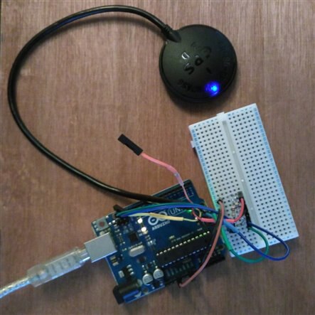

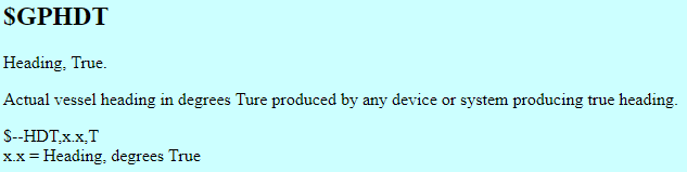

My experiments with U-Center and the GPS module had shown that the direction indication was not very reliable. Following a link in Kevin Saye's post, I discovered a command that should tell the orientation. But my device did not seem to be generating that.
http://aprs.gids.nl/nmea/#hdt
Reading a bit further, I realised that the compass feature was provided by a  HMC5883HMC5883 connected over I2C on a second connector. So I soldered a green wire onto the SCL connector and a blue wire to the SDA. I did a test with a sample from instructables and an Arduino Uno (using 2x10k resistors pulled up to the 3.3v line) and got some readings from the sensor. Checking the HMC5883 datasheet later 2K2 resistors were recommended so I'll reduce my values if there are any issues.
I realised from looking at this code that there is a magnetic deviation for compasses and really my project should compensate for that based on the current position. Perhaps another Azure Function is the best approach for that as it allows for adjustments over time.
So a bit of a problem with connecting the I2C to the Azure Sphere, the MS team have yet to support I2C in their SDK. I'd come across chips before that did not support I2C and knew that the protocol could be implemented in software with a technique called “bitbanging” i.e. you toggle a GPIO to have the desired behaviour. AlaskaResearchCubeSat had a great example bitbang I2C which looked straight forward to port.

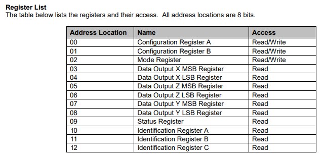

This still needs testing but it does compile, the identification registers seem good candidates for the read testing as they have fixed values. As is common with most I2C devices the "read" register is selected by sending a single byte with no data.
"To move the address pointer to a random register location, first issue a “write” to that register location with no data byte following the command. For example, to move the address pointer to register 10, send 0x3C 0x0A."
From Honeywell HMC5883L datasheet.
Note that the output is in the form of a vector so that needs converting to a bearing using the X and Y values and Arctan function. The AdaFruit library used by the Instructables article has a good example of that. I'll like wrap the call to the compass up with a separate function so you don't need to see the low level I2C functionality. I quite like the AdaFruit universal sensor approach but that seems a bit overkill to copy here.

    First capture in from the Arduino version of the code.
