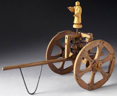

As hinted at in some of the previous posts I'm going to be using the board to complete a small project. Because the SDK only supported UART and GPIO at the time I started the project I was looking for something that could be run with that. My first thought was some sort of guage using a stepper motor. Then a chance discussion with my boss about the flakey GPS collar he has on his dog got me thinking if there were GPS modules that use serial comms. I found a suitable module whcih was designed for drones. I was thinking about something a bit like the South Facing Chariot. However given that I was also thinking you could program where you wanted to go, perhaps this is a bit more like Jack Sparrow's compass, so I suspect my results will end up more like that.
