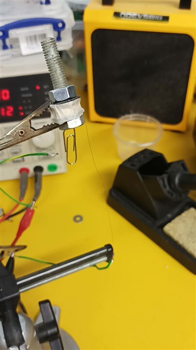

    Not guitar pickup, was trying to make a magnetic stirrer, so there were multiple coils to wind. But it didn't really work as the field was not strong enough. But it could pick up paper clips.
