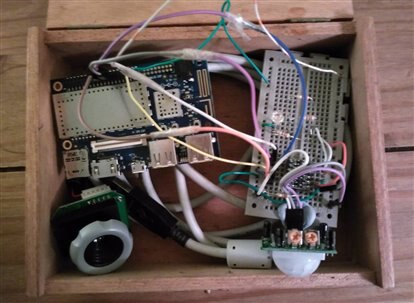

As the Dragonboard uses 1.8v logic levels, I used a simple MOSFET based level shifter module.
One channel was connected to my HC-SR501 Passive IR module, the other connected to the three pins of a RGB Led.
I had some issues getting the libsoc code to work, which turned out that I'd forgotten to "request" the GPIOs. Once I'd added that in, it is straightforward to flash an output on GPIO-B.

The next example lights the RED led when the sensor detects movement. I noticed that whilst doing this that the output from the IR module appears to float when there is nothing detected so I added a pull down resistor to the output pin and the circuit became a lot more predictable.

I've also been looking at boxing up the project. Normally I'd build this on strip board but as I'm a little short on time, I think it will likely stay on the breadboard. The webcam cable is quite long so I'll see if I can safely shorten that.
