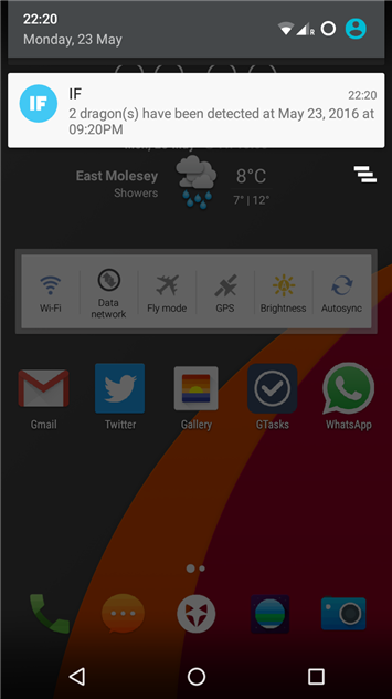

When my Dragon Detector spots a new dragon I want it to notify the operator that something has happened. When looking for ways to do this, I discovered the IF THIS THEN THAT "Maker channel" this allows you to trigger IFTTT flows by calling a URL of the following form
https://maker.ifttt.com/trigger/{event}/with/key/{channel key}
You can also pass in parameters so that you can customise the flow. I added the IF client app to my mobile and configured a simple "recipe" to link the maker event to my notification.
To call this from the Dragonboard I used Pycurl which was installed earlier.
from StringIO import StringIO
import pycurl
def get_key():
    with open('IFTTTKey.conf', 'r') as f:
        key = f.readline()
    f.close()
    return key
def get_notifyURL(numDragons):
    return "https://maker.ifttt.com/trigger/DragonDetected/with/key/" + get_key() + "?value1=" + str(numDragons)
def call_api(url):
    r = StringIO()
    c = pycurl.Curl()
    c.setopt(c.URL, url)
    c.setopt(c.CONNECTTIMEOUT, 10)
    c.setopt(c.TIMEOUT, 60)
    c.setopt(c.WRITEFUNCTION, r.write)
    c.perform()
    c.close()
    return r.getvalue()
print call_api(get_notifyURL(2))
