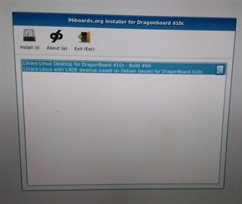

So I switched to Linux, which can be installed from the SDCard
https://github.com/96boards/documentation/wiki/Dragonboard-410c-Installation-Guide-for-Linux-and-Android
To boot from SDCard you flip a switch on the back of the board. The DIP switch is minuscule! I used my smallest screw driver to set it. I also seemed to be getting the wrong images, the key seems to be to get one that says "SDCard install" in the name, if you follow the link in the instructions that will get you to the right download. Even after this I had trouble with my the first card that I'd imaged.
Finally I managed to get it all plugged correctly (my HDMI connector was loose) and the flashing could begin.

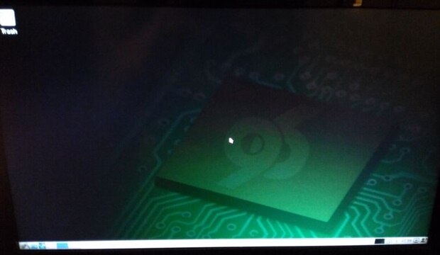

That process went smoothly and I took out the SDCard and rebooted in the Linux desktop.

    Very good Workshopshed I started with Android and even got the Wifi to work. But for my needs, I had to get Debian(linaro) to work from 96boards.com. I took a glance at Ubuntu but it was less complete…
  • clem57
    clem57 over 10 years ago
    Very good Workshopshed I started with Android and even got the Wifi to work. But for my needs, I had to get Debian(linaro) to work from 96boards.com. I took a glance at Ubuntu but it was less complete as to installed packages. Besides the screen has a cool looking color as you can see.
