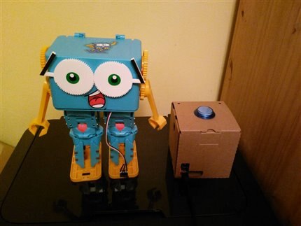

I decided to wire up the Google AIY box to Marty the Robot.
OK Google!
The first thing to do was to upgrade the software so I did not have to press the button to work the robot. I followed Eric Duncan Google AIY upgrade steps.

Then finally I added a class to process that command, I based the flow on the Hue Lightbulb one provided. I used the "calibrate tool" to find my Marty but I think it's also possible to find them in code. I'd also recommend enhancing the code to cope with exceptions.

Finally to test run
src/main.py
Once you are happy with testing you can restart the recogniser service with
sudo systemctl start voice-recognizer
My biggest issue was that Google did not like my accent so I ended up adding lots of keywords with the combinations that the voice recognition had detected. Also the detection needs to match exactly so you'd end up having to add lots of different commands. One approach is the approach taken by Marcin Gorecki to use wild cards. You could then say "Marty Walk Forward Five Paces" and have the recognition software parse the number of steps.
