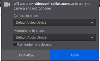

The meting was held in Zoom and, since there's no application for Raspberry PI, I used the Browser.
Firefox ESR 78.9.0esr is to forget. It does load the page and enters the meeting, but the camera is a no go. It just stays green and yes, all the permissions are given.
Permissions in Firefox
On the other hand, with Chromium the camera worked fine and almost everything went smooth. It even asked me to install an APP through the APP store, but I just went with the browser version.
I did had trouble with the bluetooth audio, a lot of stuttering. It was impractical. Don't know if because I was also casting Netflix (kids...).
Edit: The audio stopped doing that when I focus the meeting TAB on Chromium. If I was on another TAB browsing or in another program (like in Firefox writing this) the audio stutter and the camera freezes.  The audio was not doing that always, but the camera was frozen until I got back to the TAB. Weird...
Maybe Firefox is just to low of a version.
