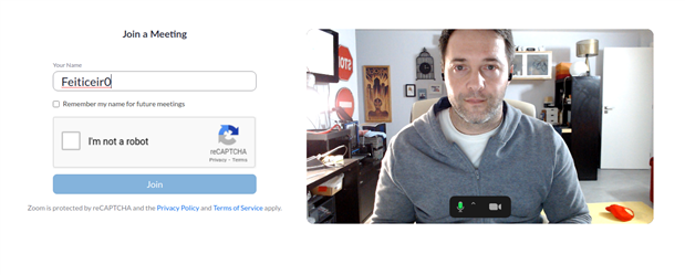

Web Camera
Today I had a meting of the local computer club. We're preparing for the Raspberry PI JAM next April 17th.
The camera that I used was a Logitech C920 Pro. Raspberry PI OS detected it without any problems.
pi@raspberrypi:~ $ lsusb
Bus 002 Device 001: ID 1d6b:0003 Linux Foundation 3.0 root hub
Bus 001 Device 007: ID 04d9:0007 Holtek Semiconductor, Inc.
Bus 001 Device 006: ID 093a:2510 Pixart Imaging, Inc. Optical Mouse
Bus 001 Device 005: ID 046d:085b Logitech, Inc.
Bus 001 Device 004: ID 0a12:0001 Cambridge Silicon Radio, Ltd Bluetooth Dongle (HCI mode)
Bus 001 Device 002: ID 2109:3431 VIA Labs, Inc. Hub
Bus 001 Device 001: ID 1d6b:0002 Linux Foundation 2.0 root hub
The meting was held in Zoom and, since there's no application for Raspberry PI, I used the Browser.
Firefox ESR 78.9.0esr is to forget. It does load the page and enters the meeting, but the camera is a no go. It just stays green and yes, all the permissions are given.
Permissions in Firefox
On the other hand, with Chromium the camera worked fine and almost everything went smooth. It even asked me to install an APP through the APP store, but I just went with the browser version.
I did had trouble with the bluetooth audio, a lot of stuttering. It was impractical. Don't know if because I was also casting Netflix (kids...).
Edit: The audio stopped doing that when I focus the meeting TAB on Chromium. If I was on another TAB browsing or in another program (like in Firefox writing this) the audio stutter and the camera freezes.  The audio was not doing that always, but the camera was frozen until I got back to the TAB. Weird...
Maybe Firefox is just to low of a version.
I will try other browsers based on Firefox that people say work well on Raspberry PI, like the Pale Moon. More on that another day.
