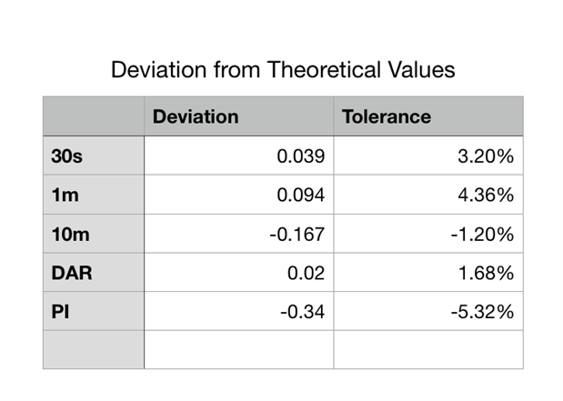

Time for testing, no point in messing around, so lets go for 5000V, supplied by the Metrel MI3205 insulation tester
This seems to be a perfectly acceptable set of results for the simulator. The most variation is seen at the 1 minute reading where the actual reading was 4.36% above the expected value. This has consequentially led to the difference in the DAR and PI values. The output plot shows a good correlation of the lowest and highest test voltages against the mathematically derived curve, which is particularly pleasing.
I also have the Fluke 1555 at my disposal. I tested the simulator at 5 different test voltages that the 1555 is capable of. As with all the polarisation index tests I carry out, I took readings at 15 seconds for the first minute and at every minute after that so that I can plot the insulation resistance values.
The output plot shows the lowest and highest test voltages against the mathematically derived curve. A higher difference is seen for the 250V test on this tester than for the Metrel unit, but the 5000V test results are a little better.
Overall, this is a pleasing set of results. Being able to test the DAR and PI functionality of an insulation tester has always been a good option for me, but I have now succeeded in extending this capability to be able to match the performance of an insulation tester to a theoretical model. It is also good to extend the voltage capability of the simulator, so that different ranges of the instruments can be tested, instead of sticking to the lower voltages.
