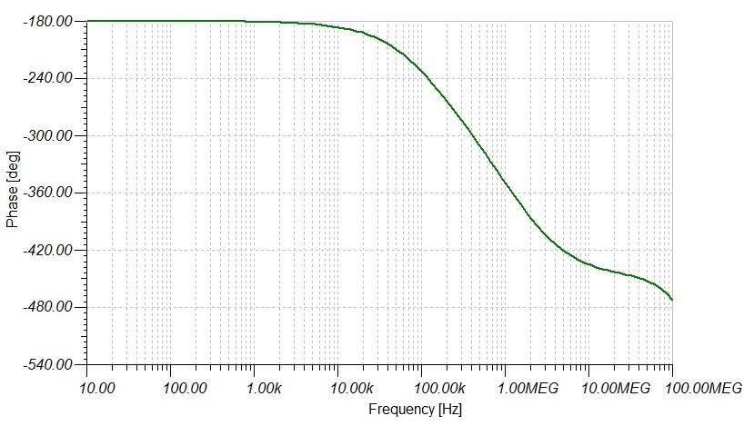

Basic Compensation
As you can see from the circuit, I'm starting with the output lead inductance (L2) being zero (so it's like a perfect
connection wire) and the compensation capacitor (C1) also being zero (effectively, not there). I find that it's quicker just
to set these to zero when they're not wanted rather than to take them out of circuit and then have to re-introduce them. Here
are the Bode plots (unfortunately, the software can't always make up its mind how to present the phase scale on the left - so
on the later ones you'll see a scale from +180 to -180, which is equivalent to what you see here):
Is this going to be stable? Well, I already know the answer to that because when I first built the load I left out the
capacitor and this was the result,
but can we tell that from the Bode plots?
Yes, we can. If we look at the phase curve, we can see that the curve crosses -360 degrees at around 1.2MHz. At that
frequency, the magnitude curve shows 14.5dB of gain (that's only a gain of 5.3, but anything over one will allow an
oscillation to build), so the conditions are there for oscillation. There is another way we can tell because the magnitude
curve and the phase curve aren't actually independent and there is a relationship between the two, so the fact that the curve
is so steep as it passes through the 0dB level would tell an experienced designer that there's a problem, even without having
the phase curve to look at.

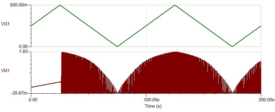

If I simulate it closed-loop with the same triangle waveform at the input as I had when I tested it, this is the resulting
waveform
That's more extreme than the real circuit, a useful reminder that the real circuit has parasitic capacitances that affect the
results somewhat [it's hard to achieve a 0pF capacitance on an open circuit board, for instance]. As a slight aside, something
that's interesting with that plot is that the simulated oscillation doesn't take off until the waveform reaches the peak where
the sudden change in direction introduces frequency components of an appropriate frequency to start the oscillation. That's
because my simulation is perfectly quiet and doesn't have the low-level noise that any real circuit would have - the real
circuit just spontaneously bursts into oscillation, it doesn't need to be kicked.

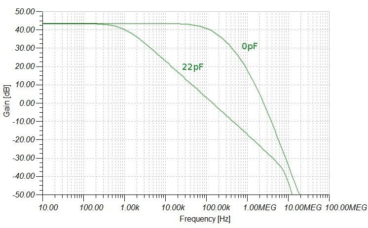

The capacitor I've placed at C1 works as an integrator, though in this case I've taken it to the gate drive rather than just
place it from base to collector on the input transistor (T3). It then includes all the active transistors in the loop other
than the MOSFET. These next two plots show the situation for magnitude and phase response with no capacitor and a 22pF
capacitor.
Looking at the magnitude plot first, it's evident that the slope with the 22pF is now much shallower as it comes down. That's
because it's dominated by the effect of the integrator capacitor where the response changes at 20dB per decade (6db/octave). A
name for this kind of compensation is "dominant pole". That's because the additional pole introduced by the capacitor has been
positioned low down in frequency, far below those coming from the intrinsic capacitances of the transistors, and so it then
dominates the response and removes the gain before we get up to the area where that cluster of awkward poles will give us
problems. If we move to the phase plot, we can see the advantageous effect of using an integrator. When the phase moves away
from the 180 value that we get at low frequencies, it shifts by 90 degrees and then sits there over a considerable range of
frequencies (that's what an integrator does - think of it as integrating a sinewave giving you a cosine). That's good because
it keeps the phase well away from the 0 degree line and gives close to 90 degrees of phase margin (the margin is the
difference between 0 degrees and the curve value at any frequency where the gain is more than 0dB). We can also see that it
doesn't fall to 0 degrees [the point where you WILL get oscillation IF there's the gain to support it] until the curve is up
to around 7MHz. At that frequency, the gain has fallen much further and is around -35dB, so that gives us a good gain margin.
Both values are very safe and ensure that, whatever we throw at it, it isn't going to spontaneously break into oscillation.

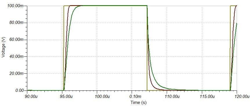

Dynamic Response
One factor that we need to keep in mind with this focus on stability is that there are other considerations. If I do a
transient plot for 11pF and 22pF, both of which are stable in the simulator (the simulator shows we only need greater than
3pF), then we get this. The red trace is the output with 11pF, the green trace is the output with 22pF, and the amber trace is
the input signal which the output is trying to follow. For a large signal step, the compensation affects the dynamic response.
The 11pF looks like it's critically damped, the 22pF is slower and slightly over-damped.

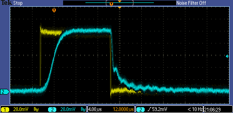

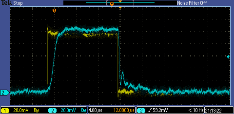

That all looks nice and clean in the simulator. On the bench it's much more messy. Here's the trace for 11pF
And here's the trace for 22pF
They are both much less well behaved. It's also noticeable that the behaviour as we come down towards 0A on the output is far
less assured than the step up to 1A.

the load. One is that I'm looking at small-signal stability - how the loop behaves for a very small signal - mainly because
that's the way the simulator calculates the response. But there is also the large signal response to consider. A disadvantage
of the integrator approach to compensation is that it takes time to charge and discharge the capacitor and that then places a
limit on the rate at which the output will move (the slew rate). You might think that there's also the gate-resistor/gate-
drain-capacitance of the MOSFET to consider, but the low-pass filter that that gives us is higher up than the 22pF
compensation roll-off so doesn't really play a part (I was a little surprised by that because I initially assumed it would
play a factorr and complicate things). The other problem that became evident in the course of doing all this is that the
compensation behaves differently at different input levels. If all the elements of the open loop were linear (which is what
texts seem to mostly presume) there wouldn't be any difference, but they aren't totally linear and that's particularly the
case with the MOSFET when we are down around the threshold voltage. That's enough of a problem that I've been toying with
ideas of biasing the MOSFET with a standing current (however that might be done) so that it never actually has to totally turn
off to get a zero current in the load output circuit loop. I also need to identify what it is that the inductance is
interacting with (the peakiness in the magnitude curve points to resonance between the inductance and a capacitor - presumably
the intrinsic drain capacitance of the MOSFET, though I'm not entirely sure because there are other possibilities). If I
understood that better it might point to other approaches to the problem (such as trying to hide the capacitance from the
inductance).
