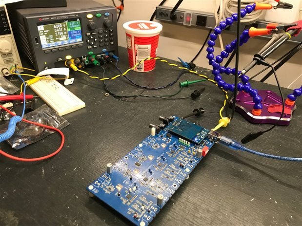

I'm currently working on bringing up a board for a piece of hardware I've been working on for a little over a year. You can read more about the history of the project on my project website if you're interested. This post is a work in progress; I hope to update it as I progress to a complete, fully functioning board.
This particular batch of PCBs is the second revision for this project, so hopefully I've managed to correct all the glaring errors from the first revision without making any new ones!
I started by making a detailed plan for the bring-up order, with the codec power supplies first, then the difficult-to-solder QFN codecs, then the rest of the board components. Things went extremely well for the first step of the plan, which may be some sort of record. I had very little trouble mounting the two LDOs and their support passives, and both supplies were easily verified.

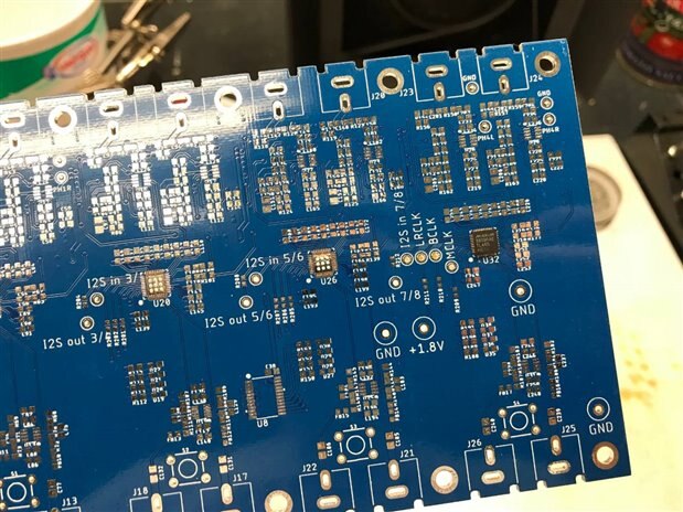

Next up, the itsy-bitsy QFN-package codecs. What could possibly go wrong? A lot, it turns out. First, I applied too much heat to the PCB attempting to prep the exposed ground pad in the center, peeling up a signal trace from the analog input section. I started over with a fresh PCB (AllPCB's minimum order is five pieces, and they frequently send more than that; I got seven pieces with this order), and this time I went straight to working on installing a codec. I used lots of flux, but I also attempted to fasten just two pins of the codec before going to work on the exposed pad. Unfortunately, this resulted in the part sliding slightly off-center.
After chatting with the senior engineer at work, I started again a third time, with a new strategy. Per his suggestion, I applied solder to the exposed pad on the part then removed it with solder wick to prepare the pad. I then soldered all the outer pins using my 70W Weller iron, a magnifier, and a lot of patience. I inspected the joints using a USB microscope, and re-worked the pins that needed attention. Afterwards, I tried applying solder to the back side of the PCB to fasten the exposed pad, but my first attempt appears to have been unsuccessful; I installed the bias and reference capacitors and applied power, but the part doesn't power up. It's sinking about 25uA of current from the +3.3V rail, but nothing from the +1.8V rail. My plan for the next step is to take the board in to work and try to attach the exposed pad with the Metcal iron I have there.
Update #1 (November 9, 2018)
I spent some time with the senior engineer today working on the third board; he showed me some techniques to use to hand-solder QFNs effectively, using the codec already on the third board as a teaching example. The codec still doesn't power up properly, but it's now sinking a lot more current (starts around 500uV, then slowly sinks down to about 270uV as though capacitors are charging) from the 3.3V rail. I still see nothing from the 1.8V rail, and the dev kit I have that goes with the codecs can't connect to the codec.
Next, I'm going to try attaching a codec to a fresh board using the new techniques I learned today. The senior engineer suggested removing any pads for pins that are floating (there are thirteen in this configuration, due to unused features of the codec) with an Xacto knife to make sure they don't peel up and create shorts due to excess heat; I may also try this bit of surgery beforehand to improve my chances of success.

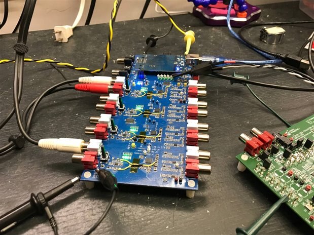

I've installed and verified the output stages. The frequency response is mostly flat (within +/-0.1 dB) in-band, and the matching between channels is pretty good. The gains are reasonably close to the designed value (13.2 dB.)
The next step will be to install the line-level input conditioning stages and verify them.
Update #10 (February 16, 2019)
I've installed and verified the line-level input stages, but not without a little excitement. During an earlier round of component mounting, I installed AC coupling capacitors at the inputs of the codecs, because I was already installing the various decoupling and biasing capacitors. Unfortunately, I goofed and used an outdated version of the values, so I had to pull up the previously installed AC coupling caps and replace them. I was using a large soldering tip with copper braid, and a couple pads at the inputs to the fourth codec stuck to the capacitors and tore up. After some careful x-acto knife scraping and a bit of surgery with some 28ga wire, I managed to re-build the connections, but it's definitely aggravating to have to do it in the first place. Lesson learned: When desoldering, go slow, and use a smaller iron tip with pads that connect to tiny (in this case 7mil) traces. The measured frequency response of all channels has the expected shape, and the matching between channels is again quite good. The designed passband gain was -15.4 dB; actual values are about 0.2 dB below this.
The typical analog input gain of the codec parts I am using (MAX98090) is 2.2 dB to 2.4 dB, with a signal inversion. Combined with the inversion of the line input stages, the total analog pathway gain is about -15.65 dB + 2.3 dB + 13.1 dB = -0.25 dB. Not quite unity, but pretty close. Next up is the last big analog section, the RIAA phono preamps. This board is getting very close to being completely populated!
Update #11 (February 22, 2019)
I've installed and verified the RIAA phono preamps, and luckily, the process was pretty straightforward. Channel matching is surprisingly good, with the deviation between channels at low frequencies maxing out at about 0.2 dB. The designed gain was 29.8 dB @ 1 kHz, actual gain is 29.4 dB to 29.5 dB @ 1 kHz.
Next up are the components to connect to the USBStreamer that provides the USB to I2C interface.
Update #12 (February 24, 2019)
I've installed all of the support components for the USBStreamer; everything is working as expected. With basically all of the hardware installed on the board, this is also the first opportunity to get an idea of the overall current draw, presently about 430 mA. I'll be able to get a better idea of the draw over the range of operating conditions once I've finished the firmware. I've also attached all the RCA jacks and channel switches.

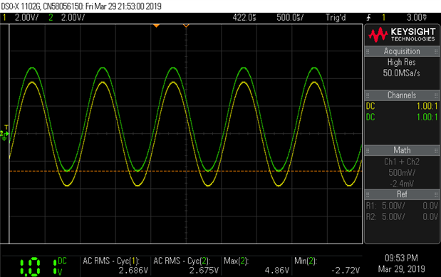

I've managed to write firmware that handles all the basic tasks needed. Unfortunately, while I was testing the firmware I stumbled across a really big mistake I made during the design phase, one that I hadn't caught with any of my previous unit tests. This was pretty frustrating, as I thought that I was working on the final step with the firmware. I spent a couple days thinking about various solutions to the problem; I've settled on two that I think are the most reasonable given the constraints (I don't want to re-spin the PCB and pay for a whole new set of components, I want the most robust fix possible, and I want the fix to be easy and minimally invasive.)
The next step is obviously to fix the big problem I uncovered. I still have a few tests to run on one of my possible solutions; I'll include more details about the problem and the potential solutions in the next update.
Update #14 (March 31, 2019)
I've implemented and tested a solution to the big problem I encountered while working on the firmware. The outputs of the interface were originally badly distorted at full scale; examining a sine wave output on my scope showed an asymmetrically clipped waveform (yellow trace.) Probing inside the output capacitor (green trace) confirmed what I had feared as soon as I saw the high-side clipping: I had forgotten to address the output bias of the codecs before connecting to the output amplifier stages during design! The codec outputs operate from a 3.3V rail, and have a bias point of about 1.25V. The codec output with bias was being amplified into the positive supply rail.
After thinking about the problem for a little while, I decided that there were really only two choices: 1. Insert an AC coupling capacitor into each signal line between the codec and the output stage, and 2. Do something else. The traces from the codecs to the output stages are only 7 mil and there are no components inline, so inserting an AC coupling cap would involve surgery on tiny traces and soldering on scraped-off tiny traces; not exactly an appealing proposition. Duly motivated, I began searching for alternate solutions. After playing around with various ideas for a bit, I decided to address the problem by moving the bias point for the shunt resistor in the feedback network of the non-inverting op-amp output stage. It was attached to ground in the original design; the math showed that moving it to the codec reference would reduce the output bias to about the reference voltage. Not ideal, but better than nothing. (For more details about the math and a circuit design that completely eliminates DC bias at the output, see this blog post.) I made some forked wire assemblies from 28ga wire and soldered them between each codec's reference capacitor and the bottom of the shunt resistor. The results were slightly better than expected; most channels had an offset of about 1V after the modification, and seemed to be well within the linear range of the amplifier. The modification had the unsurprising added benefit of reducing power consumption by about 20mA, a welcome development.
