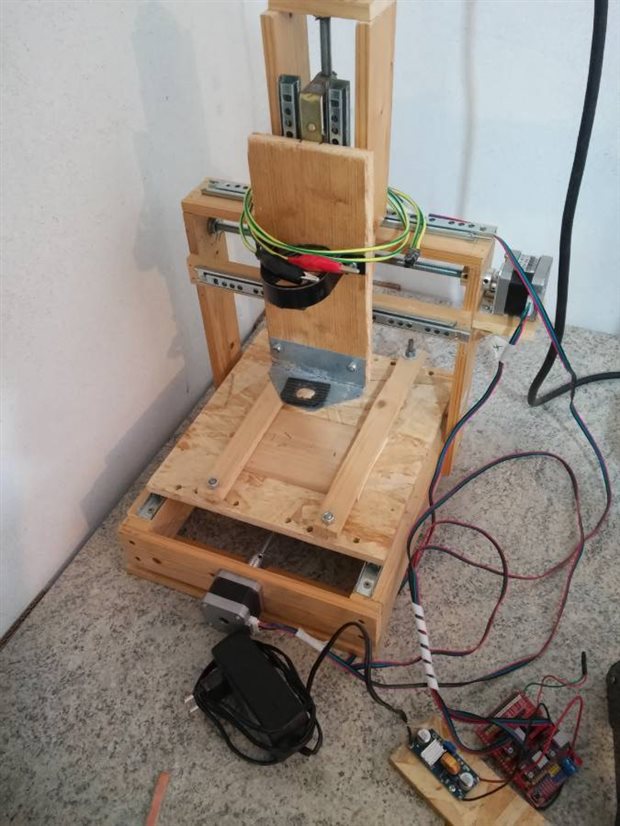

Arduino has a current limit of about 20mA for each pin, so it can not power up a motor directly, hence I designed a small board to drive the motor. The board is very simple, and to make all even easier I decided to start with a small motor from a CD player and only 3.3V as power supply (so I didn't need to bootstrap the signal for the upper portion of the board and arduino can read it). The result was this:
Since a while ago I made a cnc engraver (with you guessed it, an arduino), I decided to make the board with this machine to test it, after a couple attempts I managed to get my board....
....and then I soldered all the components.
