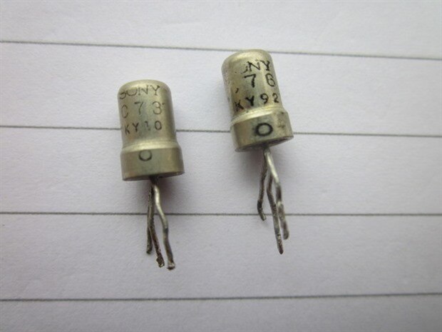

    Good idea. I've just done the same and found these from an old board which must date from the sixties.
    They both still work (a third one doesn't) - one has a gain of about 30 and the other about 50. They're both NPN.
    The only information I can find on-line says that they are germanium. It looks like that's right - the base-emitter voltage
    using the meter's diode test is 490mV in one case and 530mV in the other, which is lower than you'd see with a silicon device.
    When I have the time, I'll try them with the Fuzz Face circuit and see what they do. If they work ok, I'll post them to Andy and
    he can try them in one of his boards.

    jc2048 over 9 years ago in reply to jc2048
    The germanium transistors seem to work ok. Here are the waveforms. The yellow trace is the input - that's just a 200Hz sinewave coming from a waveform generator. I'm then feeding it through a 4k7 resistor to simulate the winding resistance of the pickup coil before the 2.2uF capacitor. The blue trace is the output. I didn't bother with the 500k level control at the output, so that is the level at maximum. I increased the size of the 330R resistor to 2.2k because the signal level was so low.
    Here's what the same circuit does with 2N3904 transistors. [Note that the vertical scales are different.] These are silcon, with a reasonable fT, though the gain is middling (about 220, or something like that). This is back with the 330R.
    This time there's enough gain to precision clip. The 1k adjustment pot changes the slope of the edges (which affects the high frequency content).
