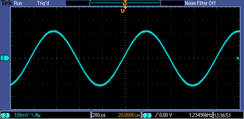

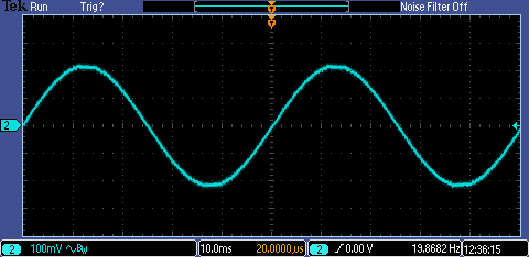

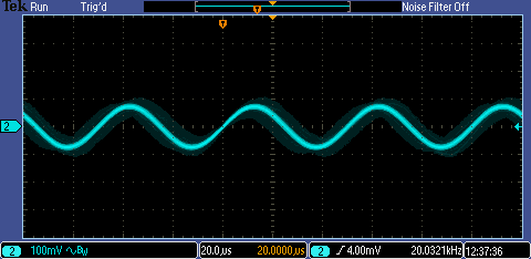

Here are the results for the following SCPI messages
:SOUR:FREQ 20Hz
:SOUR:FREQ 1234Hz
:SOUR:FREQ 2e4Hz
The frequencies are fairly accurate, being within a few Hertz of those requested.
This is the line that does the real work (line 158)
    tableStep = (unsigned int)(65536.0 * output_numeric.value / 100000.0);
it takes the frequency from the parser (a float in Hertz) and calculates the table step necessary to generate it. The 100k is the sample rate, the 65536 is the number of intervals one complete cycle is divided into.
There are a couple of issues I've identified from doing this:
1/ The amplitude dimishes at high frequencies. That means that either I've got my filter values wrong or that the variable gain section is a mess. To look at that I'm going to go back to my test code and rework it to do a frequency sweep - then I'll be able to see directly the frequency response on the 'scope. It also looks like there might be other problems with the 20kHz one.

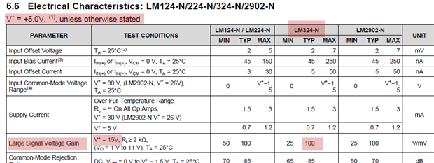

    The TI datasheet is interesting.
    The table for +5V supply implies that the dc gain is 100dB but the simulation model shows that it isn't by a wide margin. They've carefully annotated the gain as being for a test voltage of +15V, so strictly the datasheet is true, but I'd say it's a bit sneaky. Caveat emptor! as the old Roman analogue design engineers used to say.
