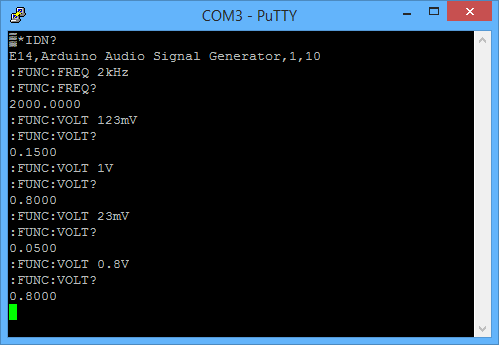

Here it is working with PuTTY:
The output level is in volts and is constrained to the range 50mV to 800mV in steps of 50mV. That's the peak-to-peak voltage; here's what 2kHz and 800mV looks like on the 'scope:
The firmware will take the next highest level - you can see that in the line where I try to set it to 23mV and it returns 50mV for the current level.

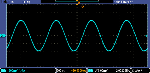

a) Power rails - using the +5V rail from the Arduino Uno leaves the resulting waveforms somewhat noisy.
b) There is some frequency variation evident on the higher frequency waveforms. I haven't investigated further, but it probably means either that there's something with a higher priority than the timer 2 interrupt or something is disabling all interrupts for short periods.
