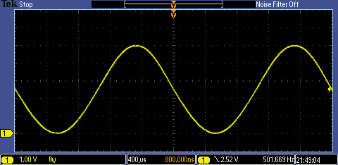

I was going to do some hardware next but got sidetracked into playing with software instead.
Here's a very well-known waveform being produced by the simple resistor-ladder DAC I built in part one.

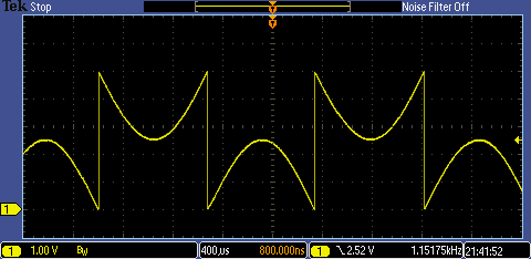

and here's what it looked like before I got the arithmetic right
That's generated by this sketch

The sine is done with a look-up table rather than the floating point library in order to save space and because it's much faster. I generated the table (only the first quadrant, to save space) using the following simple C program. That was compiled in Visual C++ on a PC and run simply by double-clicking on the filename (the text file ends up in the same directory and it's quicker than typing into a console window). Then I simply open it with Notepad and copy and paste it into the Arduino sketch. Probably not a very elegant approach, but it works.

    Now I'm thinking - what kind of circuit would produce this concave square wave...... It might be one example where performing a Fourier transform would provide insight into the answer.

    What I wrote there was quite wrong; I should think BEFORE I post
    things, not afterwards. It's not a multiplication and all my talk of
    modulation is way off the mark.
    It's simply the addition of a sine wave and a 180 degree out of
    phase square wave.
    Here's a circuit that will generate the waveform (given the
    square wave and the sine wave in the appropriate form). It's simply
    an op-amp summing circuit.
    Here are the waveforms:
    Now I have it in the simulator, it's easy to look at the spectrum.
    It's still the spectrum of a square wave but with the fundamental
    depressed (that comes from the sine wave partially cancelling the
    fundamental of the square wave).
