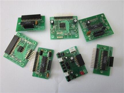

I became disillusioned when I realised that all I would be doing was screwing mechanical parts together and plugging in already fully populated PCBs, some of which carried pre-programmed microprocessors: I had assumed more involvement.

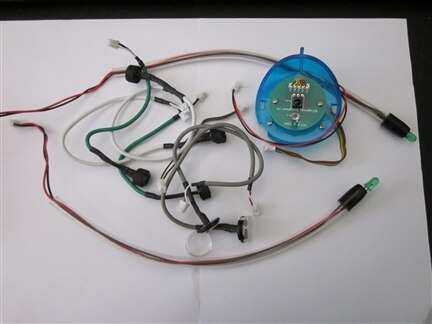

By the time I cancelled my subscription I had a 3 wheeled base driven by 2 independent DC motors, with a line follower module,
and a collection of sensors and circuit boards. These were all packed away when I moved house 10 years ago and only unpacked recently when I did some work with lego and a stepper motor and remembered poor old Cybot.
There a few websites devoted to Cybot and one in particular: http://lpilsley.co.uk/cybot/index.htm,  is very useful. The site includes functional descriptions of the circuit boards and some reverse engineered circuit diagrams.

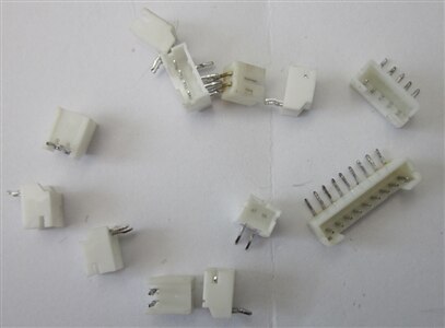

Bearing in mind the relative antiquity of anything designed and built around 15 years ago, I decided to keep the sensors (for now) and scrap all the circuit boards, pausing only to carefully unsolder the small, white 2, 3 and 4 pin connectors, which mate with plugs on the sensor leads.
These connectors have proved difficult to identify - I did eventually track them down as XH250 series which are, annoyingly, 2.50 mm pitch! The 2 pin connectors will fit 2.54 mm pitch holes, anything more than 2 pins varies from a struggle to totally impossible. I wouldn't choose to use them. If anyone is interested, the connectors can be found here: http://www.toby.co.uk/content/catalogue/products.aspx?series=XH250-xx-H  and a similar connector is available 2.54 mm pitch

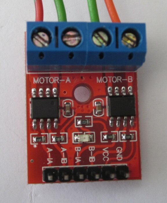

My first requirement for the rejuvenation process was a motor drive board:
I tested the motors on  6 V and they draw about 250 mA, well within the capabilities of the L9110  H-Bridge chip - 800 mA continuous.
I sourced this board, which carries two L9110 chips, from eBay, for a very modest sum. It can drive 2 DC motors or 1 stepper motor.
The motors leads were terminated with the 2 pin connectors mentioned earlier. Rather than clip them off, I made up some extension leads, using the salvaged connectors from the scrapped circuit boards:
The other ends of the extensions then connect directly into the screw terminal outputs of the L9110 board.

The bananarobotics link includes a truth table for the L9110 and an Arduino sketch to control a single motor. I tried the sketch and was pleased to see that it worked precisely as expected. However, the way in which the variables were defined was a little cumbersome for my own coding style, so I modified all of that and then created a set of functions to replace the original in-line code.
Everything still worked fine, but there was still a bit of potential confusion because,  although the sketch uses 2 PWM capable digital pins - 10 and 11, only pin 10 is actually used in PWM mode,  whilst 11  - the "direction" pin - is either high or low. This results in a need to fiddle with the PWM duty cycle between forward and reverse to get the same speed. The following code segment (using my version) should make this clear:

I then got into a bit of trouble when I modified the sketch to control 2 motors - I assigned pins 8 and 9 for the second motor, keeping things in order. I didn't remember that pin 8 is NOT PWM, so it didn't work properly. I had to switch 8 and 9 around. I got there in the end!
I then took a detailed look at the sketch provided by Bajdi. This uses all the pins in PWM mode and presents a very straightforward view of the speed issue. I preferred the Bananarobotics menu driven approach so I changed the pin assignments and the detail of the functions in my own sketch to use those from Bajdi's example:

    Hi tasi I would love to help you but although I still have the line-follower module ,I haven't tried to use it with an Arduino yet.
    However, if you look here:  http://lpilsley.co.uk/cybot/follower.htm
    You will find a schematic of the Cybot line follower module - IR LEDs and Photo Diodes - and an explanation of how they should work.
    Hope this helps - when I get round to using it with my Arduino, I will certainly post my results. Please post yours if you get it working.

    I'm doing a similar project , and still could not get to work the line follower sensor. Got any tips ?
    I try to test first one pair and work, when i do the something in other pair don't work.
    The test i made, first plug in the yellow line to 5V of arduino, the black line to ground and the blue line to analog pin A0, and made the sketch that just show if detect the line. This work fine, but when i tried make the same but just with orange line, that show always detect the line. And when i plug in the 2 lines (blue and orange) don't work anything.
    When i make the test just with the orange line, i see on arduino the TX and RX led always on.
    Thank you for your help
