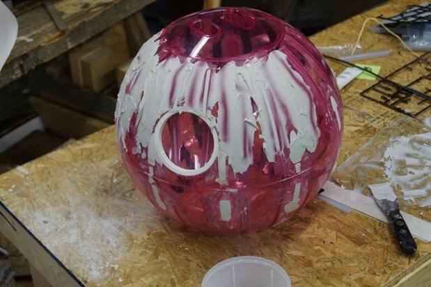

First things first, we did not want to purchase pre-made props, because frankly, there is no fun in that! We  found the dimensions of  a hamster ball and an acrylic display case to be perfect for encasing all the necessary hardware.
The first order of business was attacking  the Lifeless Sphere prop. We used a hole saw to cut the "crater". We adjusted the size to approximate scale. We then reversed the cut out, added a 1/4" pvc spacer, and epoxied it in place. Next, we convered  all the vent holes from the inside with tape. This then allowed us to Bondo the crap out of this thing. Seriously, that's a lot of Bondo. After a few applications and some sanding, a touch up, more sanding, etc,  you get the idea. We used high fill primer to mask any imperfections.
Next, we built the light unit. We used a fiber optic lamp similar to this one (http://tinypic.com/r/250ox9d/5), then 3D- printed- a smaller base (pretty cool,huh?) and built a driver board with RGB LEDs (the stock lights were blue). Then came the task of drilling all the holes and routing fibers in bundles through the holes. Before installing the filaments we finished the paint job. Fun fact: The stenciled shapes are waste ribbon from a circuit board pick and place machine. We originally made the mistake of using hot glue to secure the bundles in place. This caused the filaments to melt, diffusing the light and just generally not working properly. We then used two part plastic epoxy with great results. Finally, an Arduino with a custom- built  LED control board was installed,  finishing the Lifeless Sphere.

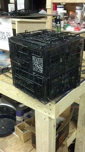

We tackeled the siOrg³ a little differently. We started with pillaging the junk pile for scrap computer boards and some not- so- scrap boards (sorry Andy). We layered the boards as well as many, many scrap Tinyduinos (thanks to Ken at TinyCircuits)  inside of the cube. We then sourced modelers flash aka "trees" to build up the outside. Everything was spritzed with just enough black paint to allow the cube to be translucent. RGB LEDs were installed inside and outside the cube. We did end up having to internally brace the cube, formally an acrylic display case, as its one origninal purpose was to keep dust off of prized sports memorabilia. The cube was then driven by a similar Arduino and LED control board combo designed by our very own Torrie Fischer

The siOrg³ being assimilated.
