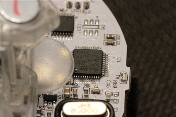

BB8 has two different kinds of LEDs. The first is the simple single color LED, this one is blue (something like this) on the board as D1, controlled by the STM32 Cortex-M4 (STM32F373) on pin 45.
I don’t work for this toy’s creator (Sphero) so I don’t know what code they use to control the LED. However, the STM32 processor has example code (via the STM32Cube for F3). The sample code initializes the hardware abstraction layer, configures the system clock, enables the GPIO clock, configures the GPIO as output and finally toggles the LED. For our GPIO, the last step would look like

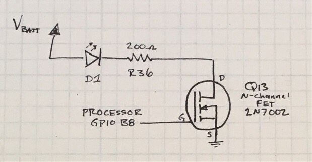

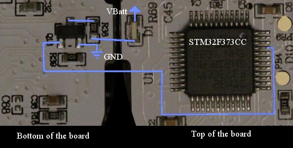

Ignoring the setup code, this is pretty straightforward.  Looking at the hardware, using my voltmeter in resistance mode to beep out the signals (that is obviously the technical term), I can see the connection is not quite as simple as the LED connected to the processor.
The GPIO B8 processor pin is connected to a FET (Q13), which acts like a switch. When the processor outputs high, the LED gets access to VBatt. Exceeding the 3.3V of the processor, VBatt is the sum of the two LiPos, about 8V depending on charge level. The FET also provides as much current as the LED can use (though it does have a 200 ohm current-limiting resistor so the LED doesn’t explode).
If you prefer schematic form, the LED circuit looks like this:

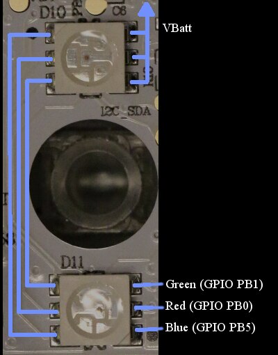

BB8 also has RGB LEDs, a synchronized pair. Ohm’ing the signals out showed them to be directly electrically connected.
Note that the RGB signals do not go directly to the processor pins indicated, instead they go through current-limiting resistors and FETs, just as the blue LED did above.
RGB LEDs are neat because you can simulate nearly any color. Want yellow? Turn on green and red. Want orange? Turn on red and half of green. The mixing makes them powerful. But getting “half of green” means we can’t control them as simple on-off outputs any longer, we have to move to something that lets us choose how much of each color to mix. (Cree, maker of many RGB LEDs, has an extensive Application Note on color mixing to help you figure out what colors, though Wikipedia’s web colors page is a more pragmatic start.)
