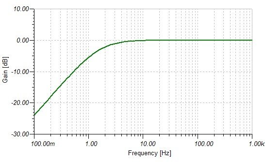

Isn't the input capacitor a little on the small side?
The input capacitor is a coupling capacitor. It is there to pass the signal whilst blocking DC - you can have different
voltage levels on either side, but the AC signal passes through the capacitor. If you look at a book that teaches Hi-Fi
preamp design, you'll generally see a capacitor of 10uF or so in this position at the input of a preamplifier in order to pass the lower
frequencies and to ensure a response all the way down to 20Hz. To see what's happening, let's first simulate a much
simpler circuit - a coupling capacitor and a load resistor.
Here's the Hi-Fi case, with a 10uF capacitor and a 10k load resistor. The response is quite flat by the time we get to
20Hz:
Now I'm going to drop the capacitor to the value in the Power Boost, 220nF. As you can see, the response isn't flat now
until we reach several hundred hertz:
And finally I'm going to increase the load resistor value to 150k and see what happens:
It should be evident that the response depends on both the capacitor and the resistance (which is really the input
impedance of the amplifier - it doesn't have to be a simple resistor, though it often is in a Hi-Fi system where it's
common to find a 10k volume control immediately following the input capacitor). Together they form a high-pass filter.
If we increase the input impedance, we can decrease the capacitor value and leave the response the same. And that's
what's happening here. The amplifier has a much higher input impedance than the line-in on an amplifier would have, so
the capacitor can be smaller. It's evident that the designers weren't so fussy as hi-fi designers - the response only
just manages 20Hz, and might not manage that given the large tolerance on capacitor values - but for a guitar effects
unit they didn't need to be perfectionist about it.

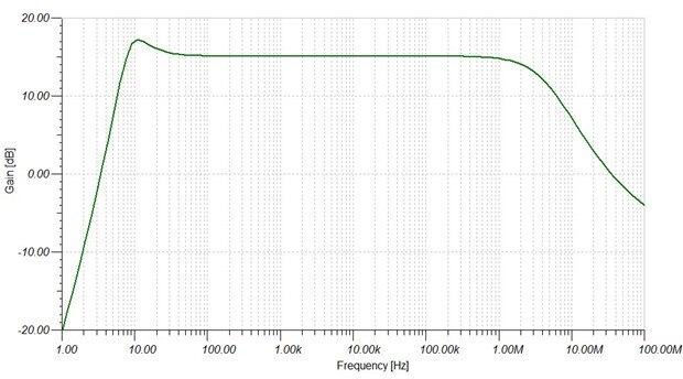

What is the role of capacitor C12?
To see what the capacitor does, let's first look at the frequency response of the amplifier without the capacitor being
present. This is the frequency response as far as the output of C5; I haven't included the tone control stage.
What's immediately apparent is how impressive the amplifier is. It doesn't start to roll off until it gets to 2 or 3MHz,
there is gain there [0dB is a gain of 1] up to about 25MHz, and the gain is nice and flat in the passband. All that from
two simple transistors.
