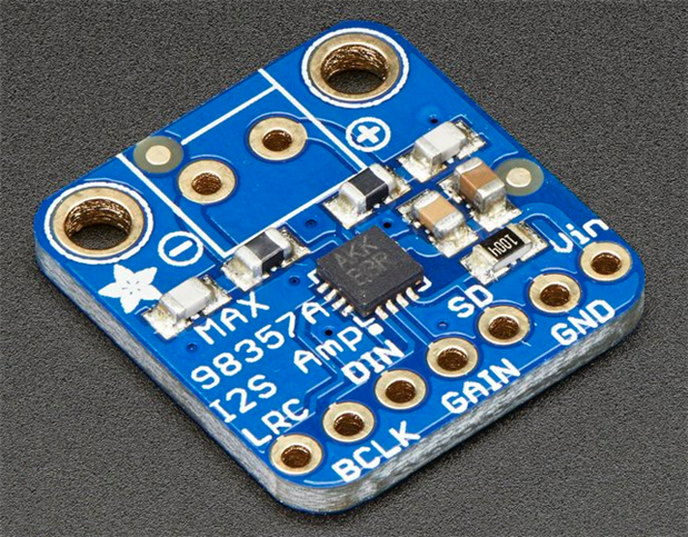

I2S (Inter-IC Sound) is a stereo audio protocol that uses three pins - One clock signal, one Left/Right "word select" indication signal, and one data pin. There are I2S microchips that can function as DAC (Digital to Analog converter) to generate analog signals and push to an external amplifier. I later found the MAX98357A chip which functions as both the I2S DAC and also a 3 watt amplifier. It can be had on Adafruit (GreatScott used a version from SparkFun) with a pre-made breakout board for $5.95 USD.
Bingo - this was the key. image
Putting it together
I went a few rounds looking at different I2S DACs  & amplifiers, plus combo units like MAX98357A before setting. My concern was how loud it would actually be since I did want the ability to be LOUD if I needed it (like when linking to my smoke detectors). I saw a lot of amps in the 3 watt range but didn't have the confidence until I tore apart an old boombox from the 90's to find a very similar 3W amplifier (although a large DIP8 with much more thermal controls). That at least gave me confidence in the achievable volume levels.
For the speaker, I decided on a 3" unit that matched the 4 Ohm, 3 Watt rating of the MAX98357A chip; again I picked these up from Adafruit.

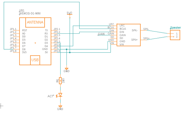

The schematic
There really isn't too much going on with the schematic. Just a few wires to connect the D1 Mini to the I2S board; plus an LED. The Amplifier board has a way to select different gains for the amplifier, so I put down solder pads and a few passives. The entire unit is powered from USB into the D1 Mini.
Main schematic above. Solder jumpers for gain selection shown below.

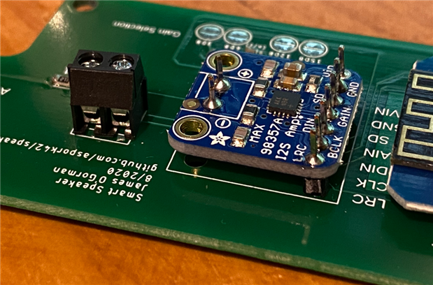

I have made exactly two PCBs before; both for the PiChef challenge; and I've been itching to do it again. This time around I used the version of Eagle built into Fusion 360 and was able to get it all laid out. I did a few things I had wanted to do way back but with the time pressures of the PiChef challenge I wasn't able. They aren't complicated, but each was just 'one more thing' on the list to learn and do. These included proper custom components - not just sticking a header into my schematic and calling it something; but actually creating a custom library & custom component. I was able to add the MAX98357A as a custom component complete with layout, package, footprint (I did skip the 3D package though of this part). This let me drop it into my design and I can wire it in the schematic, and when doing the board layout it will have the plated through-holes for the pins correct plus the other non-plated holes for mounting. Pin names would also become silkscreened onto the board. This was a "lesson learned" from Pi Chef - label all your pins (if you have room). It makes trouble shooting so much easier.image
I also spent a lot of time doing some generative design on the shape of the PCB. During the PiChef challenge, my boards were exactly the default size in Eagle. It wasn't immediately obvious to me how to change them and I literally didn't have time to look it up; so they just came out that size. This time around, I was able to make some nice rounded corners, carefully place mounting holes; and move things to fit properly. One other thing I did this time that I didn't during PiChef was to have my 'complete enclosure' modeled in Fusion. With PiChef, I just assumed that everything would have room; but really it was too tight. This time, I spent a few rounds playing with the board shape in Fusion360 to get it to fit properly inside the round enclosure. I pushed the LED out farther (custom board shape; and I also created a custom library component for a 'bent pins' through-hole LED) and I pushed the D1 Mini out the opposite side so the USB connector was as close to the outside as possible.
Another thing I tried out here was doing a solder mask cutout. I noticed how close the USB connector sits to the carrier board I was creating, so I decided that I can flow some solder on to an exposed ground plane and use it to mechanically (and electronically) connect the Micro USB port to the board and it should be pretty strong. This /mostly/ worked out, but was a pain to solder with just an old-school iron; and on one of the boards, some solder got inside the USB port and almost rendered it unusable.
One design note - when I mounted the I2S component - Adafruit ships it with screw terminals for the speaker. I chose to /not/ mount that on their board, but rather just use pin headers and solder down to the carrier PCB. The screw terminals I moved a little bit farther away. The reason for this was to provide mechanical stability since I would have otherwise needed to use stand-offs to hold that portion of the board up. I did also make a "rev2" of this PCB that uses through-hole resistors instead of 0805 surface-mount because some people I was talking to about the project aren't set up to do surface mount work.

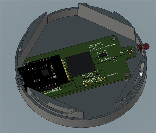

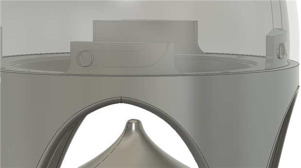

I spent some (actually a lot) of time doing the enclosure. It proved pretty tricky to get a clean design look, simple construction, and 3D Printable. I ended up with a 3-part design - bottom, center, and top that make up the device.
The bottom piece holds the PCB, and has cutouts for the LED and USB cable.
The center piece is where the speaker mounts to, facing down into a cone to disperse the sound 360°. There is a hole running through the center section to route the speaker wire through cleanly.
The top piece is just a cap to cover the back of the speaker.
All three pieces use a twist-lock that I designed. One part has a small 'nub' that sticks out, and the other side has a track that it slides into. As you twist the two pieces, the nub slips over a slight bump in the track and locks into position. This turned out very well, but took a few tries to get it right. I ran into an issue with a test print where I used layer heights of 0.32 mm and the parts didn't fit as well as an earlier print. The other print had a layer height of 0.20 mm. The difference in height was too great for the tolerance of the parts I was building. I used a 5mm tall channel with a 4.85mm circular nub to ride through it. The dims are all shown in the image gallery below. The most difficult part was finding the best way to 'wrap' the shape into my curved surface. A simple extrude was crude and sort of worked. But I later found that I could use the "Emboss" to get the 2D sketch properly projected & cut into the model.
The final result turned out really good. It has a nice, solid feel. Good construction with a solid 'click' to lock/unlock the components.

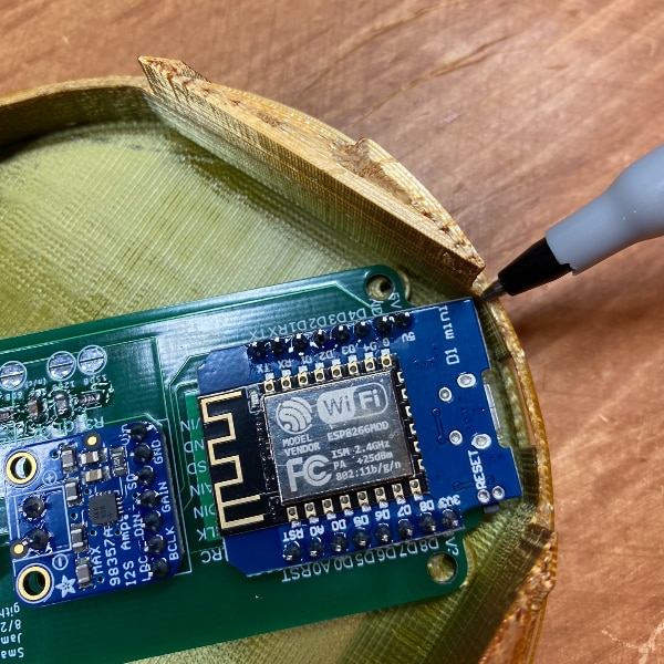

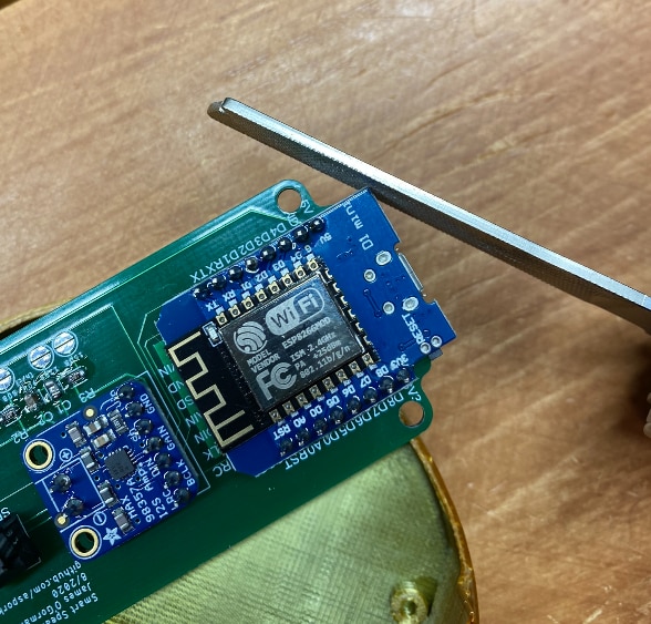

Here is some of the 'test' pieces that I did to get it dialed in...
{gallery} Enclosure
Doesn't fit!: I had to massage this corner of the D1 Mini to get it to fit properly...
IMAGE TITLE: ...using a file... image

IMAGE TITLE: Dims showing how the channel was cut out. The hump at the bottom is 0.5mm tall and provided just the right amount to securely lock the two sections together.
IMAGE TITLE: This is the size and position of the nub
