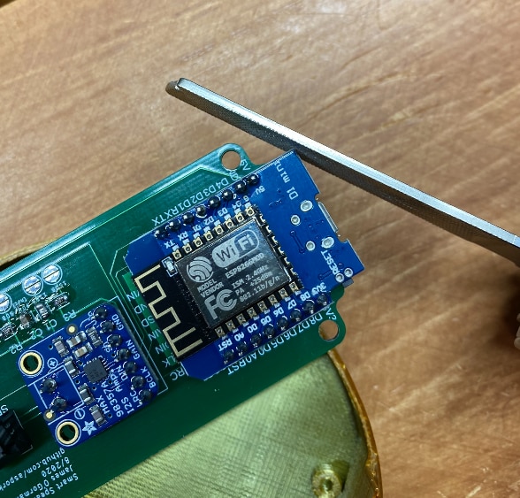

I was able to bench test this pretty well with a breadboard and I initially was using an older Huzzah board since that was all I had around while I waited on the D1 Minis to arrive. The setup was precarious with the breadboard, jumper wires and all just flying around in the breeze.

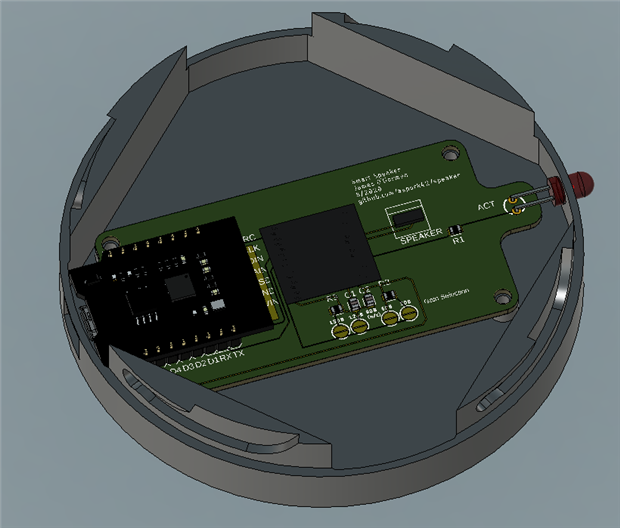

I spent some (actually a lot) of time doing the enclosure. It proved pretty tricky to get a clean design look, simple construction, and 3D Printable. I ended up with a 3-part design - bottom, center, and top that make up the device.
The bottom piece holds the PCB, and has cutouts for the LED and USB cable.

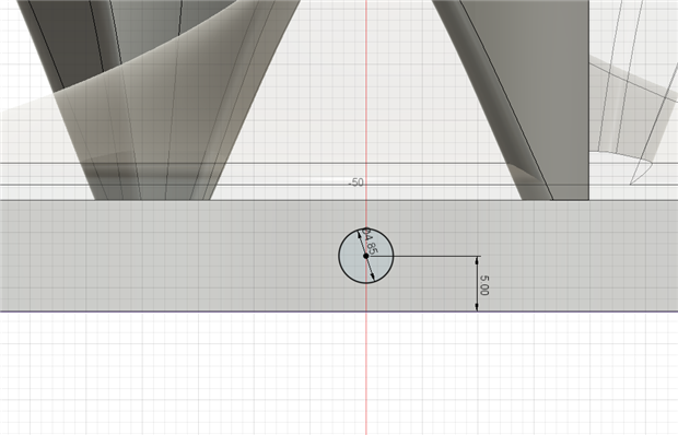

All three pieces use a twist-lock that I designed. One part has a small 'nub' that sticks out, and the other side has a track that it slides into. As you twist the two pieces, the nub slips over a slight bump in the track and locks into position. This turned out very well, but took a few tries to get it right. I ran into an issue with a test print where I used layer heights of 0.32 mm and the parts didn't fit as well as an earlier print. The other print had a layer height of 0.20 mm. The difference in height was too great for the tolerance of the parts I was building. I used a 5mm tall channel with a 4.85mm circular nub to ride through it. The dims are all shown in the image gallery below. The most difficult part was finding the best way to 'wrap' the shape into my curved surface. A simple extrude was crude and sort of worked. But I later found that I could use the "Emboss" to get the 2D sketch properly projected & cut into the model.

Doesn't fit!: I had to massage this corner of the D1 Mini to get it to fit properly...
IMAGE TITLE: ...using a file... image
IMAGE TITLE: The first unit base is assembled! I have started 3D printing the PCB so I can test fit components (in the top left) before I order the actual PCB.
IMAGE TITLE: All 5 PCBs assembled; and the first one mounted in the enclosure.

IMAGE TITLE: Dims showing how the channel was cut out. The hump at the bottom is 0.5mm tall and provided just the right amount to securely lock the two sections together.
IMAGE TITLE: This is the size and position of the nub
