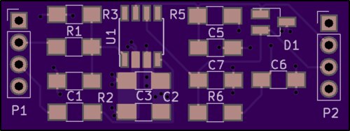

Two Layer PCB
I could have used a single layer PCB but there's no price difference with two layer boards.
The bottom side is dedicated to the power rail and ground. The top for the digital and analog signals.
Let's start with the bottom layer. Because the 3V3 isn't used a lot but crosses the whole board, I decided to route that first.
All the rest of the board area is ground. I added keepout areas on the two trough-hole connectors.
I've used the datasheet of the TCAN332D for the layout guidance.
These are the things I've taken over from the advice:
  • Transient Protection on CANH and CANL: ... These devices must be placed as close to the connector as possible
  • Decoupling Capacitors on VCC: Bypass and bulk capacitors must be placed as close as possible to the supply pins of transceiver
  • Ground and power connections: Use at least two vias for VCC and ground connections of bypass capacitors and protection devices to minimize trace and via inductance
  • Filtering noise on digital inputs and outputs: To filter noise on the digital I/O lines, a capacitor may be used close to the input side of the I/O
I didn't do anything specific for this one:
  • Because ESD and EFT transients have a wide frequency bandwidth from approximately 3 MHz to 3 GHz, high frequency layout techniques must be applied during PCB design.
I tried to keep all signals short and direct and provided a decent plane on the back. Only one signal goes trough a via (unfortunately in the transient protection circuit - maybe the worst one of the whole set?)
Layout
This wasn't a difficult exercise. The whole circuit is symmetrical and the components almost call for a particular position on the board.
You can see on the digital side on the board that there's nothing complex there.
The components on the left are the digital circuitry.
The bulky copper below U1 are the two power planes.
I've provided enough vias to get a good connection with the bottom planes.
The output circuit and protection are also symmetrical.
Here you can see that I used two vias to route the signal between R5 and C6.
Because this is a part of transient protection, it's best to have a short path .
I could have taken the proper time to rethink the position of a few components.
Putting D1 to the left of the output passives would have been one of the options.

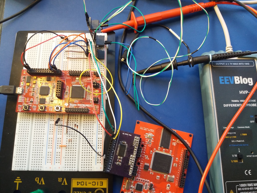

    I'm trying with a different microcontroller, Hercules RM46
    I should check my dev board stash, but I don't think I have non-Hercules CAN capable controllers ....
    Jan Cumps over 8 years ago in reply to Jan Cumps
    No joy at the moment. I have working firmware that exchanges data between two CAN peripherals. But my physical layer design with two CAN drivers does not work.
    Once I plugg them in, the microcontroller's CAN module stops working correctly.
    I've probed extensively but haven't find the root cause (or even a hint of a possible reason).
    It could be that both CAN driver ICs are destroyed by me while soldering, but that would be exceptional. In particular because these are automotive grade.
    Debugging is not easy when something "does not work at all". Anyways, back to the lab ...
