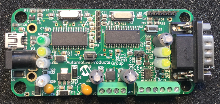

The Microchip CAN Bus AnalyzerMicrochip CAN Bus Analyzer supports both logic and physical side of the design.
You can plug it directly into a vehicle and check the traffic. There's an MCP2551 CAN driver on board.
It also allows you to check on the digital level (don't exceed 5 V) - valuable for firmware designers that don't need a CAN text fixture.
I've used that in all previous posts in this series.

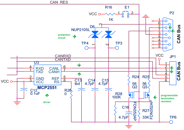

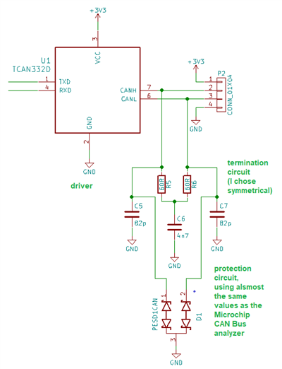

The CAN analyzer implements a protection circuit similar to what I did on the CAN breakout boards.
I use a different CAN driver, TI TCAND332D, but my circuit is virtually identical:
You can either use the DB9 connector or the screw terminal block to connect GND, CAN H and CAN L between the test circuit and the analyzer.

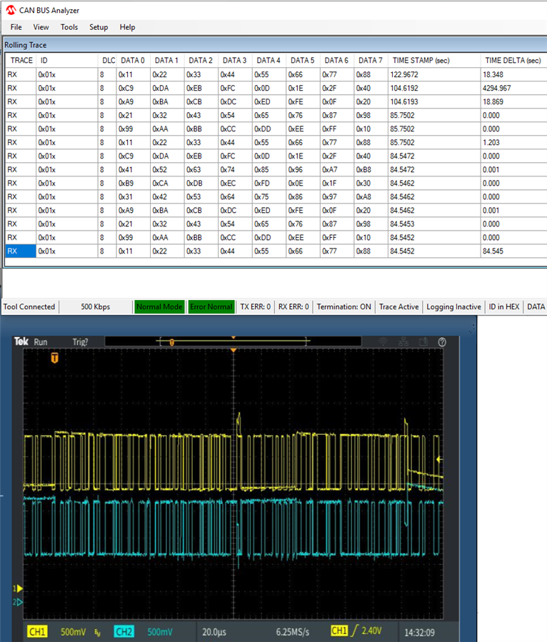

It's also interesting to attach an oscilloscope. Both H and L signals are referenced to ground, so you can put one channel to the H signal and the other to the L.
You'll see that both are positive signals, but inverted, around a midpoint that - in my case, is 1.85 V (see capture below)
The H signal will move between that midpoint and 2.8 V, the L between the midpoint and 0.9 V. So both have an amplitude of 0.95 V.
But they are opposite (differential) around that point.
The Microchip CAN Bus analyzer behaves exactly the same when probing the digital or physical layer.
That's of course a good thing. The protocol is identical on both sides.

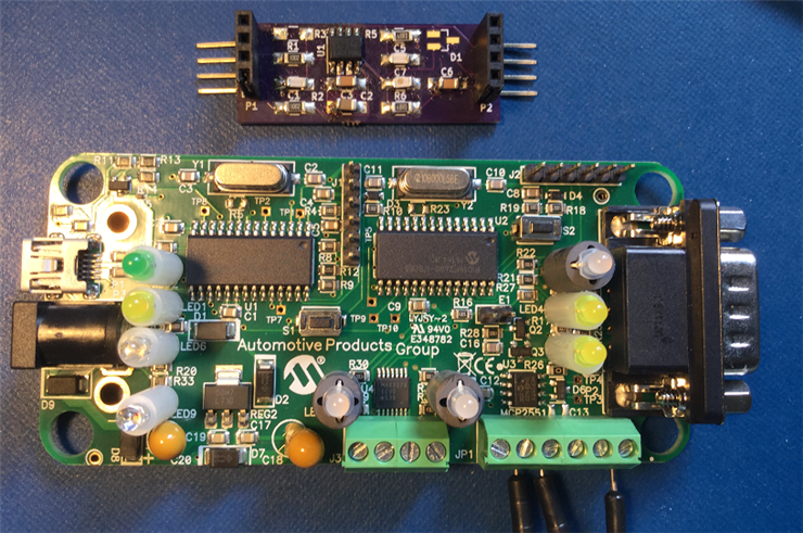

    I've set up a test bed to try out the Arduino MKR CAN shield I got from e14.
    On the breadbord, you see the Arduino CAN setup in front. Behind that, the 2 CAN driver boards I made for this road test, driven by a TI Hercules microcontroller.
    The black box behind the breadboard is the Microchip CAN bus analyser. The scope in the back shows the CAN bus' Hi and Lo differential signals.
    On the laptop I'm running the software for the Microchip analyser. It shows latest message (top window) and a rolling log of every message discovered (bottom window).
    The current setup only sends messages that are intended for the Hercules.
    Next steps are to create a CAN mailbox for the Arduino, try to make it retrieve those messages, then make it send messages to the other 2 CAN points ...
