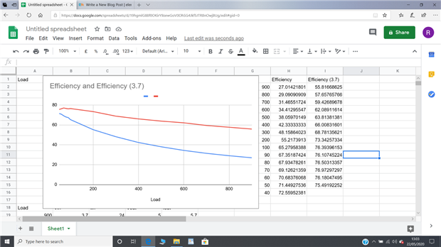

As there was no information that I could find on this module I decided to measure it's characteristics myself. So I used a bench power supply as the input and to measure the input voltage, a multimeter to measure the input current, another multimeter to measure the output current and the seven segment display to measure the output voltage. I only have two multimeters and the seven segment display seemed to be quite accurate which is why I used it. For the load I used a low cost resistor box. I have looked inside this resistor box and it uses surface mount resistors which is fine for the higher resistances but for the smaller values say under 50 Ohms I am a bit dubious about their ability to dissipate the heat without melting the solder and falling off so I have limited my measurements. Plus the multimeters only have current ranges up to 200 mA so any values larger than that I cannot measure anyway. I'm not really interested in trivial output currents so selected a maximum resistance load of 900 Ohms, down to 30 or 40 Ohms.
There are two parameters I am interesting in, the stability of the output voltage and the efficiency of the module. I have not shown the output voltage here but it never changed from the set value during all the measurements so either it is very good or I just happened to select the output voltage (5.0V)  that works really well. The efficiency is calculated in Google Sheets using power out divided by power in. For all these measurements I maintained the seven segment display to be on which obviously consumes some current. I did not have any direct method of measuring the LED currents but measured the input current with the LEDs ON, measured it again with them OFF, calculated the number of segments on and divided that into the current difference. For an output of 5.0V there are seventeen segments on.
Segment current = (Input current LEDS on - Input current LEDs off) / Number of segments on
and this provides a individual segment current of 0.6 mA.
Efficiency = (Vout * Iout)/(Vin * Iin) * 100%
For low output currents the efficiency will appear much lower as the seven segment display is consuming power.
I took two series of measurements, one with an input voltage of 5.0V and the second with an input voltage of 3.7V, both with an output voltage of 5.0V.
I am aware from the little knowledge that I have that this type of DC-DC convertor has a better efficiency the harder it is worked, which is illustrated by these graphs. The maximum efficiency of 71-72% is achieved at the highest output current (120 mA) that I could measure (40 Ohms). The efficiency is much lower at the lower output currents (900 Ohms load  giving 5.7 mA output current).
For comparison I have subtracteded the seven segment display current from the input current just for the input voltage of 3.7V (the red trace) and the efficiency at lower output currents is much improved, as would be expected.
I had been hoping for a higher efficiency than was achieved but this module does it's job and it looks like it will be useful for me on my mobile robots. The next step will be to try it out with a real LiPo battery and real solar cells.
