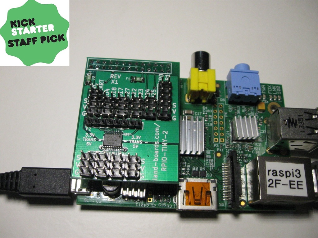

I have a Configurable 5V I/O card for the Raspberry Pi on Kickstarter.
photo-1024x768.jpg?1418517849
Features
  • All Raspberry Pi I/O lines
  • 8-bit bidirectional 3.3V to 5V level translator
  • Fuses on 3.3V and 5V power lines
All of the Raspberry Pi I/O connections are brought to GVS connectors. This is:
  • (8) GPIO lines on GVS connectors
  • (2) SPI interfaces (can be configured as 5 GPIO lines)
  • (1) UART interface (can be configured as 2 GPIO lines)
  • (1) I2C interface(can be configured as 2 GPIO lines)
Level translators
The board uses an 8-bit wide Texas Instrument TXS0108 voltage translator to convert up to 8 of the 3.3V I/O lines to 5V I/O levels.
Fuses
  • The board has Resettable fuses on the 3.3V and 5V from the Raspberry Pi.
  • These fuses protect your Raspberry Pi from overloads.
  • These fuses are 1/2 Amp PTC fuses.
  • PTC fuses have certain advantages (they are self healing) and disadvantages (they are not like a wire fuse which acts like a switch).
  • If you trust your wiring you may choose to solder a wire over the fuse.
    • Care should be taken when doing so.

    Clem,
    My main plan is to help other people hook up 5V parts to their Raspberry Pi, I designed the card because there are a lot of posts out there with people who want to hook up five volt parts to their Raspberry Pi and the typical response is "just hook up some voltage translators", etc. Plus, I really liked GVS shields for the Arduino since they bring along power and ground with every signal line. They make it easy to hook up external parts. So I put the best of both worlds into this card.
    Doug

    You may wish to reference viewers here to this
    http://land-boards.com/blwiki/index.php?title=RPIO-TINY-2
    The silk-screening doesn't give all the labels for the pins.
    I would strongly suggest you use a slightly higher connector to clear the RPi hardware.
    Many of the other boards that were snug fit, are only useable on the version they were designed for, rather than universal, and that becomes annoying. image
    It looks like your funding goal is met, so they should be around.
