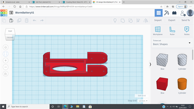

The Battery Chassis
The motor chassis is illustrated below and is essential a lever with a pivot point at the top, a cut out for the battery holder and a hole for the wheel axle.

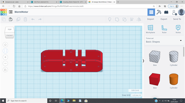

The Motor Chassis
The motor chassis is illustrated below and is another lever with a matching pivot point, slots to enable the DC motor and gearbox unit to just slot in and holes for the axles for the second pair of wheels. This is not a particularly good design as the tall thin parts have a tendency to break off. However, the motor is held in place with bolts so that problem did not affect the functionality.

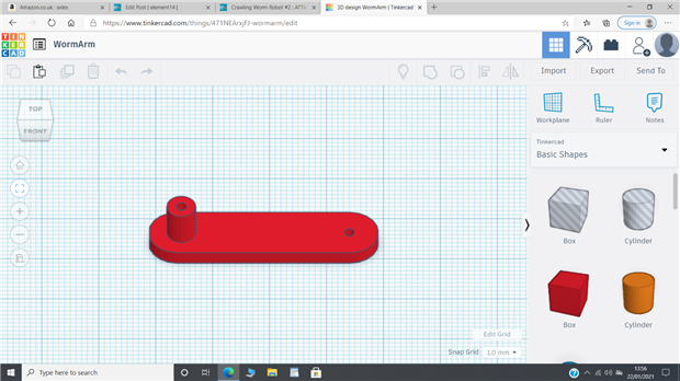

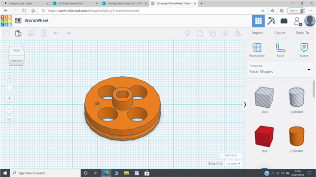

CAM Mechanism
The cam mechanism consists of two parts; a wheel with a centre axle point to fit onto the motor axles with an offset pivot point, and the straight pivot arm, both illustrated below.
