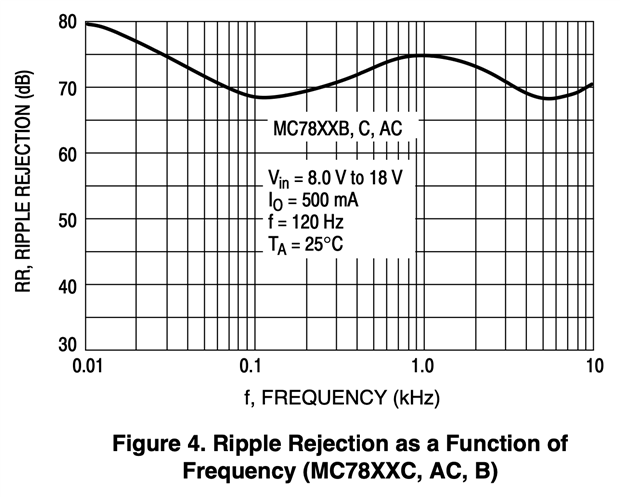

  • +5V for the majority of ICs on the board.  I've actually chosen here a SMD version of a stalwart LM7805 as it has a low noise output; I do have a high-efficiency 5V DC/DC regulator (same model range as the 12V one) but it has up to 75mV ripple on the output.  Again, I've provided a bypass diode for protection.
  • -5V for the Op Amps to alleviate any issues with signals close to 0V.  This is charge pump that inverts the +5V rail.
I also chose to insert a schottky diode to block any reverse voltage that may arise if things go catastrophically wrong with any attached instrument (I would expect that to have its own additional protection.)  I can't place this on the 5V rail because of the voltage drop so those elements would valiantly lay down their lives!  The DC/DC Isolator allows me to provide power across the isolation barrier from a single power source and mitigates the need for two power cables into any case, or for an attached MCU to be powered from an external source.  The capacitors on the output have been chosen based on some measurements I made when it was on a breadboard so may change when I test on a PCB.  In fact, any output noise doesn't seem to impact the operation of components on the isolated side.

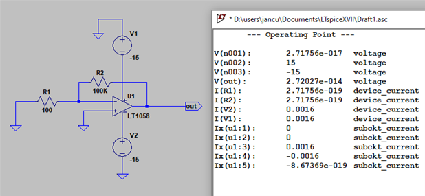

    I'll elaborate a little on the firmware / software. I'm still drooling over your hardware approach - so well designed. The eload has a core API. Representing all functions of a programmable load. I also…

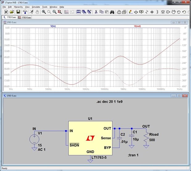

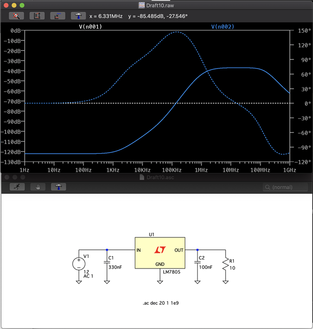

    I've only just noticed this thread - nice ideas.
    For analogue stuff Ilike real filters with big inductors and caps.
    On a recent design I did this:
    L2 and L3 are 680uH 200mA (ish) Farnell 2374105 (Bourns SRR0735-681M).
    C90 and C91 are 100uF 10V AL polymer (Farnell 2614080).
    The filter might ring with switch on and off tranients so the zeners are cheap insurance.
    You can damp the filter with some series R abut you get more voltage drop.

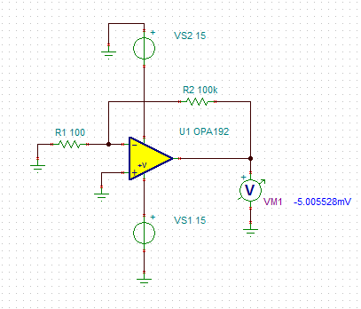

    I have some thoughts about SCPI  which I might share later - but they aren't going to affect your hardware.
    Not quite sure about your offset stuff, R10 doesn't do anything (except increase noise) - try simulating it if you don't believe me.
    Your really need to limit the bandiwdth of the offset injection - a passive RC filter on the amplifier output(s)  would help.

    Thanks Michael, that's useful: U20, U21 and U22 look like LM* and the TPS is a charge pump so not that dissimilar to what I'm doing.  Those Zeners are 5V?

    When I simulate with the OpAmp I used for the compensation test (LT1058), I get this in LT Spice:

    Interestingly I have tried simulating it when Jan was setting it up and I couldn't get the circuit to work properly as the Op Amp seemed to be 'ideal', thus it had no offset that I could inject an adjustment for.
    Are you sure? I've got the TI SPICE model for the OPA192 imported into Tina-TI and if I set up a virtual test of the offset it does this,
    so they've got an input voltage offset of 5uV on it. Unfortunately it isn't a parameter, like it is in some models, so it's not possible to start varying it [unless you can do it by changing the macro, but I don't know enough SPICE to do that].
    I tried to replicate this. Downloaded the TI reference design for OPA192 , opened it in ti-tina and copied the OPA192 to a fresh window.
    Then wired up and get a different result. Did you change attributes?
    I used DC Analysis, Single mode, Calculate nodal voltages ...
