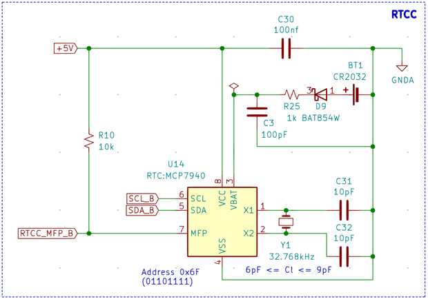

Real Time Clock Module
I thought it would be useful to provide some clock functionality, perhaps for timing of measurements.  It would seem that keeping track at a resolution better than 1 second is quite expensive and given that the time has to be retrieved over I2C not sure that's worth it.  So, this module will be accurate to 1 second - any further resolution would need to be finagled on the MCU (e.g. by taking a microseconds timestamp before/after the I2C read) and taken as 'reasonably accurate'; it would seem a reasonable trade-off.  This module has a dual alarm function as well, accessed from the MFP, which is routed back through the Digital Isolator to the MCU.  The MFP can be alternatively configured to output a square wave so I'm also routing the output to the Board I/O module in case it is useful.
I'm providing the means for a battery backup so that any configured date/time/calibration data can be stored - this will allow for relative measurements over a number of days for example or even just to keep a date/time on display on the MCU.

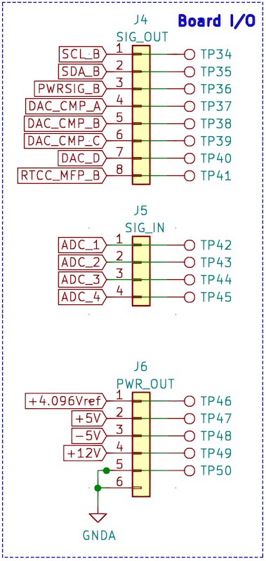

Board I/O Module
Not really a module, just a set of headers that would be used to connect to any instrument.  It's worth mentioning that if I change the ADC inputs to allow for one or more differential inputs, then J5 would change to provide more incoming connections.

    Did you consider a MOSFET for the fan control? The dissipation isn't that high for the darlington, but you've still got to dissipate it in the board with an SMD part. And 12V? That's another source of noise added to that power rail.
    You might consider some resistance between the ADC inputs and the diodes on the ADC Module. It would save the protection in the event that you accidently connected an input to a voltage rail outside of the 0 to 5V. There might be a case for some between the diodes and the op amp, too [on the basis that the internal protection for the inputs might come into effect closer to the rails than the external diodes and end up having to take most of the fault current - I haven't checked the datasheet]. You could always swap the resistors for links if they did have any measurable effect.
    Not very sure about just two GND connections on your connectors shared between so many lines (with some of them power and some digital). I know you don't want loops, but is that really the way to do it? [Genuine question. I don't know enough about this sort of design to say, but having a reference ground sharing with power returns doen't feel like the way to do it to me.]

    "Two ground connections on the connectors" - do you mean in the Board I/O module?  I think I ended up with two because I had a 6-way connector on hand and didn't want to leave one connection floating whereas really that shouldn't have distracted me and this should be a 5-way connection (or 17-way altogether.)  Anyway, that's not the point of your comment so a bit by-the-by: I do think I'd have to be very careful allowing the creation of ground loops and I must have things referenced to one point.  I would envisage one of two things happening at the Board I/O: the ground connection is a star point for the down stream components; or the board I/O connector(s) are removed altogether and the 'control board' circuit incorporated into the wider solution schematic and ground adjusted accordingly.  Ultimately, everything must route back to the source of the relevant power rail, without creating the possibility of ground loops, including the components on the Control board - there lies the danger, I think, in providing multiple routes back for those components.
    Did I misunderstand your comment?  I'm happy to explore this further as, frankly, ground seems easy to get wrong and hard to get right!  I've had trouble in the past - one such example: I just couldn't get a voltage/current/power sense IC working properly because I had it connected to a different ground reference point than the Arduino 'talking' to it.  Ultimately, they both routed to the same ground but clearly there was an issue there in how I'd connected them both to that point.

    I found an interesting note here (Analog Design paper on Linear Design), jc2048 (Jon):
    There are a number of important points to be considered when making signal and power connections. First of all a connector is one of the few places in the system where all signal conductors must run in parallel—it is therefore imperative to separate them with ground pins (creating a Faraday shield) to reduce coupling between them.
    Multiple ground pins are important for another reason: they keep down the ground impedance at the junction between the board and the backplane. The contact resistance of a single pin of a PCB connector is quite low (typically on the order of 10 mΩ) when the board is new—as the board gets older the contact resistance is likely to rise, and the board's performance may be compromised. It is therefore well worthwhile to allocate extra PCB connector pins so that there are many ground connections (perhaps 30% to 40% of all the pins on the PCB connector should be ground pins). For similar reasons there should be several pins for each power connection.
    This would seem to back up your comment about 'just two GND connections'.  I'll take the time to read through the paper in more detail.
  • jc2048
    jc2048 over 6 years ago in reply to Andrew J
    My concern was mixing up the zero volt reference with the power return. I hadn't gotten as far as considering crosstalk between the signals.
    Say your ground connection was 10mR [two parallel connections with 10mR at each end] and the supply current stepped by 10mA, that develops a voltage of 100uV between the two sides on the ground [which is supposed to be a fixed, identical reference for both]. That's quite significant if you're trying to digitize in 38uV steps. Of course my 10mA is plucked out of the air, because I don't know what's on the other side, but you've given me the clue there may be some digital stuff there by the SDA and SCL lines. Whatever the actual figure, it's digital noise you'd presumably prefer not to have added to the signals.
    It would seem from the document that you're quoting that an accepted way to deal with that is to minimise the resistance as far as possible through multiple connections. I though there might be a way of separating the power from the signal ground, but there isn't really, is there? If the multiple ground connections aren't more or less equal, everything then takes the easy, lowest resistance path [at low frequencies].
