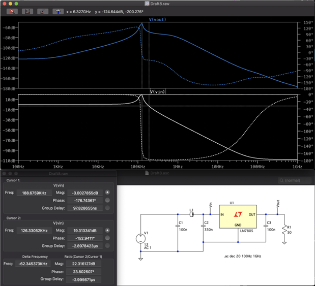

    shabaz over 6 years ago
    Hi Andrew,
    Awesome project.
    I've not looked at it all, but looking at the power supply portion:
    Personally I wouldn't hang off the switched capacitor supply on the right side, instead (if the chip supports it) it would be better to run it off 12V, so you get a -12V output, and then pass that through a negative voltage regulator. Also, it's worth interconnecting with (say) an 0805 set of pads, so you can isolate them, and also experiment with filtering in-between. Usually I'd automatically insert a ferrite bead if there's a chance of high frequency noise, since I'm not going to get the chance to produce many revisions of boards for a personal prototype, and sometimes even an RC filter can be useful for the lower frequencies (R may need to be quite low). Basically, treat the DC-DC converter, and the switched cap converters, as outputs that will almost always need some cleaning.
    Here's an example, this isn't a negative supply rail though:
    You can see the ferrite separation. Next, in my case there is an RC filter hanging off the supply rail to the chip that ultimately needed the supply (the +3V3 is actually the same as the 3V3_ISO rail from above, just a name change because it went through a connector), it could be argued I should have placed this between the DC-DC converter and the TPS chip shown above, that would have been another option:
    It is possible to later just use zero-ohm links and retest if there was a need for BoM reduction (maybe for home projects there's no need for that), so I feel it could be better to just initially assume it's needed if at the prototyping stage.
  • Andrew J
    Andrew J over 6 years ago in reply to shabaz
    Thanks Shabaz - I feel this is a lot more achievable with what I know than the PSU I built!  Having said that, dealing with noise is extremely frustrating.  It seems that any article, paper, blog I read I understand but their examples always work out to reasonable values and mine (i.e. real world) never do!  And on that basis, it seems people choose component values for the filters based on experience and screw the maths!!  You wouldn't believe it if I said I'd put in, taken out, put back in, taken out placeholders for beads, resistors and capacitors.  Out in the end because I couldn't get any reasonable output from LTSpice models, for example any RC filter I created the voltage drop was just too much or the capacitor value seemed ridiculously high.  Except for the LPF between the OpAmp and ADC input which I left in with starting values.
    I know the above image isn't what I'm doing but how did you arrive at the values for the caps, and ferrite bead?  It's my own project and I'm not overly bothered by the BOM (otherwise I wouldn't be prototyping with variants of £15+VAT ADCs image ) and a few ferrite beads won't make much difference to the cost.  And the only reason I ask is because I have literally spent days and days investigating and I'm still scratching my head!
    Just to make sure I understand what you are saying in respect to the switched capacitor: use the 12V supply to the MC7805 to get a +5V rail and use the 12V supply to the LM2776 (or alternate that takes 12V) to get a -12V then its output to, say, a MC7905 to get a regulated -5V rail?
    shabaz over 6 years ago in reply to Andrew J
    Hi Andrew,
    TC7662 might be suitable, it works to 18V. (I edited that afterwards to the end of the previous post so you probably didn't see it in time).

    Hi Shabaz,
    I've looked at this again - still going around in circles a bit - but I've tried to simulate something in LTSpice and came up with this:
    This has a 12V input with 1VAC.  The -3dB cut off is at 188.67kHz and there is a resonant gain at 126.33kHz - the switching capacitor inverter you mentioned, TC7662, switches at a frequency of 10kHz so I believe that shouldn't be impacted.  I tried different capacitor values and it made a bit of a difference but essentially, the same.
    I also tried this with a LM7812 model with 15V input with 1VAC - I'm not showing cursors here:
    IIRC you aren't that familiar with LTSpice, but is this the behaviour you might expect to see?  I don't know how accurate the LM* models are as I can't remember where I sourced them.  Perhaps michaelkellett can comment on whether the LTSpice circuit is correct for this analysis?

  • michaelkellett
    michaelkellett over 6 years ago in reply to Andrew J
    Where did you get the LM7805 and 7812 models.
    Can you post the net list from LTSPice for you simulation .
    Thanks.
    MK
  • michaelkellett
    michaelkellett over 6 years ago in reply to michaelkellett
    There is an intersting LT app note:
    https://www.google.com/url?sa=t&rct=j&q=&esrc=s&source=web&cd=&ved=2ahUKEwjeqbrRnt7pAhUTaRUIHYkfA2gQFjAAegQIBRAB&url=htt…
    (AN101 Minimizing Switching Regulator Residue in Linear Regulator Outputs.)
    The article is more interesting than it intends - it includes this graph:
    The same part exists in LTSpice:
    Even to get this result I had to set the ESR of C1 to 0.5R but at 100kHz I have about 10dB better than data sheet ripple rejection.
    The initial conclusion is that modelling linear regulator ripple rejection in LTSpice is not reliable.
    MK

  • Andrew J
    Andrew J over 6 years ago in reply to michaelkellett
    It's easier for me to create a share on One Drive.  I honestly can't remember where I got them from - I'd even forgotten I had them in my library when we last discussed a model for LM7805.  Let me know when you have downloaded them and I'll un-share the link.
    It may not be accurate but I take some comfort in knowing my model looks like the right approach!  I modelled just the LM7805 as you have for the LT and have this:

  • michaelkellett
    I get the same sort of nonsense as you did.
    If I add in various parasitic things like lead inductance and capacitor ESR I can get it to look a bit more sensible but no one specs these things properly.
    This means that one is just guessing:
    ST spec the 7805 with 60dB rejection at 100kHz, my sim with parasitics still gave 70dB.
    MK
  • Andrew J
    Thanks for checking anyway - even if it was garbage out, at least it wasn't garbage in!
