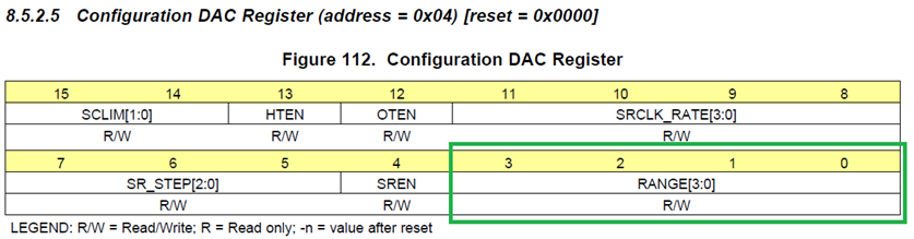

Additional to the traditional voltage mode, this DAC can source current. It has a number of ranges that can be controlled:
In this exercise I'm setting the mode to 0101: 0 - 20 mA.

    TX_Data_Master[0] = 0x04;
    TX_Data_Master[1] = 0x10; // output on, default slew rate
    TX_Data_Master[2] = 0x05; // slew rate off, 0 - 20 mA mode
